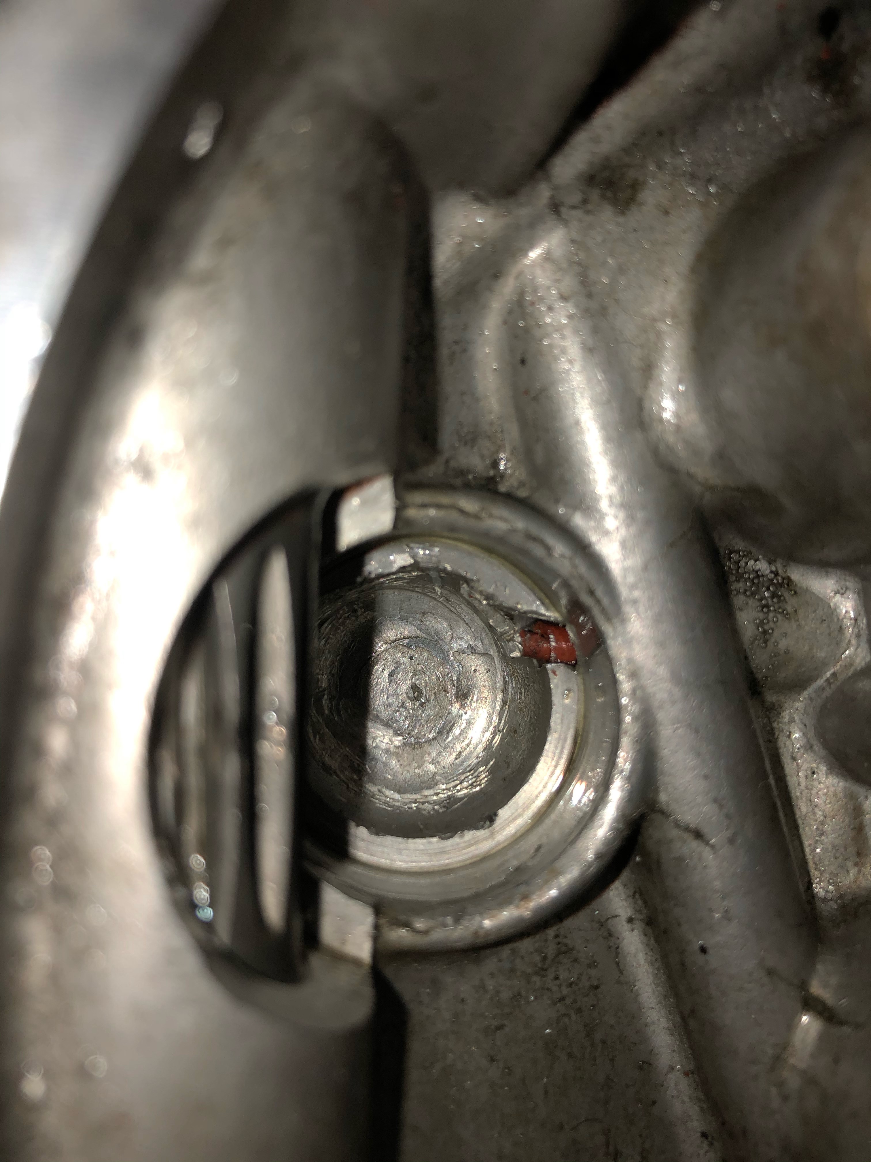

Just share this, good example of doing a job properly! (or not!)
While I have timing cover off (500 AVL) thought I wound change the crank oil seal, it was fine but for a couple of quid might as well.
You couldn't see this blockage as was behind the seal and had I just left the seal I would have left it in situ! This is post me blowing the oilways out with compressed air.
Todays lesson is don't blow shite further into a oilway, blow it from both sides!!!!
