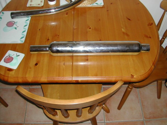

The one that might suit you would be the Watsonian-Squire "sports" silencer made for them by Brituro, who I suspect might no longer be trading.
These were made to fit a 1.75" O/D pipe, but the later Indian 350pre EFI Bullets had their 1.5" pipes flared out to 1.75" at the silencer end. Keep an eye on ebay and our hosts' used parts section. Might actually be worth phoning our hosts as they bought out W-S's spares stock after they relinquished the import business.
These:
I do have one but I'm hanging onto it "just in case".
As far as the Indian short bottles are concerned they're not usually too bad, being (originally) a copy ofd the early 50's Redditch silencer, a nice blatt without being overly loud. Our hosts had one the same style, but at that time most of their own offerings were "straight-through" type with a perfunctory baffle, a bit too much for my ears, really.
