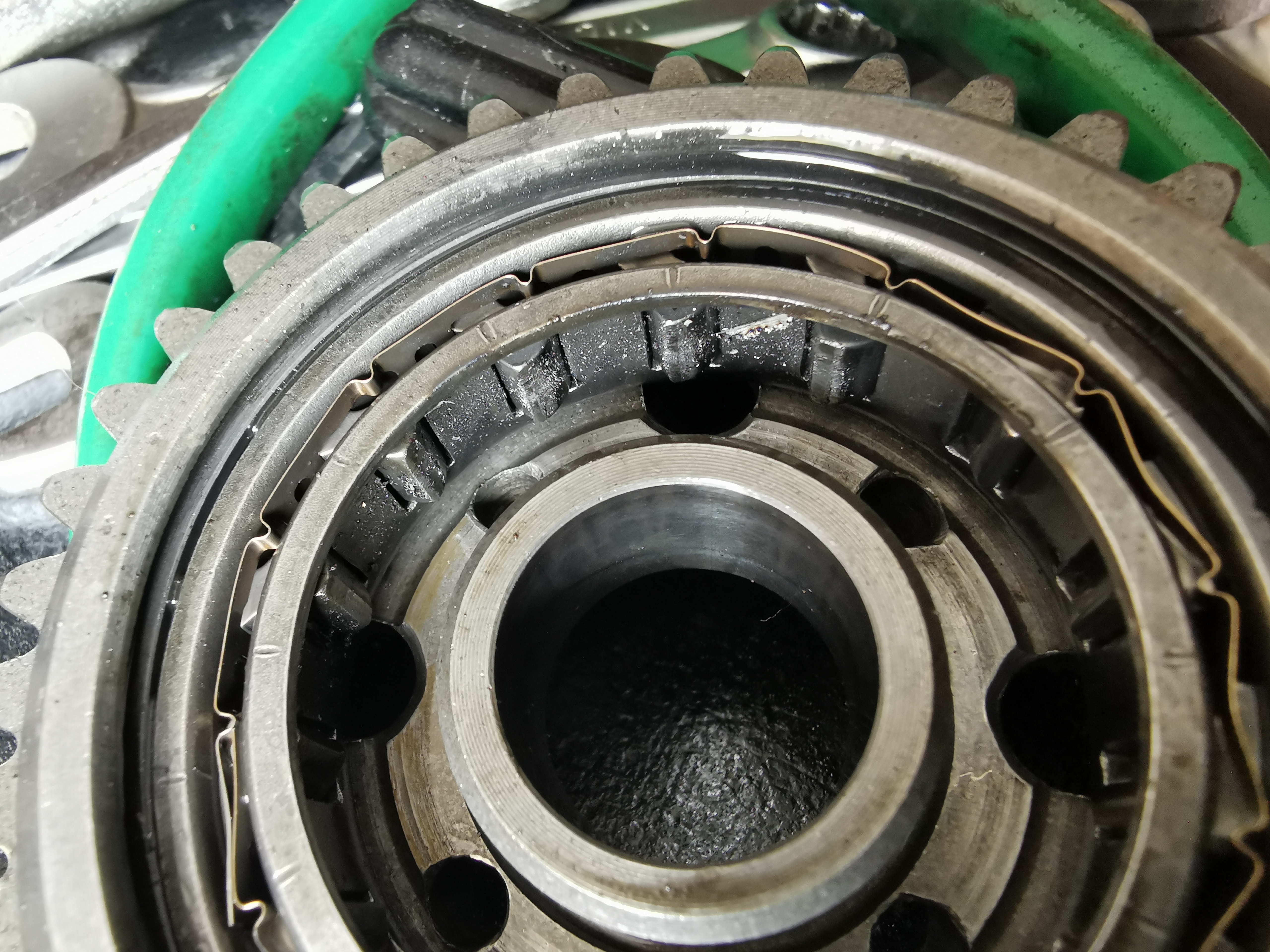

By David Crossley
#91453
ImageThis is the the sprag from my bike shows sign of some ware and was jammed in. Have removed all gears and ordered starter blank.
