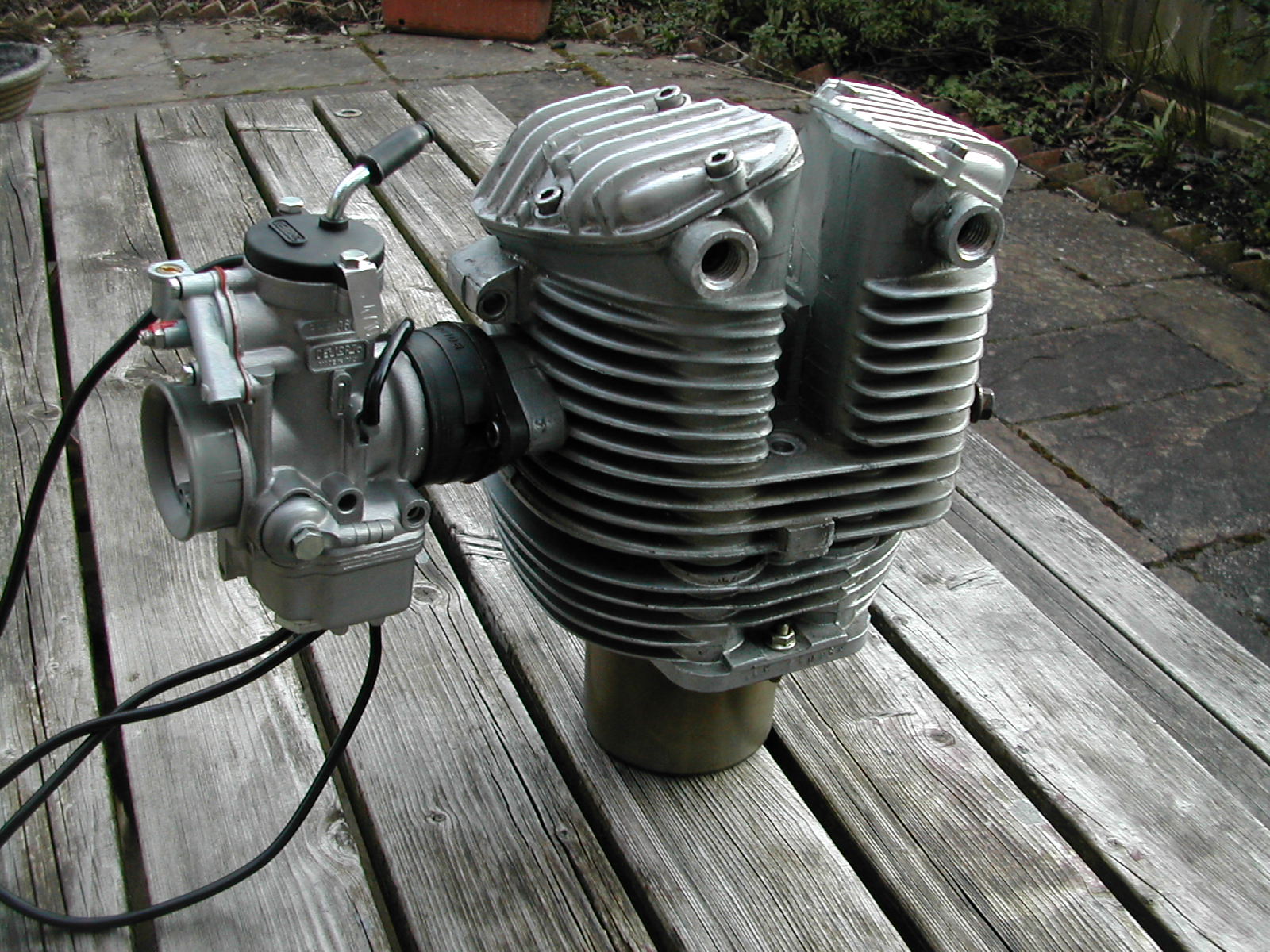

The way I'm thinking is... do a carb conversion, but for simplicity and aesthetics I'd like to fit an Amal Mk1 rather than a Mikuni.
Given my wish to keep things simple and reliable, cost effective, replaceable and self serviceable when on the road can anyone offer reasons why I should persevere with the fuel injection system or why the Mikuni carb would be better for my needs rather than the Amal.

I'm not going to argue in support of keeping your fuel injection, all my REs are pre EFI.
For carburetor choice I'd say the Mikuni is a better carb than the Mk1 Amal Conentric, despite the Amal's more classic looks. I used to have a VM32 Mikuni on a tuned BSA 350 and it was superb, though I no longer have that bike. The Mikuni has a hard chrome slide as standard for long wearing capabilities, the standard Concentric has a zinc alloy throttle slide running in a zinc alloy body (not good) as well as a hard-to-get-at pilot jet. There is a better version of the Concentric called the Premier Version available with a hard anodized throttle slide and proper pilot jet, but I don't know if that is the one which our hosts include in their Amal conversion kits, you'd have to ask them about it. Feel free to ignore me as I'm a Dell'Orto carb fan where Bullets are concerned these days, so what do I know? :mrgreen:

The Amal carb is not half as good as the Mikuni IMHO.

Thank you to all those helping guide my next move. I'm warming to the Mikuni carb option and ice cold about keeping the fuel injection system. I like to play with my bikes, change things around adapt...meddle, thus a carb is the most effective option for me. I've read as much I can find online and taken on board the first hand experience from those on this site and I would clearly be foolish to discount the Mikuni conversion.
For now I'll change a few fuel trims at the lower rpm range to see what happens then remove the PCV to see what the standard bike thinks of my exhaust/air filter set-up so that I have a base-line knowledge for the future...then comes the carb!
I have no prior experience playing with Mikuni carbs so I may need to ask for help but again I see lots of resources online and a carb is just a carb.
I take the point about not getting money back that I spend on a carb but I feel the saving for me will be in peace of mind that I can easily fix whatever fuelling problem that crops up...and I may even sell the PCV to part finance the conversion.

If you're going to go for a carb conversion I would go for either the mikuni or monobloc ,it won't tick over on the side stand with the monobloc but that's about the only downside.
The Mikuni is probably a better carb but in my mind the monobloc looks better and is easier to set up
Good luck whichever way you go
Have fun with it Dai
Edit 389 monobloc will be needed
