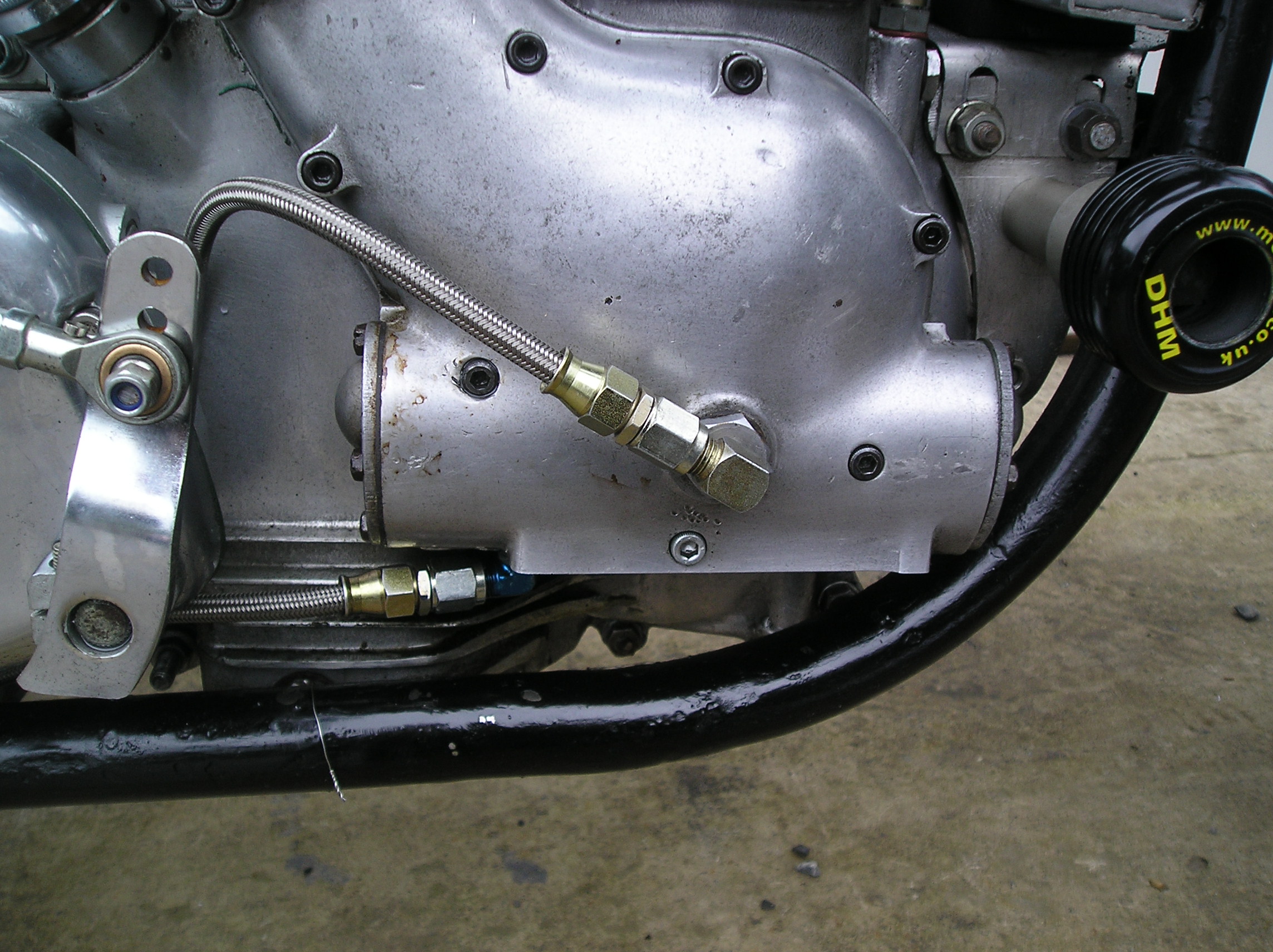

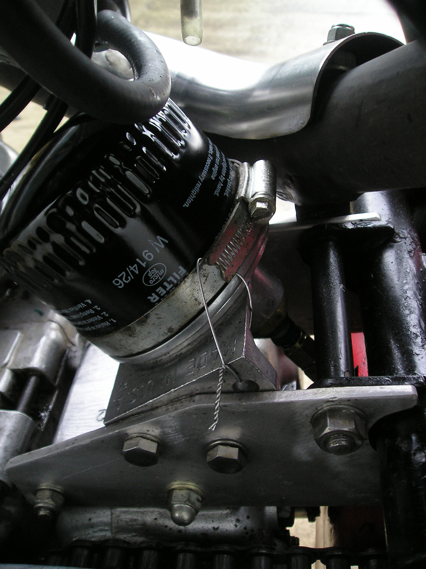

We have a spin on filter on our 500 racer, but this was only done so we could cut off the oil filter chamber from the timing cover so we could place the engine lower in the Featherbed frame. Our 350 racer can hit 9,500 rpm and uses the standard factory filter with no issues.
