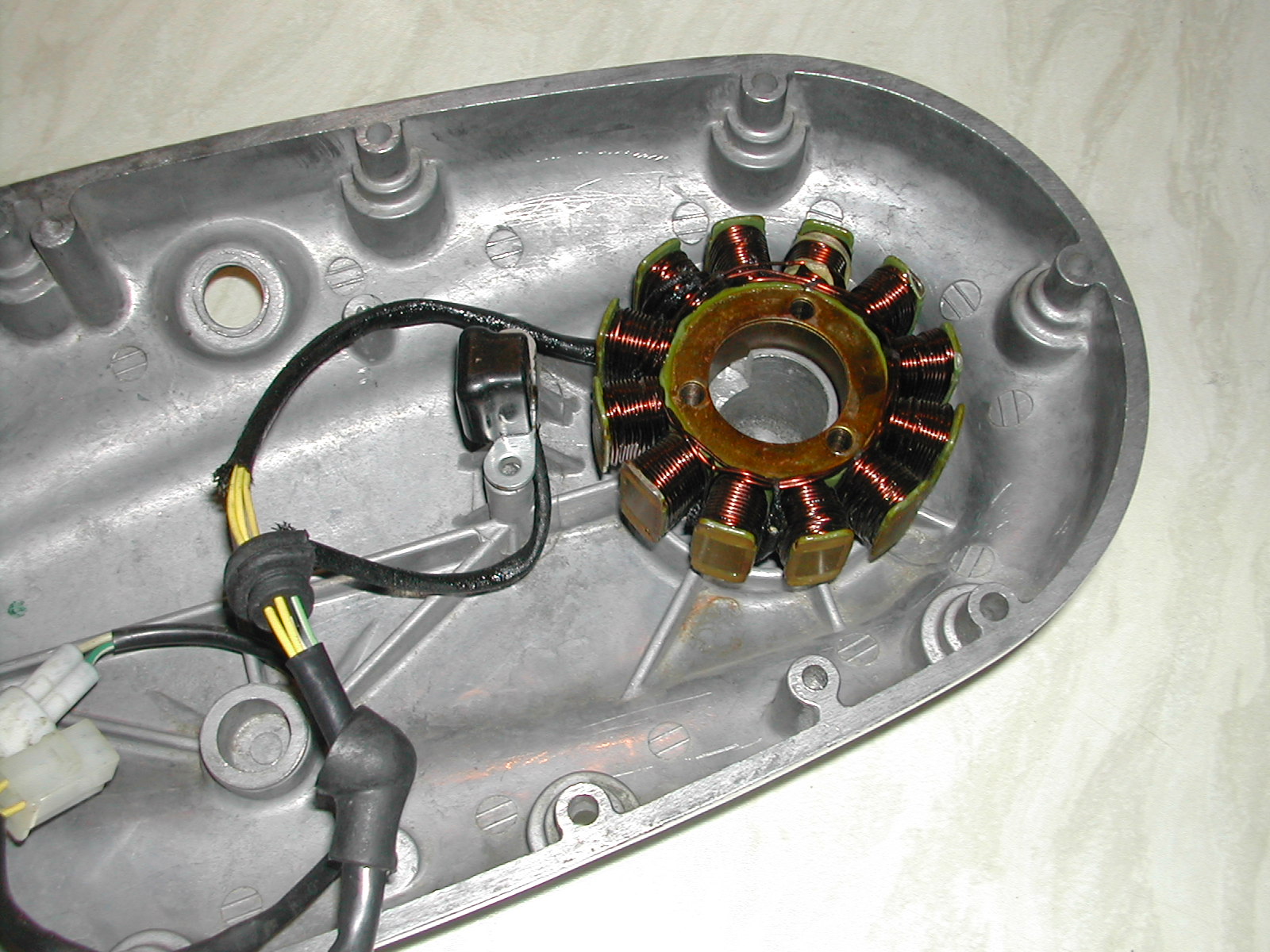

Maybe worth a continuity check on the alternator phases too. The primary noise and the overpower may be one and the same issue. I'd check the stator is in good order and the air gap is correct, if it's been rubbing, you could have an internal short somewhere. See if the noise gets louder when the lights are on (increases load).

Can't do that with the Electra-X alternator, unfortunately, the stator is fitted to the outer cover and can't be mounted without it, though looking for signs of contact/rubbing would be worth while.

Thanks for all the advice, that's what these forums are for. very sheepishly removed primary chaincase, expecting bits to fall out, cut alternator wires etc, nothing, except slack chain..... alternator stator looks good like Adrians photo. Got the gearbox sprocket size wrong, its a 19T i would like to fit. the bike always feels it could pull another tooth, and have done our hosts stage 1 mods ( page 50 2018/19 parts catalogue).
