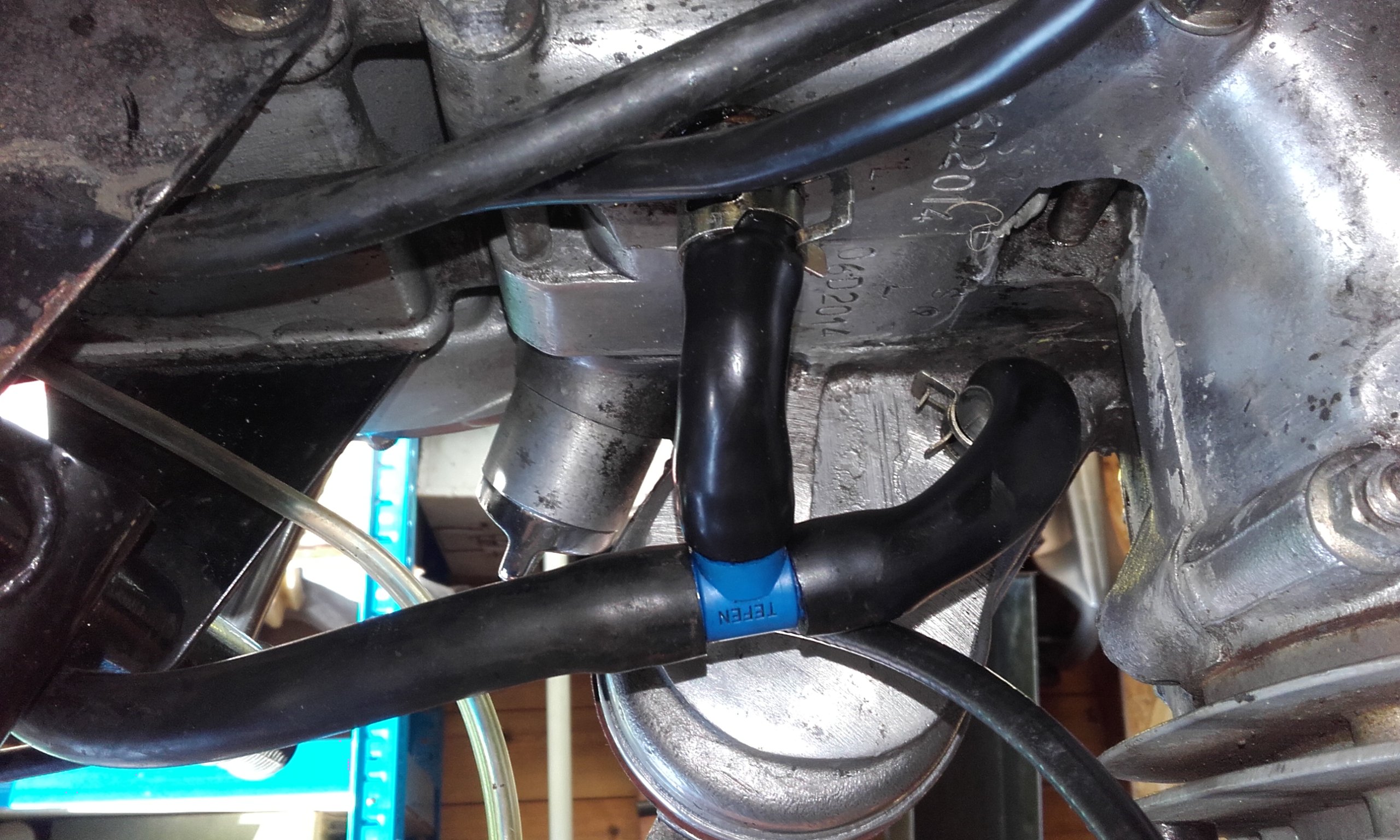

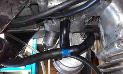

HI all, I removed my rocker covers to check the valve clearances, and found them both very heavily coated with a mayonnaise/sludge.( PAV system was removed 3000 miles ago). so removed airbox and fitted a S&B cone type air filter I found in the shed from my old Suzuki X7. I then rerouted all the breathers to atmosphere. I used a plastic 1/2" tee piece from the greenhouse for the 2 bigger hoses, and the primary crankcase I just tucked away at the rear of the engine . I will do a plug chop and jet as required (have lots of mikuni jets!). your thoughts gentlemen please.
