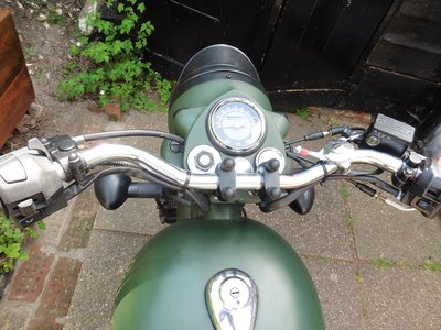

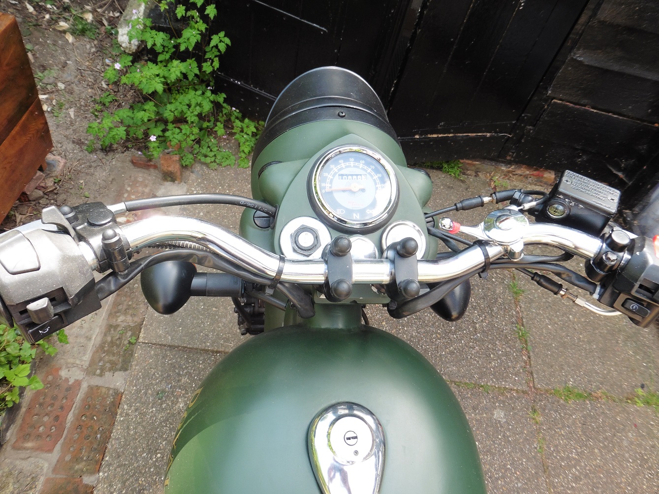

my choke vibrates on whilst on the move --its not slack -- anyone come up with an ingenious solution to stop this ?
as a temporary solution I,ve cable tied it..
#89528
There is a sort of tabbed anti-shake washer under the central chrome boss/cover (under the screw). Perhaps it's flattened/broken?
Mine used to rattle on too, it used to need the centre bolt tighening periodically to prevent it. I think I eventually put loctite on the threads.
