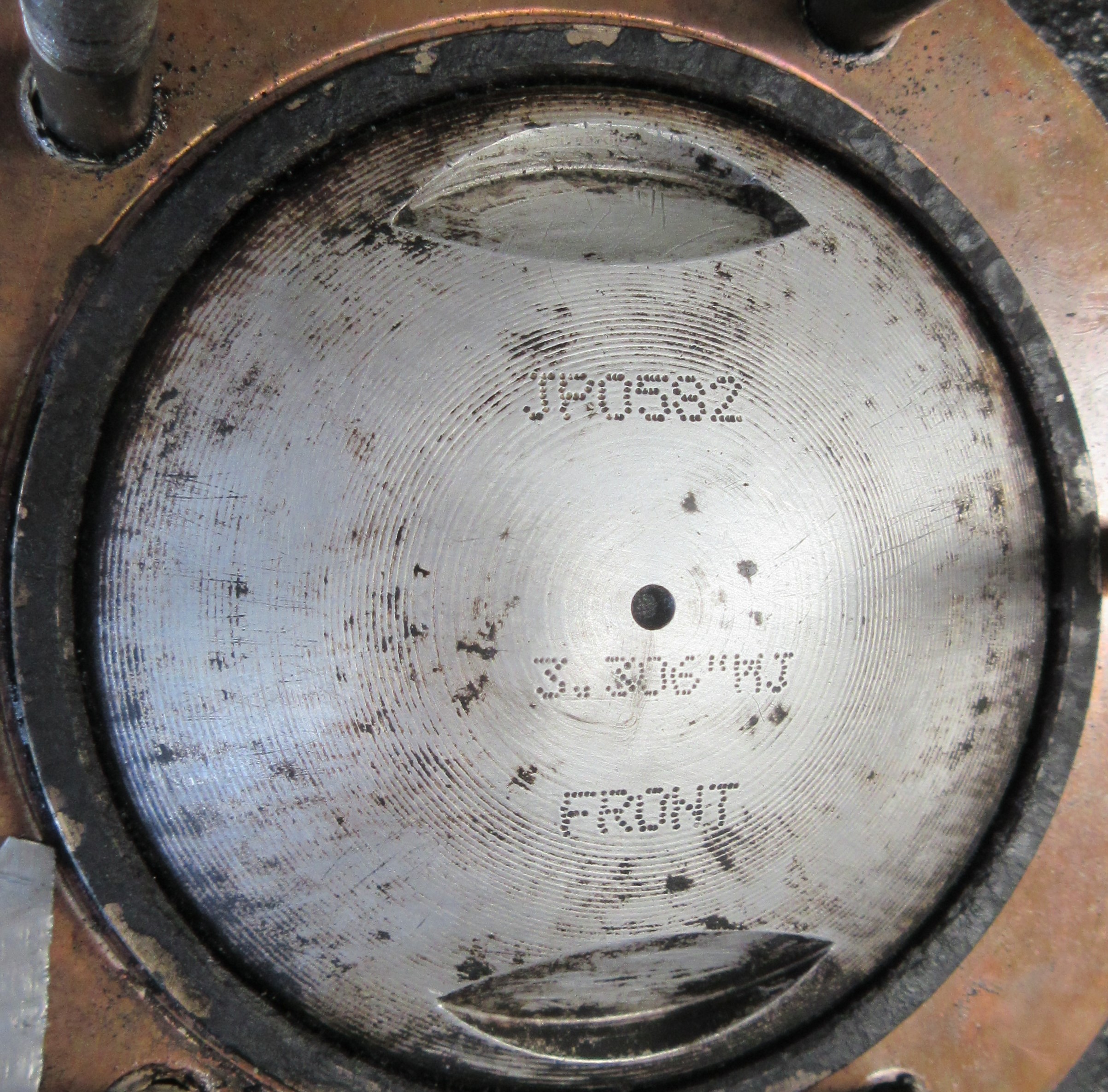

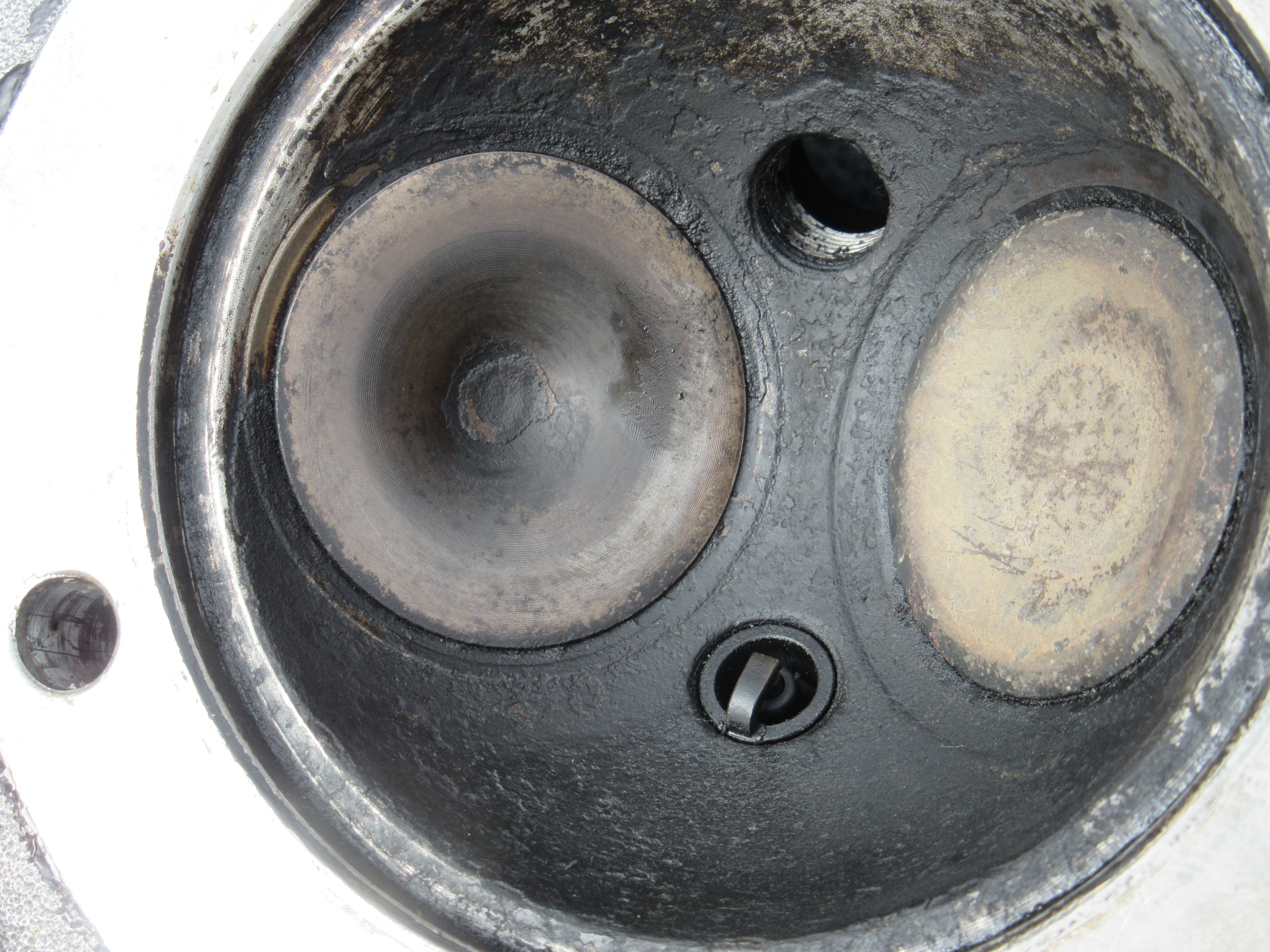

Thank you all for the replies. I am now working my way through the suggested actions. Tank breather: I started the engine, removed the filler cap etc but it still conked out. Sticking valves: I’ve always checked the valve clearances and never had any issues, but (as suggested, you have to do something while in corona induced isolation – better in the shed than peeling potatoes at home) took the cylinder head off – there was some soot but valves seem to be okay. Rockers etc okay. Next step is checking the auto advance unit and the battery. The battery is one of those yellow Motobatt batteries (absorbed glass matt technology, no need for filling), but it is now 6 years old. I could still start the engine so thought that it might be okay? Have no volt meter here. Will get to the bottom of this but it might be a while. Will keep you posted. Clement.
