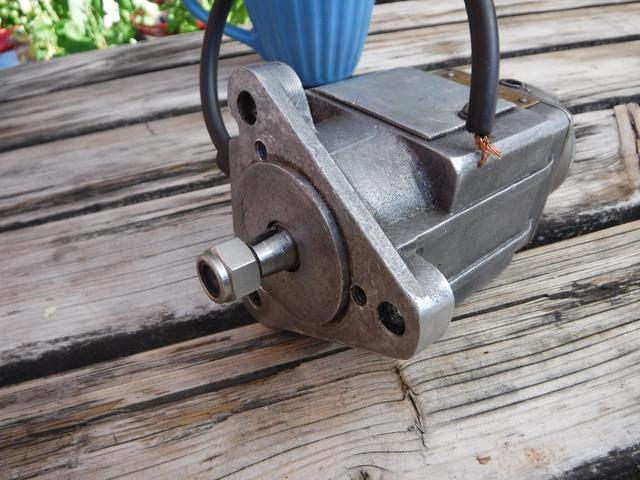

So is a Lucas K1F or BTH KC1 flange-mounted magneto an option? Well, they’re both available with anti-clockwise rotation, and while many of them were fitted to Velocette singles with auto-advance units, some manual advance versions were also made. OK, this sounds promising, so I bought a worn-out BTH at autojumble (didn't see any K1Fs) for overhaul and modification. Now why aren’t more Bullet owners using them, or at least the more experimentally-minded among them? Because they don’t fit, that’s why. Here’s the problem.

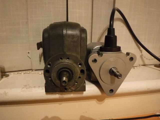

Both have fixing holes at the 10, 2 and 6 o’clock positions, but the three holes tapped ¼”W on the SR1 flange on the left are a lot closer together than the three 5/16” holes in the flange of the mag on the right, in this case a BTH KC1, but the Lucas K1 (and K2) mounting flanges have the same dimensions. Both magnetos have a locating spigot, the SR1 41mm/1⅝” diameter by about ⅜” deep (the ‘56-on Bullet crankcase machined to suit), the KC1 50mm diameter by only 3mm deep.

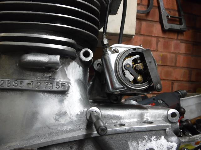

The advance and retard cable is a bit close to the cylinder fins, though if you fit an end housing with the cable exit on the right (swapping from slack wire to taut wire advance in the process) it keeps it well out of the way.
