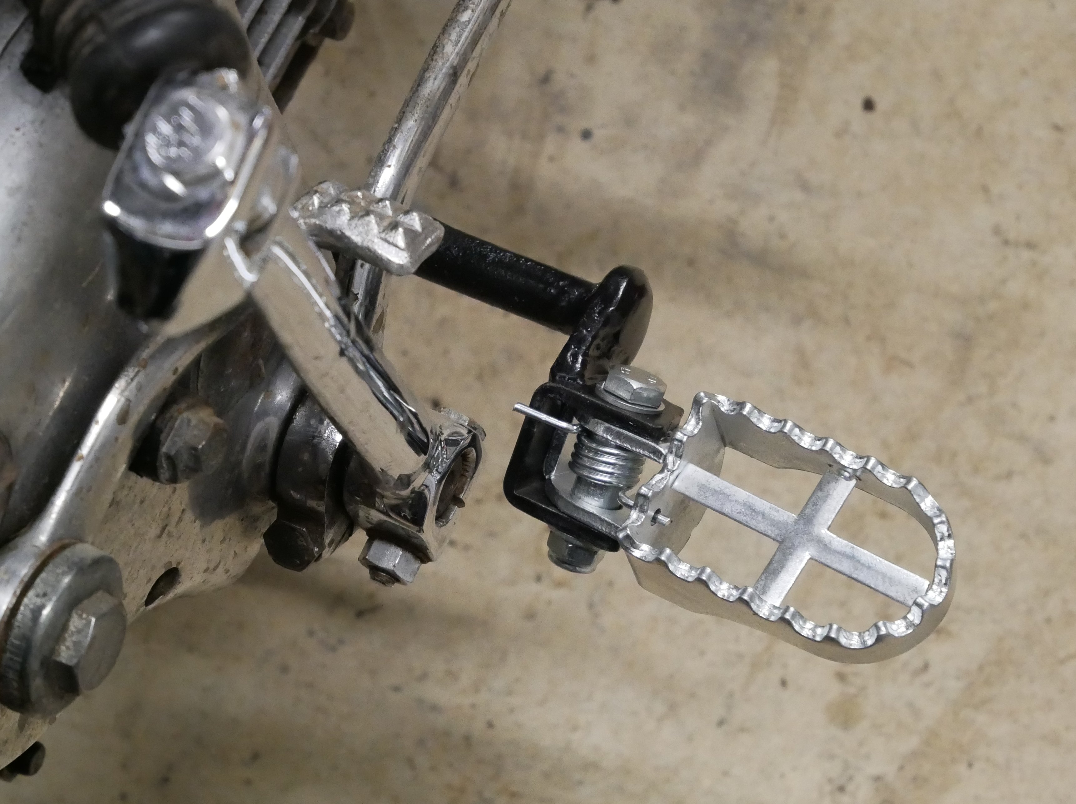

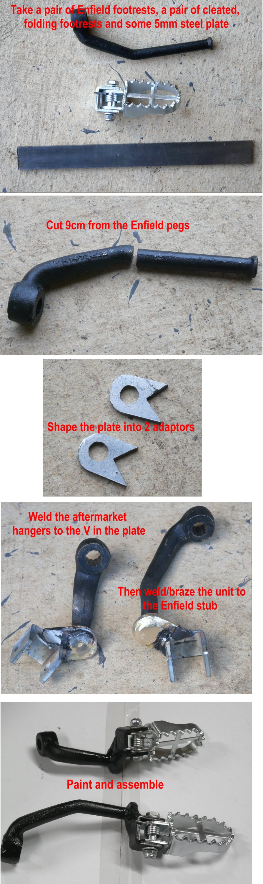

I've had some garage time afforded by the procession of tropical storms we're enjoying here in the wild North. I used my time to craft some new footrests for Dirty Bertie, my Bullet trials - with the help of my local welder!
I wanted to keep the footrests in roughly the same position but a couple of inches further back (so my legs are behind the tank when standing) and have folding, cleated footrests.
Here is the result. Hopefully there will be a break in the weather sometime soon and I'll be able to give you a test report on them.
Below is a recipe for their creation ….
