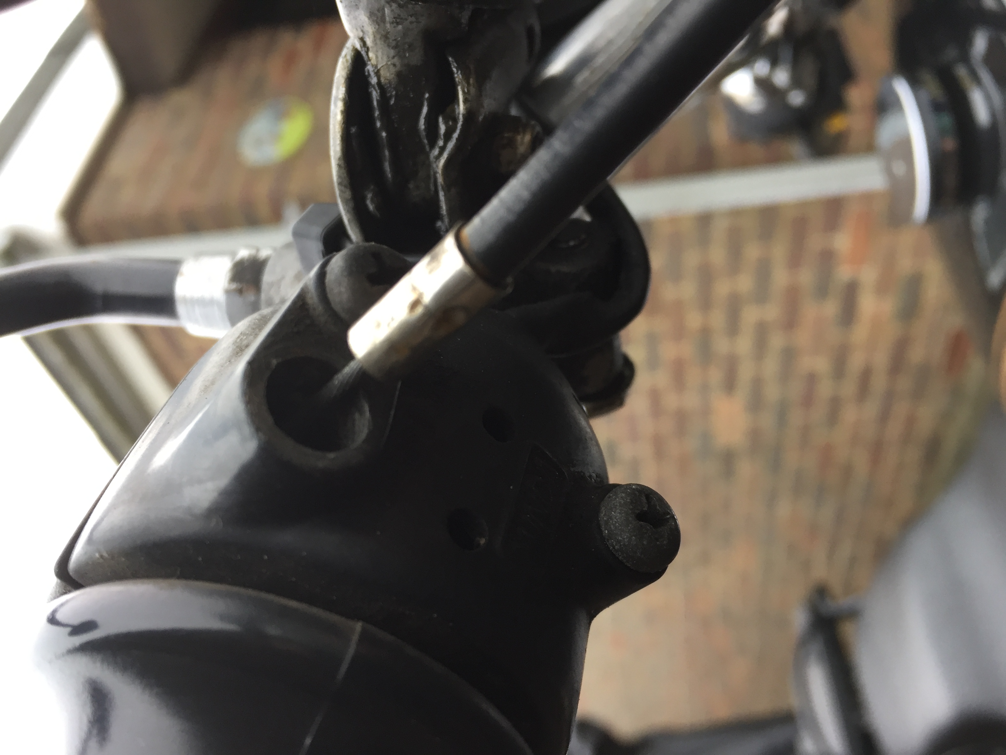

Hi All,
2002 350 Bullet, about to start it, started full revs!! Iced cold engine!!
Anyway, I seem to be missing what I assume is some type of ferrule-ish, I guess-ish.
Can’t see it in my manual, on our host’s site or outside my house; probably is there, I can’t see it.
Any help please, thanks.

By windmill john
#87408
Brilliant!
Many thanks mauri.
Why the heck can’t I see it! Obviously I can order it due to the number, but looked under cables and handlebar controls.
What’s it under!? Purely for interest now as I can order.
John

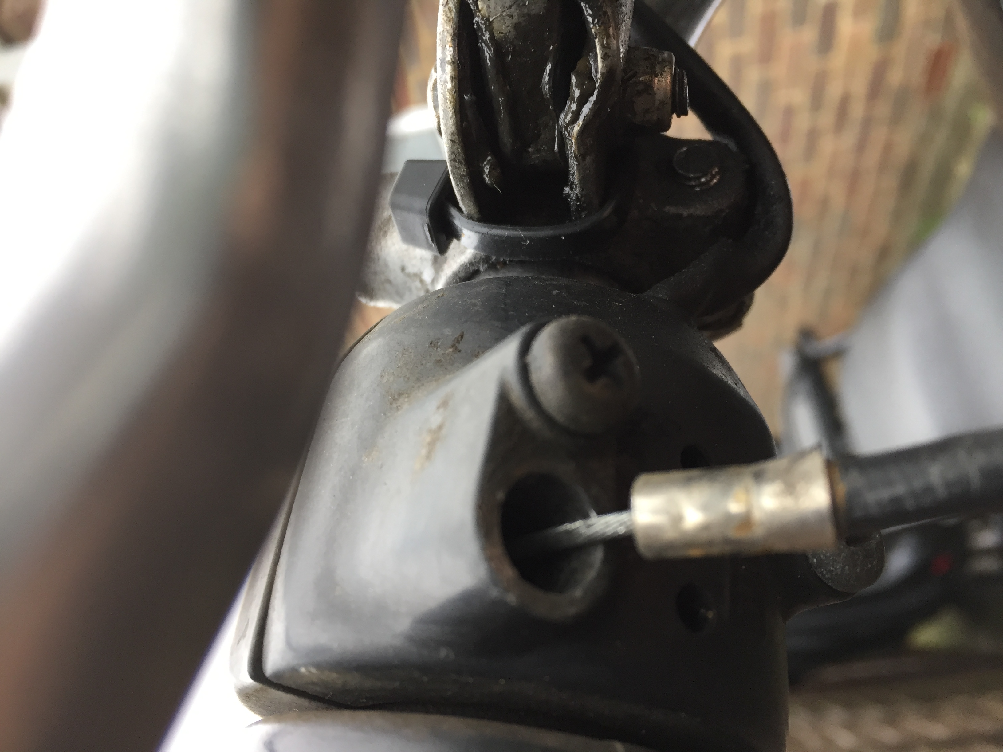

By PeteF
#87409
These will fall out because of stiffness in the cable. The outer gets pushed away from the twistgrip and this falls out. You might want to check the cable is lubed and there are no kinks or loose strands.
By stinkwheel
#87410
Part 15 on this page: https://www.hitchcocksmotorcycles.com/p ... -pages/424
They are a sod for falling off. I wrap a piece of PVC tape round them after fitting to cover the slot. I've also seen people put a small cable tie round them for the same reason.
To me, they are redundant engineering and a damned nuiscance. I think the idea is you can push the twistgrip nipple up through the housing then hook that thing on to make the hole smaller for the cable ferrule to butt against . In reality, what they need is to ditch that thing, use a smaller hole and a smaller nipple or cut a slot in the housing to thread the cable in.

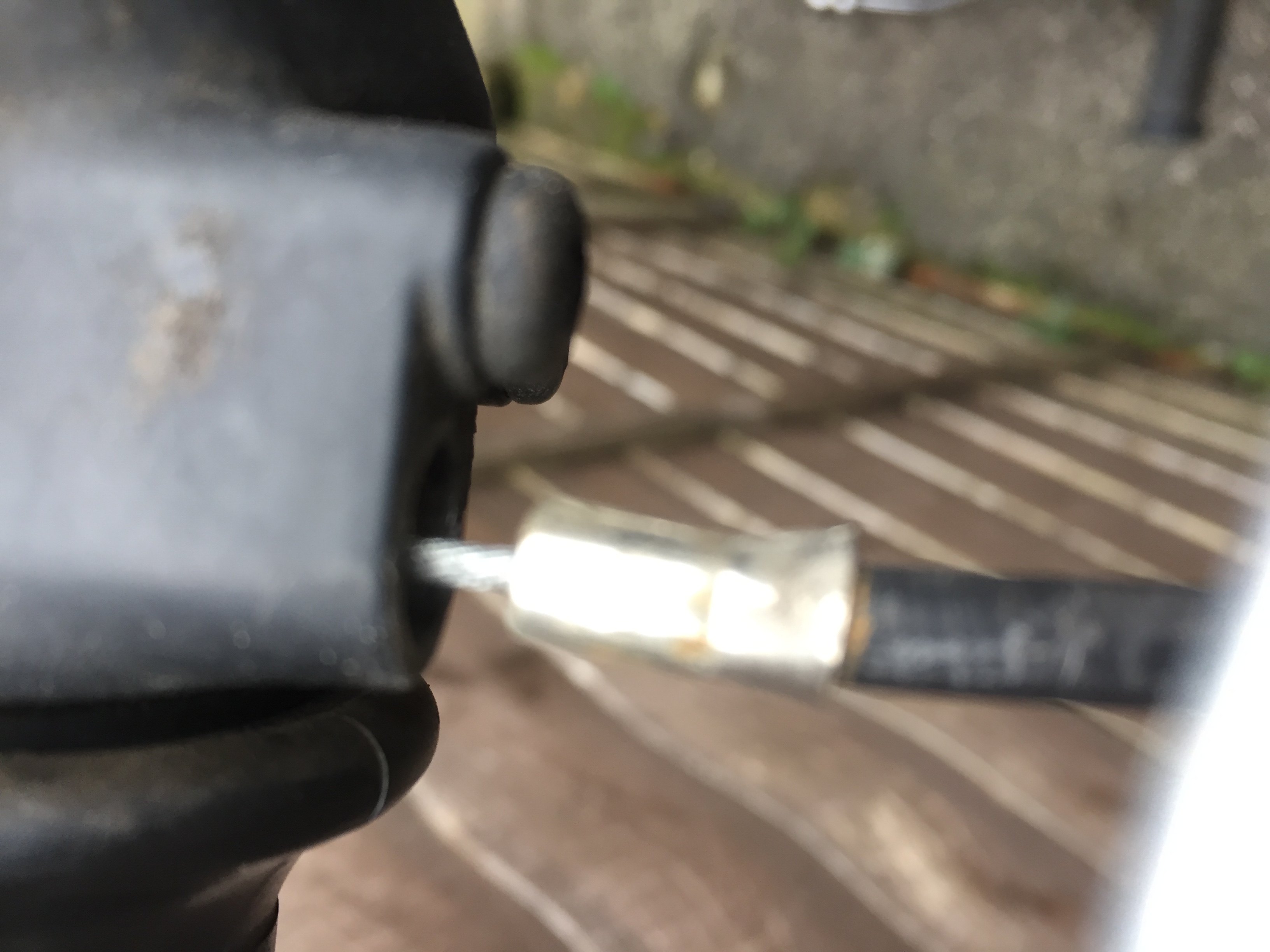

By windmill john
#87412
Thanks both.
I was thinking of taping it in. I’ve ordered two. If anything happens to one, I may tap a small thread from above to secure.
The Japanese would have threaded this, but... you can’t have everything.
I must have been viewing the site wrong, as I didn’t find it.
