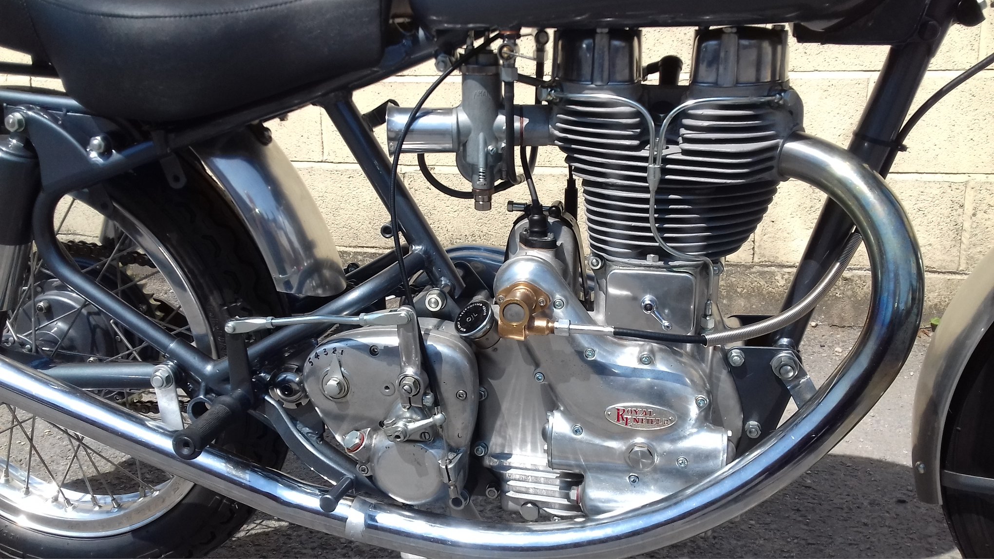

So Selvam's engine is a bitsa, even though it
looks the same as the Woodsman engine. My apologies for my earlier error, I wonder what happened to the original head. Anyway, for a Fury with no lighting kit, this is what the original bike would have looked like in all its big head glory, forget the Woodsman!

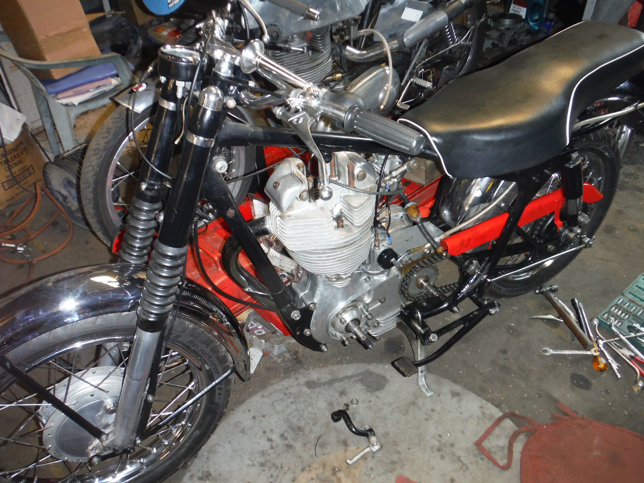

Ref Graham's point about the non-original magdyno strap, it is of course possible that that a subsequent owner of a non-alternator fitted Fury wanted to retro-fit some lights, and with no provision for an alternator on this crankshaft, replacing the magneto with a magdyno would have been a lot easier than a crankshaft swap. A friend in New Zealand recently imported a Westerner 500 Scrambler, which also would not have had lights originally, but someone had also fitted a magdyno to that bike at some stage so that they could run some.
The front engine plates do indeed look like they're off something from Enfield India compared to the curved items in Bullet Whisperer's Fury picture.
I also wondered about the frame in the background, the Series 1A Interceptor top yoke may be a clue if that also hasn't been swapped from another bike!
