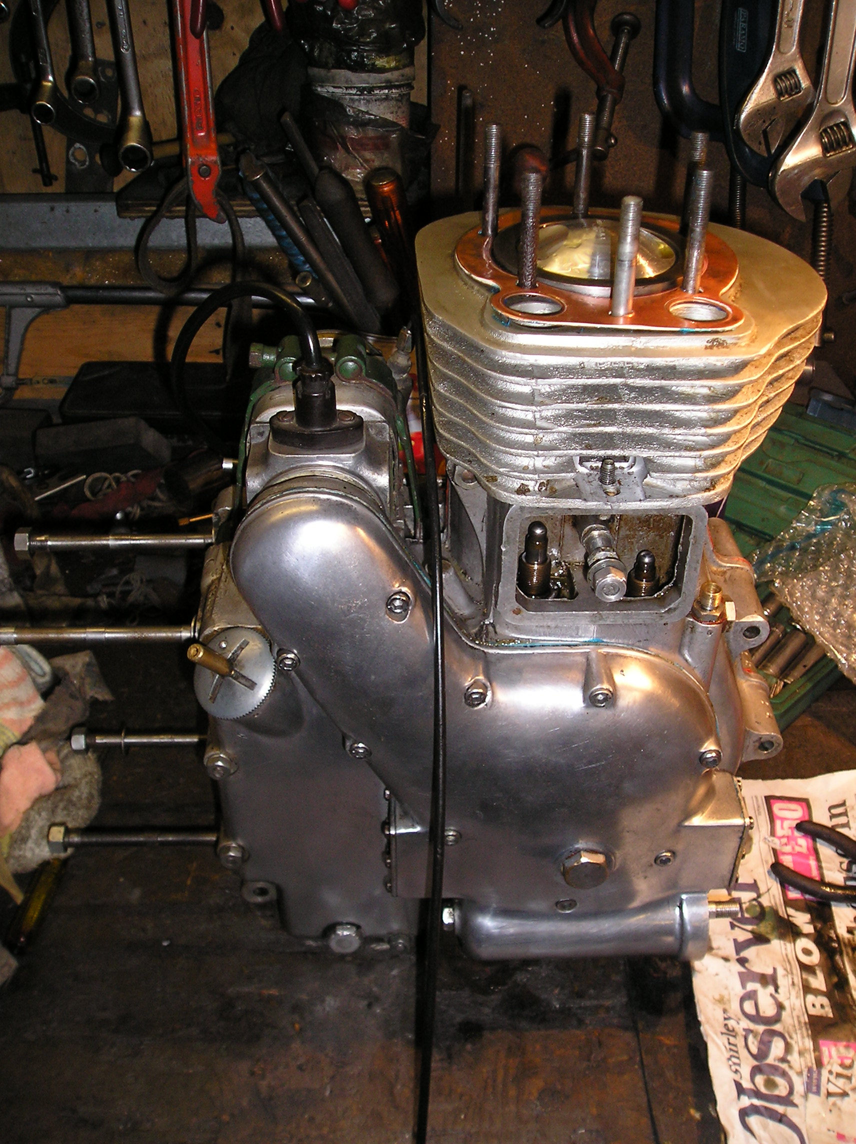

Hello, Dai and Happy Christmas to you, too. No, it wasn't your machine, but a pre '55 engine, with later, post '55 wider pattern alloy head and barrel I was referring to above [see my first ever picture on here and check out the stud holes at the bottom of the barrel, above the tappet chest].

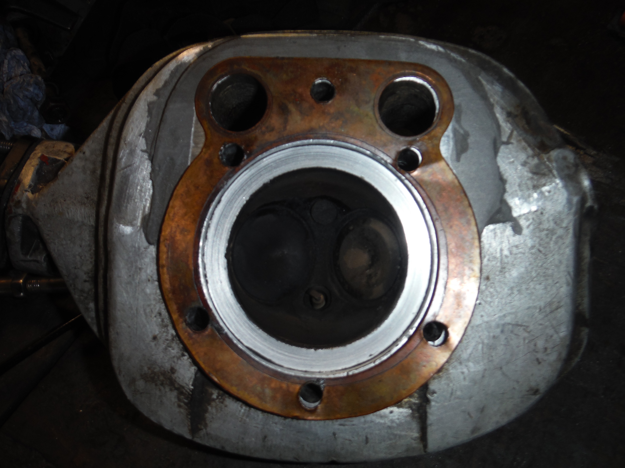

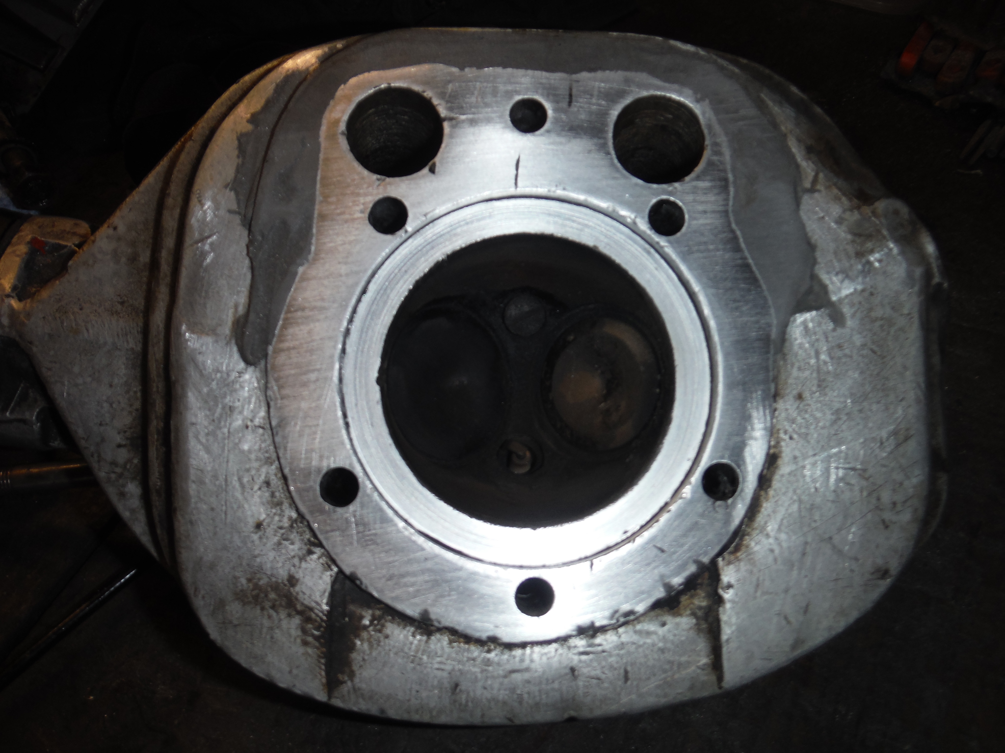

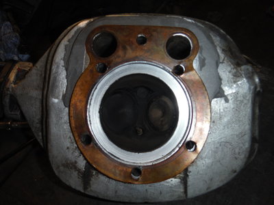

Here is Dai's cylinder head, with added Devcon, to build up the gasket face and stop the leaks. There was only a few thou of metal overlap between the barrel and head joint faces at the outside of the pushrod tunnels and building it up allowed better sealing of the oil with the gasket. That old head gasket was just used as a template, by the way!
#86788

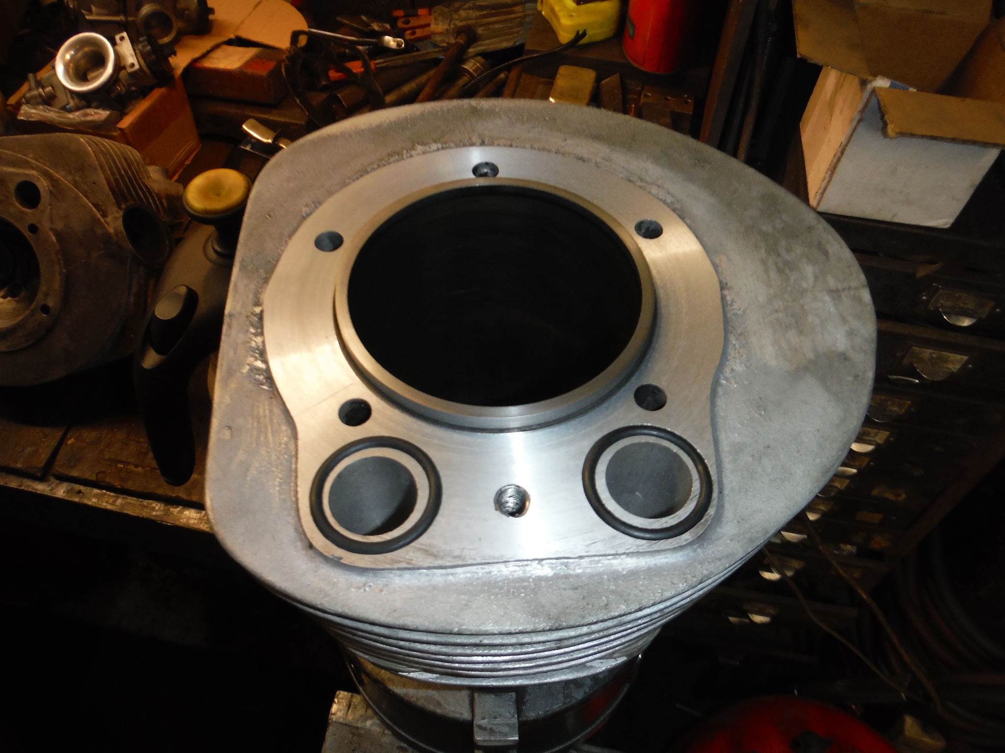

I do wonder if those barrels would be better with a groove machined round the pushrod tunnels for an o-ring/crush washer and just missing them out from the head gasket asembly altogether, similar to some of the liquid-cooled 2-strokes where the water-jacket connects to the head. Some of the composite gaskets do have an integral bead of goo round the pushrod tunnels
There was also an article in The Gun a while back about someone cutting down head gaskets so they effectively formed a very thin strip round all the necessary mating surfaces. Effectively a wire skeleton of a head gasket. As I recall they used the concept on some WW2 aero engines. Less surface area but a much greater degree of compression of the gasket material and more tolerant of imperfectly flat mating surfaces.
By Bullet Whisperer
#86789
I have converted a number of alloy barrels to use o rings around the pushrod tunnels - they don't always want to be concentric to the holes, which may be slightly out of step with those in the head, so I like to place a barrel and head together and look down at the tunnels where they meet, to decide how to position the o rings. With this set up, I always lap the liner spigot into the recess in the head, to seal compression.
