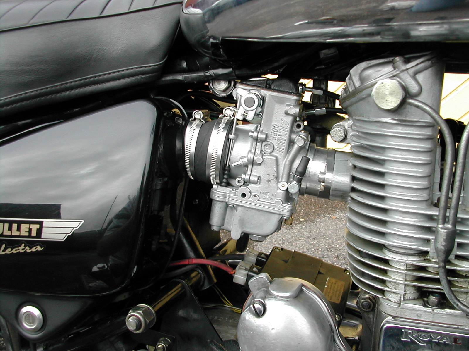

Mikuni TM36-61 carb shown fitted.

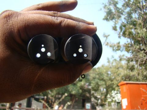

Ported CV Carb Throttle Slide vs Stock CV Carb Throttle Slide

Coming to the throttle slide on a CV carb, there usually are two or three ports/holes/orifices on the bottom of the throttle slide. On of these holes, the one which is in the center, accommodates the needle of the carburetor. The other hole(s) are basically vacuum ports, which are extremely important as they are the ports which are responsible for vacuum changes, and hence directly impact the working of the CV carb. The throttle slide modification in question is directly related to these ports.
What we essentially do in this modification, is we drill out the vacuum ports to a slightly larger diameter. For example, the vacuum ports on the Mikuni BS29 CV carb measures 1/16th of a inch in diameter. What we do is, we drill out the vacuum ports to 1/8th of an inch, effectively doubling it’s diameter. This doubling of diameter increases the flow of air through these ports by 4 times. Thus, when you whack open the throttle of a motorcycle that has a ported throttle slide in it, this time, the rate of change in vacuum will be a lot quicker than that in the stock slide. As this rate of change in vacuum is quicker, your throttle response goes up massively and your motorcycle feels much more livelier. Of course, you won’t be going any faster but you’re motorcycle will certainly feel a lot more agile and more responsive to your throttle inputs.
