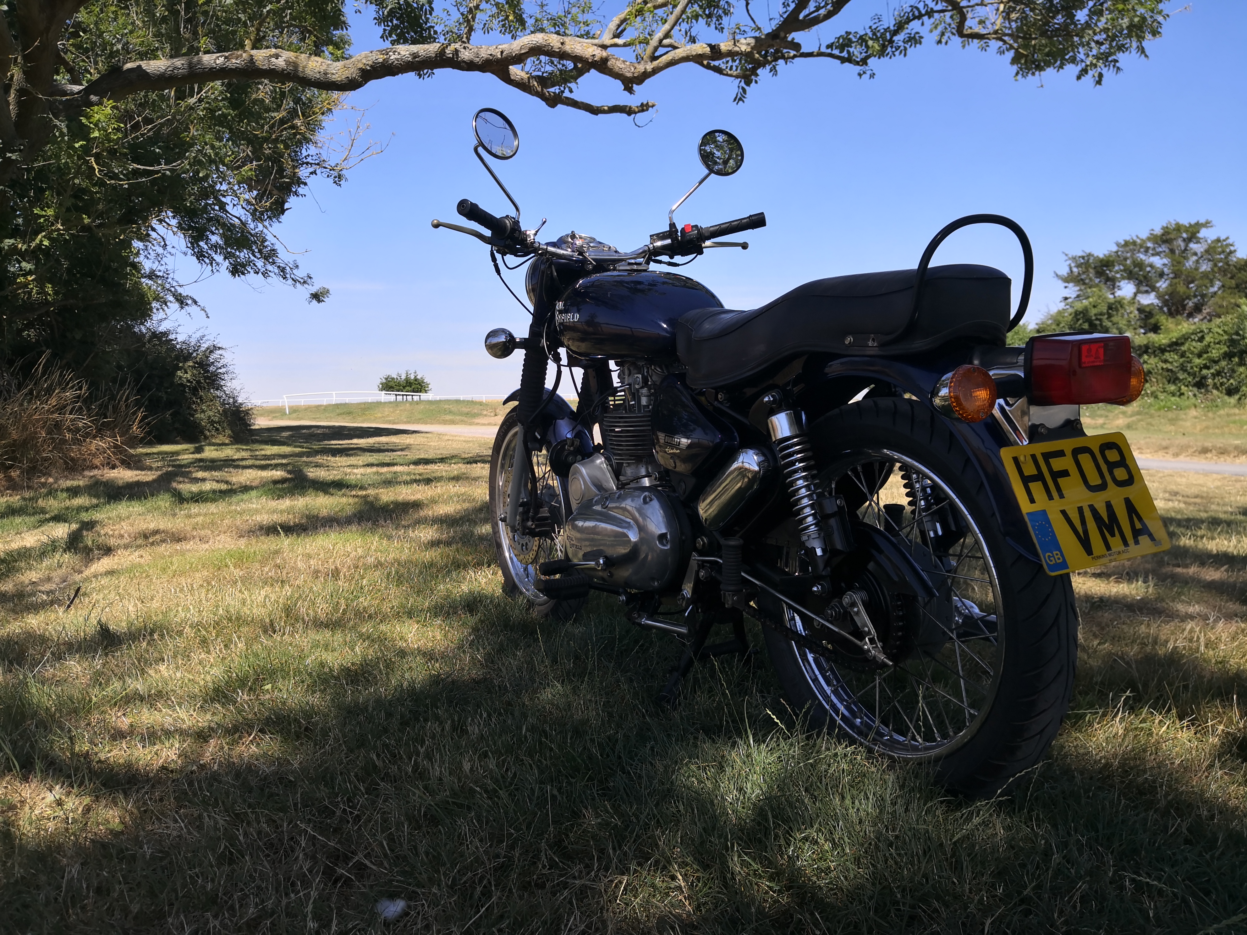

Just an update if anyone has had the same issues, all sorted now and running fine with all the electrics now behaving and not causing issues, as time went on I started to doubt the Battery more even though it was showing high voltage intermittently.
Yep cause, the battery, refitted with a new -Motobatt MBTX14AU - AGM Motorcycle Battery 12V 16Ah, works great.
Did also fit a New Japanese Regulator, though don't feel this was the cure.
Though still no electric start spins with lots of power but won't engage, is this the fate that Ive read about with the Electra and its Electric start, sprag clutch and all that stuff, is there way forward to make that work or is it aload of hassle and expense, would be interested to hear from anyone regards this.
Battery fitted in the compartment fine just had to put a different terminal on the positive side as it was to close to the frame if anyone is considering this battery for there Electra X 2008
Thanks for the various help with this thread over the last few weeks even though its tapered off recently.
Geoff
