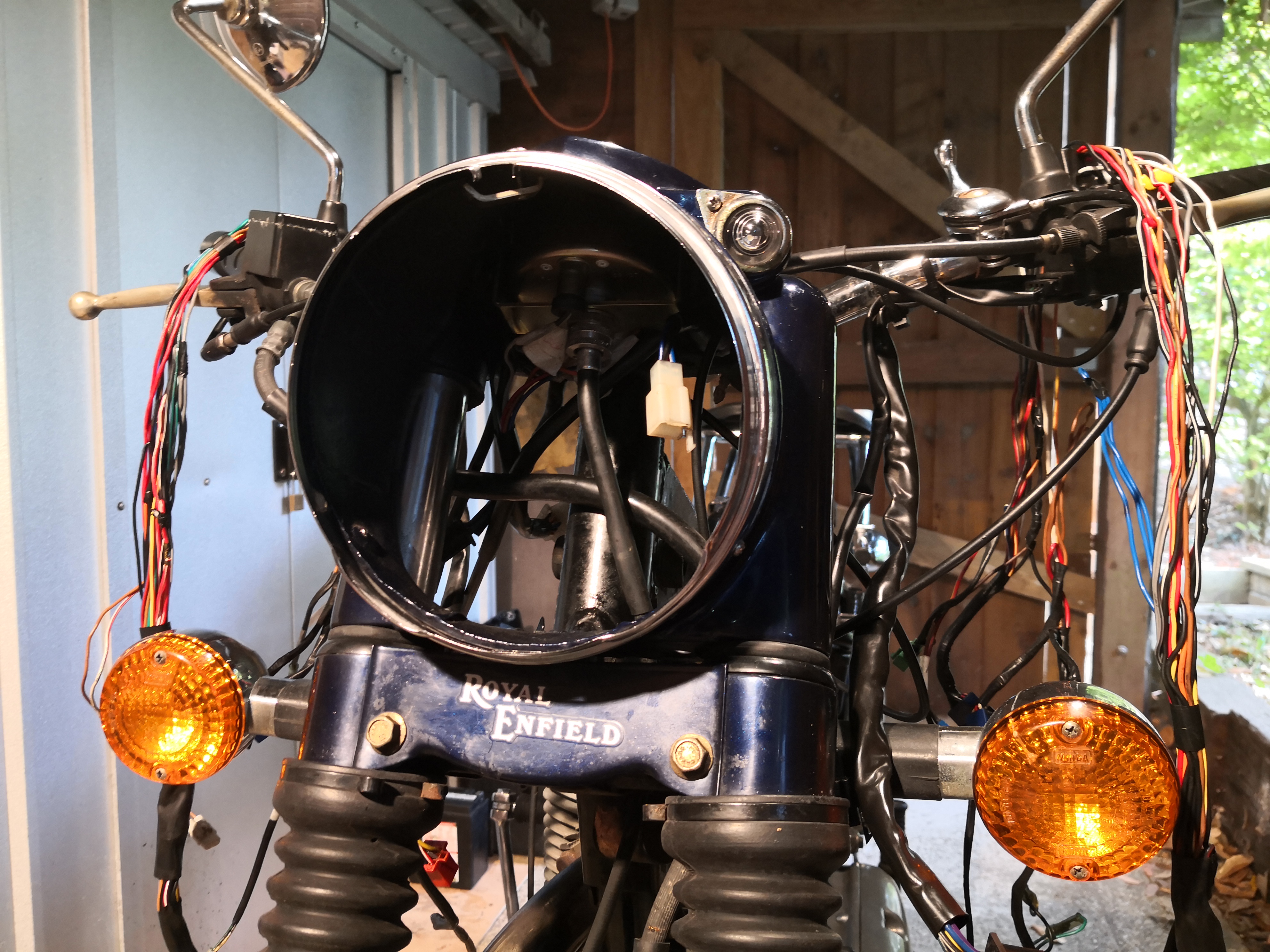

... Ermmmm getting abit obsessed with hunting down this wiring issue now.
Thanks for the call yesterday Adrian, I'll let you how this goes, I'm abit all or nothing, so have ripped all the wiring out, disconnected and untaped everything, so I will test all the wiring and connections and put together all neat tidy and waterproof, going to replace the rubbish glass fuses and holders for blades and a better housing for them, any suggestion for that, I'll look around online sure there must be some improvement to fit nr the battery.

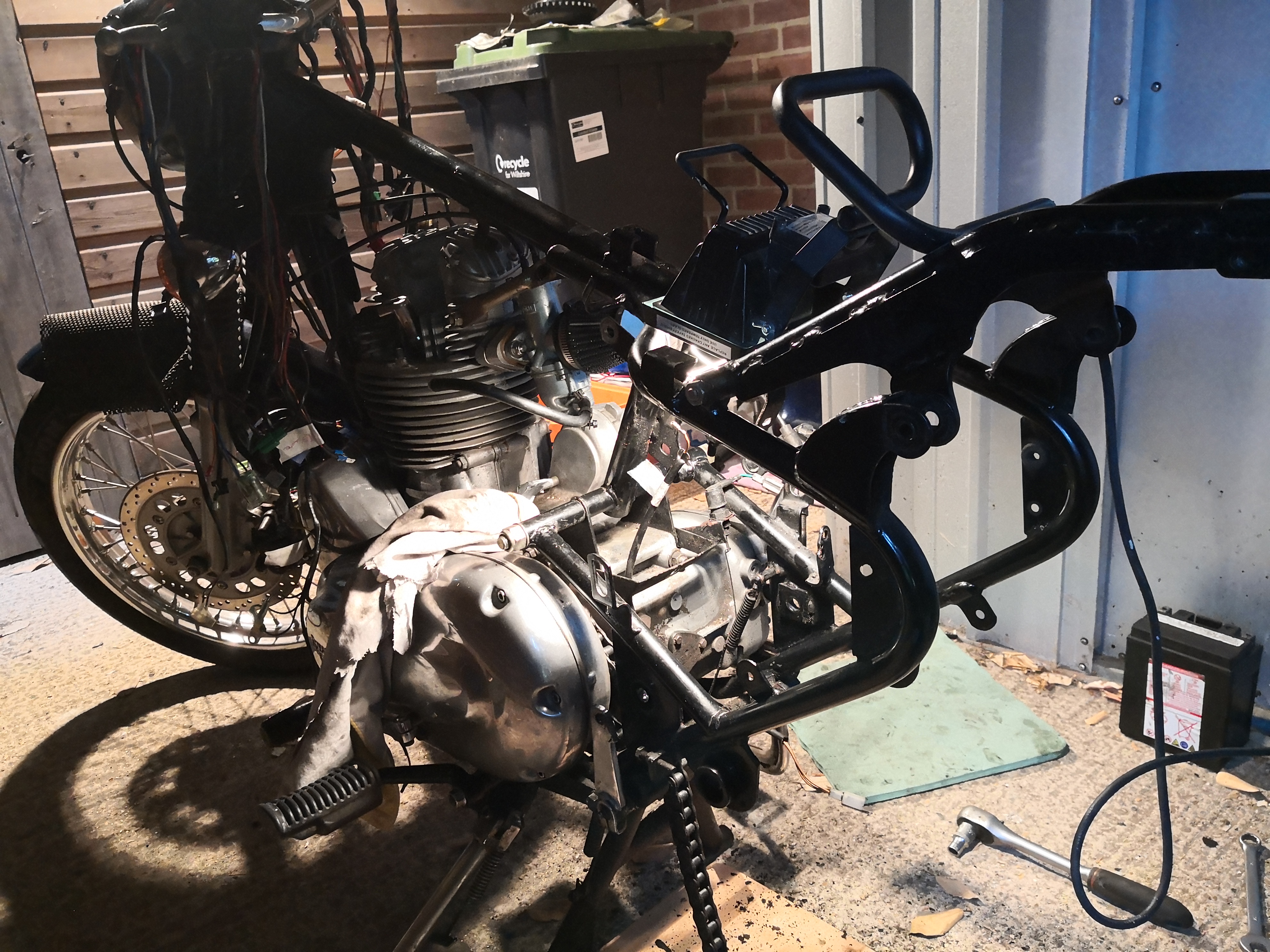

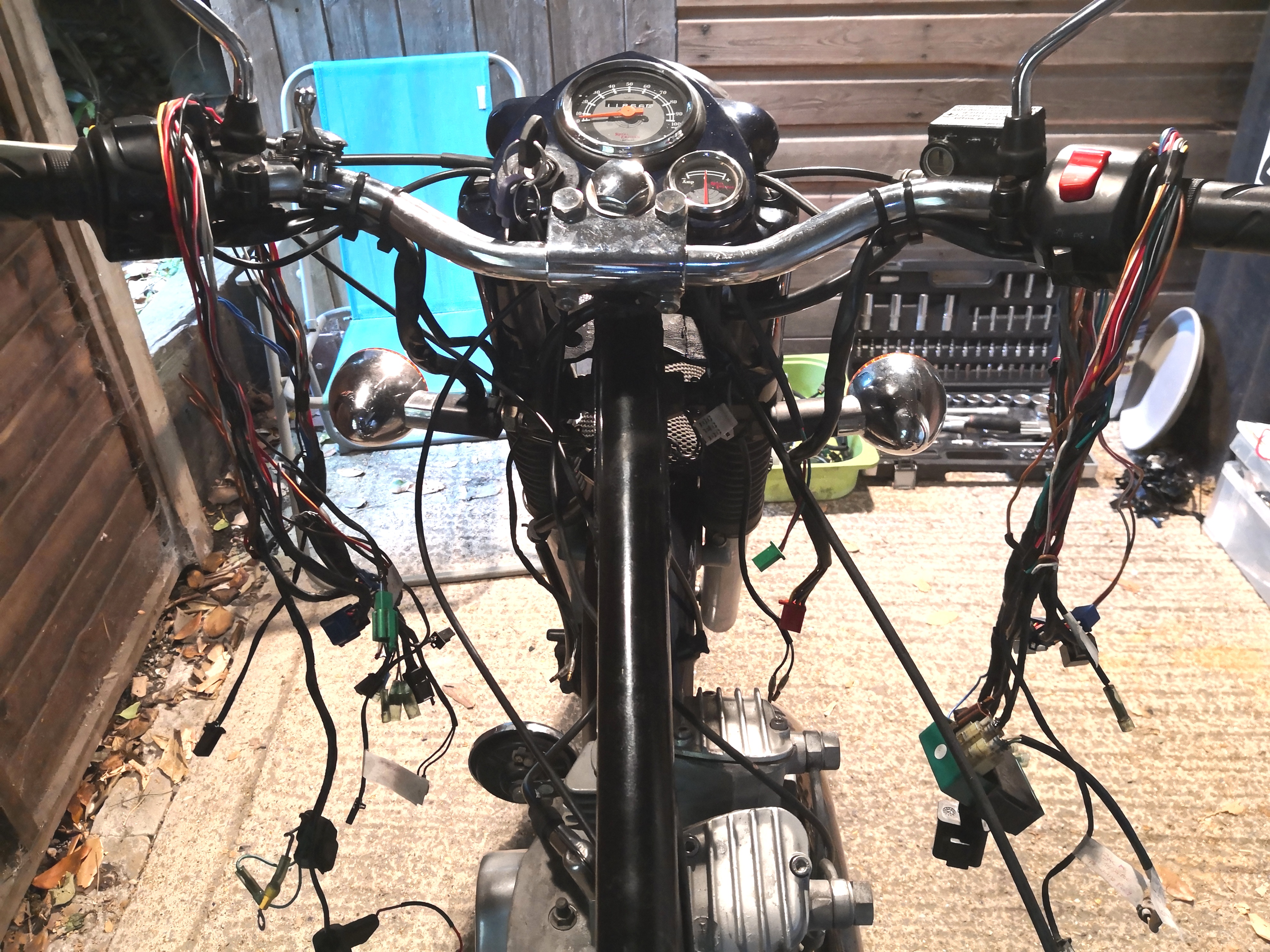

Hi Adrian, I've gone completely overboard in the process of sorting out my electrical issues and have ended up taking apart the the whole back end along with stripping the wiring off.
Just thought while I was at it I would make good some areas looking abit rough, presently stripping the swinging arm to respray.

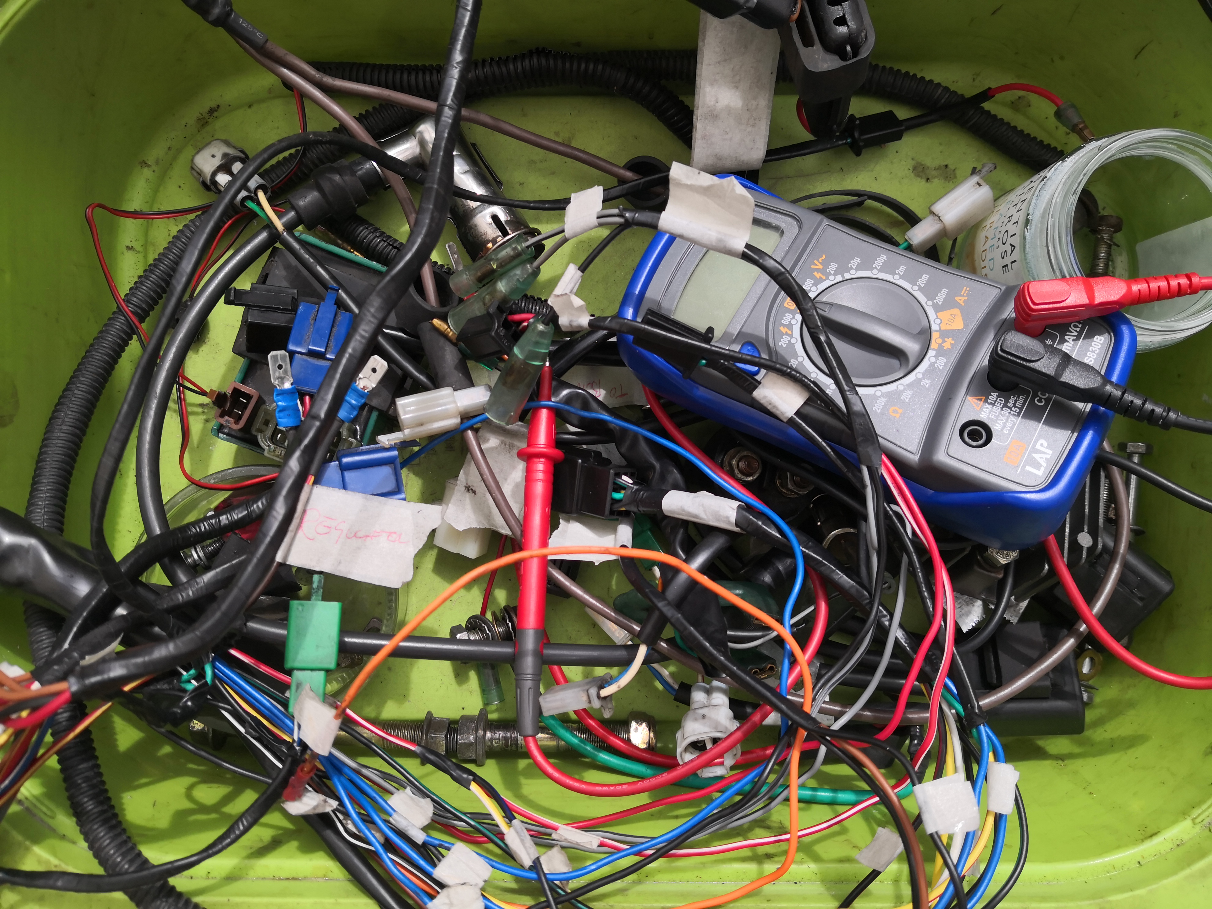

Tested all the the loom wires, all good and showing a reading accept one bullet connection that looked sound but would only show a reading if moved about, it was connected in a round about fashion to the side stand, so adds up with a brief moment when I kicked the side stand up awhile back and the clock lights went from dim to bright though doesn't seem to fit with putting the pilot light on and dropping the power when riding about a week ago and putting the lights on or other load and knocking everything out?
I have rebound the main lengths both side of the looms with self amalgamating tape and have left for now new end connections and new fuse box as just want to get it running before it gets that treatment.
