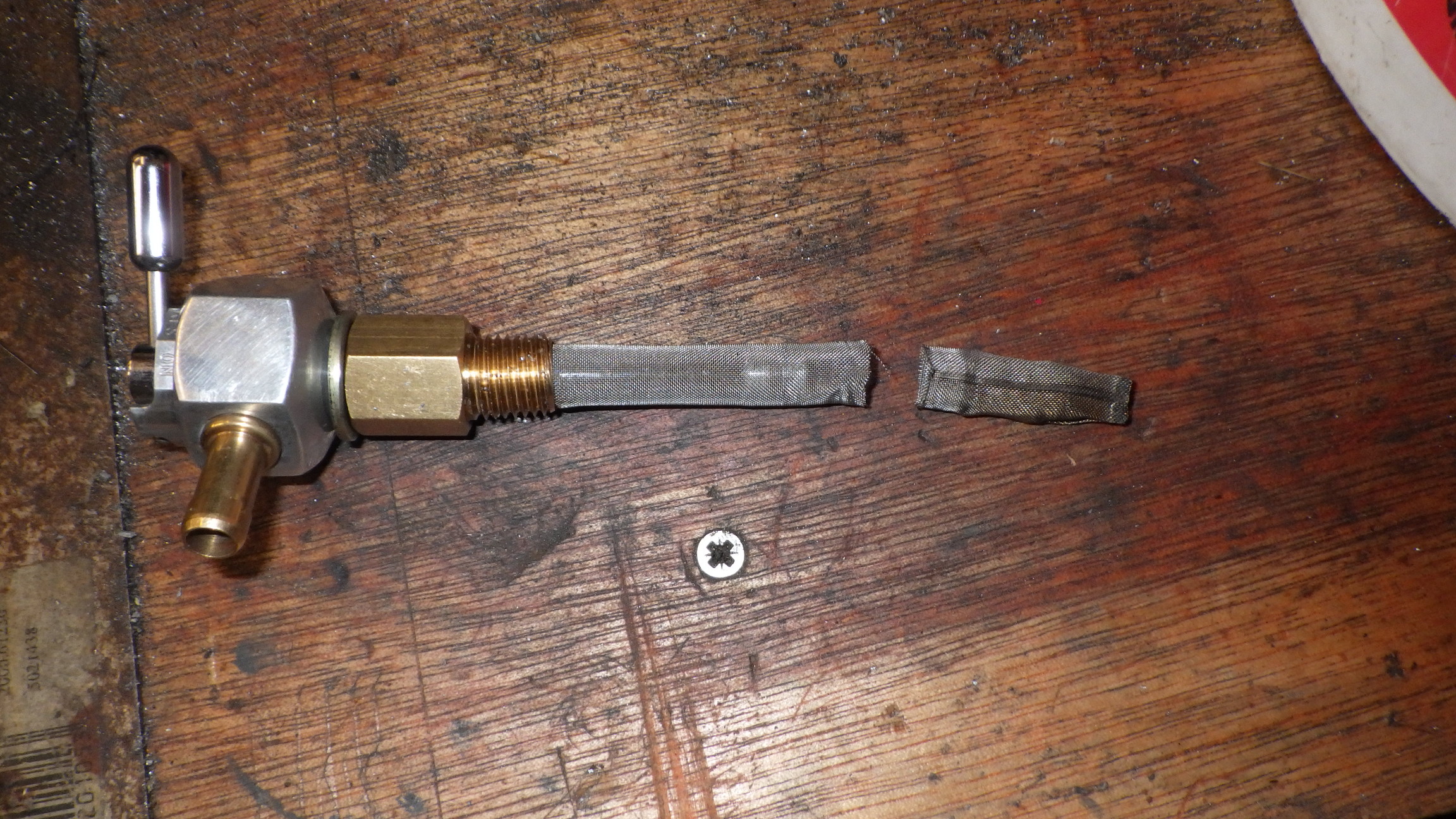

For information, I just fitted a pingel tap designed for a Harley Davidson using a 1/4NPT to 1/4BSPT adapter (which had to be drilled out a little to fit). After a bit of a hiccough in which I tore the in-tank filter and had to solder up a new one, I've got it fitted. These taps are expensive. This one was £70 second hand, they are around twice that new.
I just put 4.5 litres of fuel into the tank then timed it emptying back into the can through the tap (including the reserve setting). It took 3m 10s. That makes a flow rate of 1.4 litres per minute!

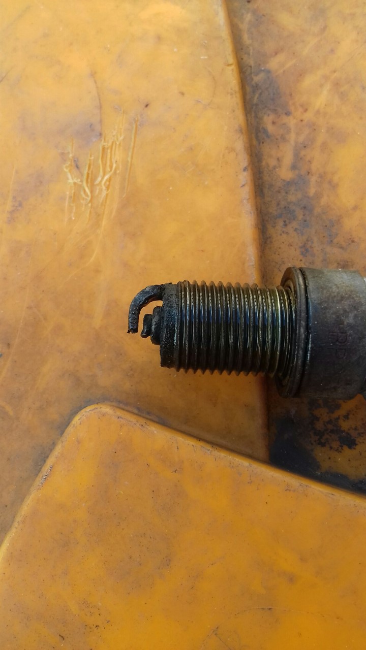

After 2500km the piston rings should have bed-in.
Also the valves and valve guides were renewed.
No valve stem seals were present and not installed by me. (should i maybe?)
Oil consumption is more then 1 litre on 600km.
No excessive smoke, engine performs well, spark plug is heavily fould and needed replacement.
