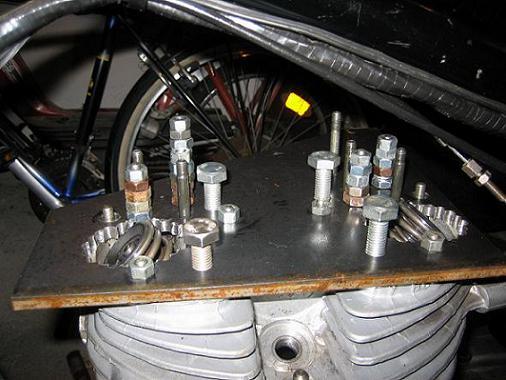

Hi DEAN--- have just re-read only your postings... Have you actually removed 6 washers, one from each of the following}--- a)the short stud alongside the spark plug---b)the medium length stud alongside the de-compressor, ----- c) the 4 long studs accessed from within the 2 rocker boxes??? If NO then you have 1 or more of those washers spread out and have grabbed the screw thread.... If YES then it's likely that one or more of the hole tops itself has spread out and grabbed the thread...either way they DO give a really FIRM grip onto the head, so NO sudden shock moves but more the slowly-increasing lift type..... You might also try to alternate UPWARDS and DOWNWARDS movements so that the screw thread acts like a file.. Now you mentioned that the head has actually broken free from the barrel,(What sort of vertical gap do you have ??)...Just above the tappet access plate is a vertical stud fitted into the top of the crankcase---- it holds the barrel to the crankcase when the head is removed and the engine rotated...It has NO effect on the head at all and at this stage it's probably better left in..Again, can you get a few images posted to help judge the situation....???----Keep those chins up---it WILL come off, eventually !!!
