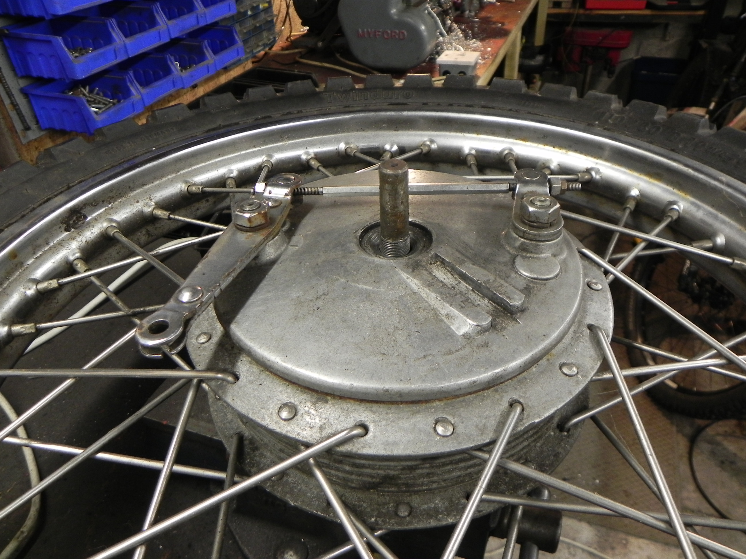

this is how I do it:

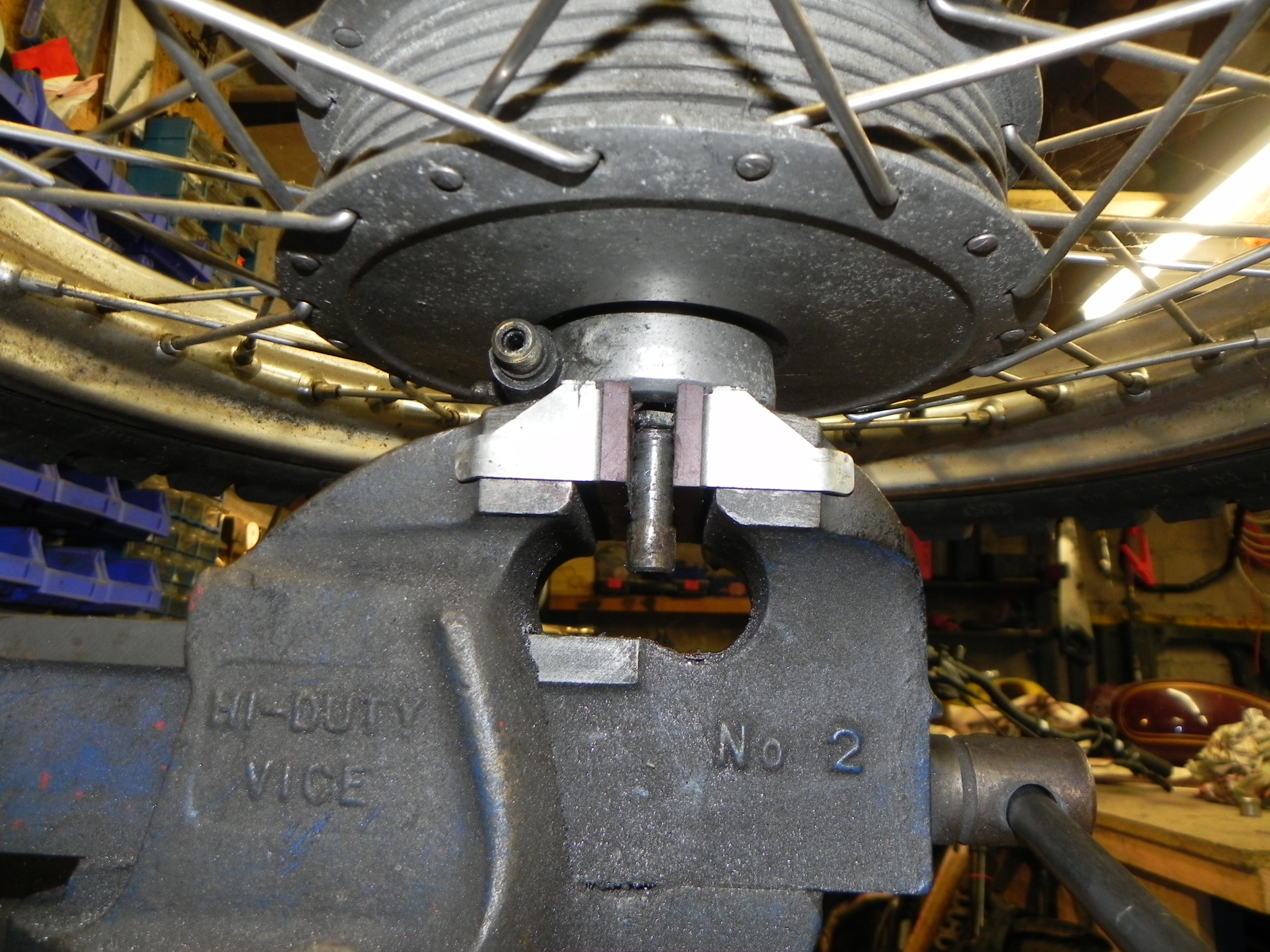

1- put the spindle in a vice as shown

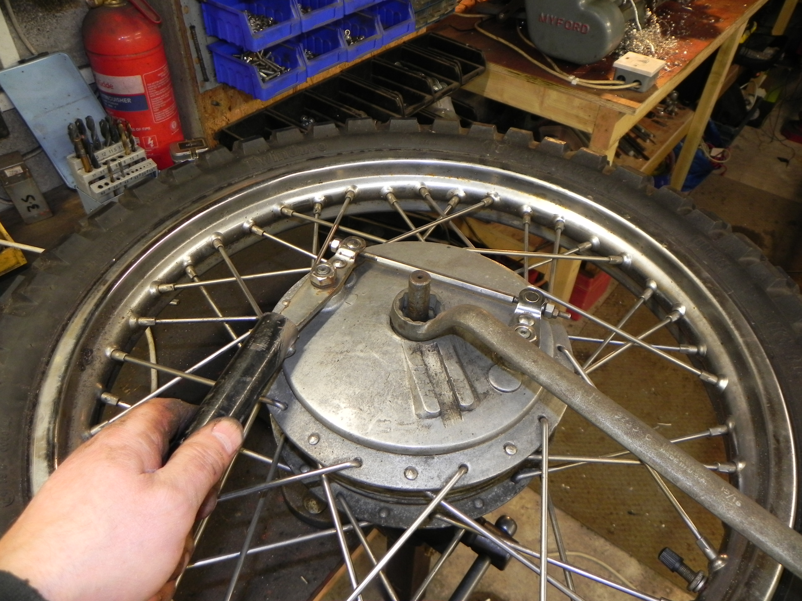

2- slide a length of tube over the brake arm, to lock the brake on, then use your right hand to turn the spanner.
3- nut removed !!
this nut was V tight and I had no problems.
use a 1 inch cranked ring spanner
3- nut removed !!
(photos may not appear in the correct order)
HOW do you block the brake plate when you pull the lever and twist down the nut? THIS is the thing i do NOT get.
