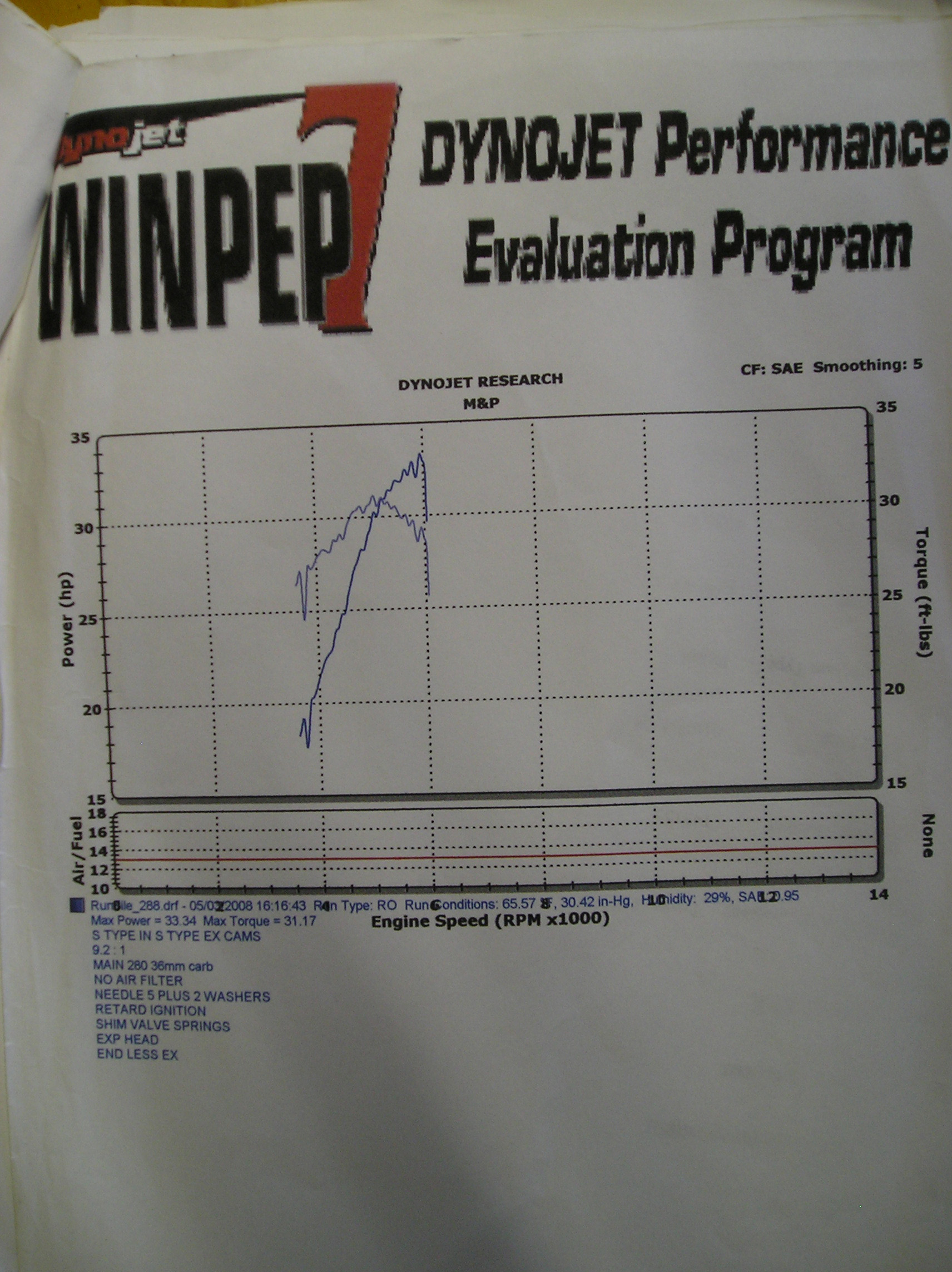

Regarding 32, 34, or 36 mm carbs, when I tuned a 500 Electra X for our hosts in 2008, I tried a 32 mm MK1, 34 mm MK2 and 36 mm MK2, one after the other, on the same day and on the same dyno at M&P, Swansea. Bearing in mind I was asked not to make any changes to the ports or valve sizes [they were left standard], I found with the 34 mm carb, power increased throughout the rev range over |the 32 mm. The same happened when I fitted the 36 mm carb - power increased from little more than tickover to flat out, so the 36 mm carb stayed on. That was on a 500 and here is the dyno sheet from the end of the day, when we were up some 2 bhp over what we had seen using the 32 mm carb.
Electra X Dyno Sheet 002.jpg (840.08 KiB) Viewed 2195 times

I’m the last person (almost!) to question BW but if, say, a 36mm carb is fitted onto a 32mm inlet tract then the effective port size remains 32mm – regardless of the carb size.
However a disparity between port size and carb size will create a turbulence, which may be detrimental or beneficial – an outcome that can only be tested in use and not predicted beforehand.
I still say that the general procedure should be a match between port size and bore size of carburettor.

It does not follow that a bigger carb = bigger power. Often it’s the opposite. As the lower capacity engine fails to generate sufficient air-flow through the carb to draw the correct balance of fuel/air.
The hose with the thumb over – or the river going through a gorge - the narrower gap [smaller carb] increases flow.
