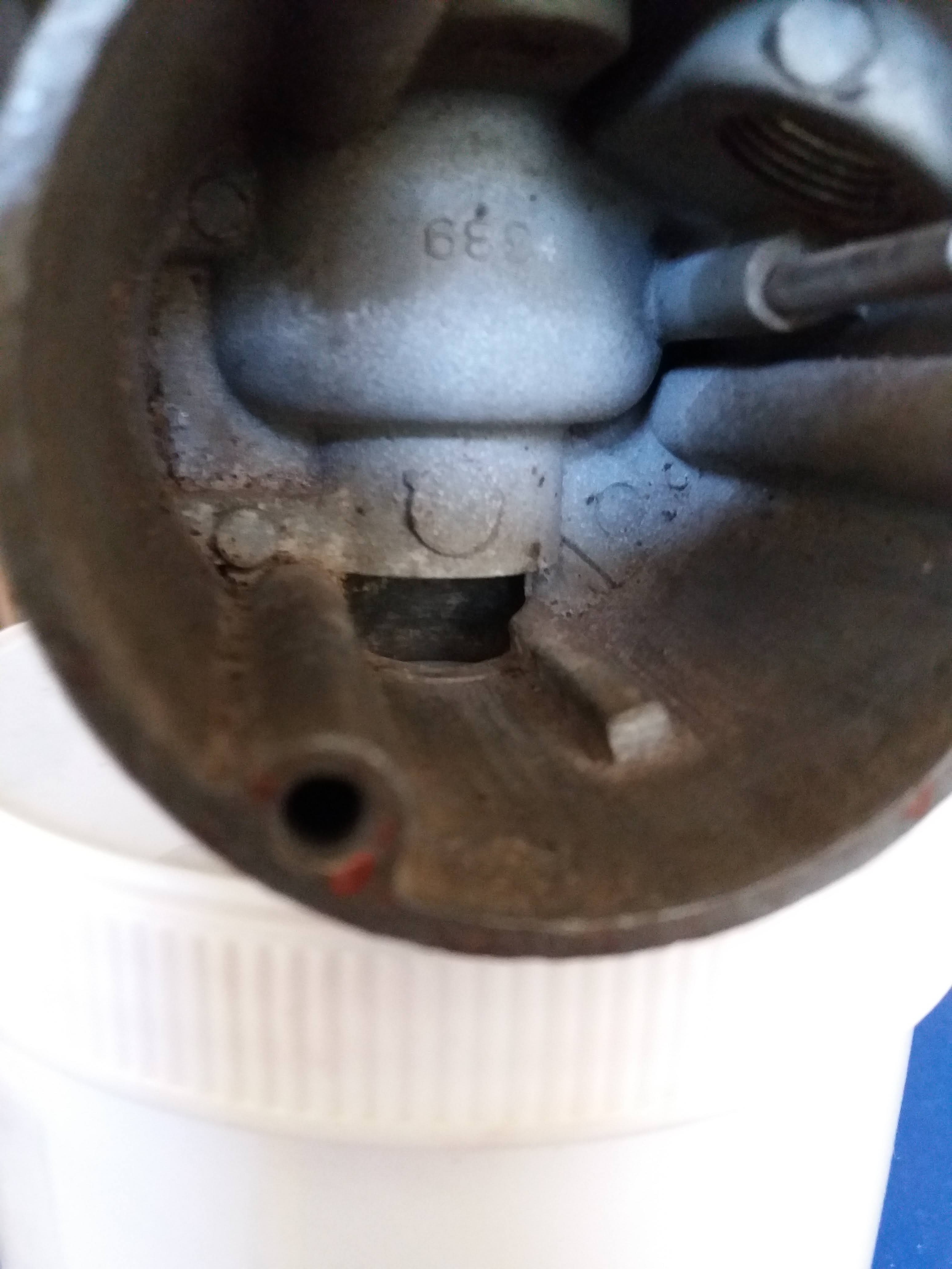

I’ll pull off the ignition switch and have a good rout around.
I have an Amal Monobloc. I just took off the big round end from the side of the float bowl and a large piece of the fibrous Sealing gasket was sitting in the float chamber.... now, I could have dislodged it when I removed the cover, but it was big, like over half an inch long by third of an inch.... I’ll order a kit and clean all.

A piece of that gasket loose in the float bowl, could well be the cause the fuel gets to the jet's through the opening at the bottom rear of the float bowl
If that bit of gasket was covering the port it would stop the fuel getting to the jet's
I think you have found it!
Just a bit of grease on the new gasket both side's and don't over tighten the screw's
Sorry I missed it in your reply earlier

Typical I have just tried to take a picture of a stripped monobloc and my photos are not appearing on my phone I will try again later
Dai
By Daiwiskers
#91034
Now it works! Technology be blowed
Note remanants (spelling) of red hematite
