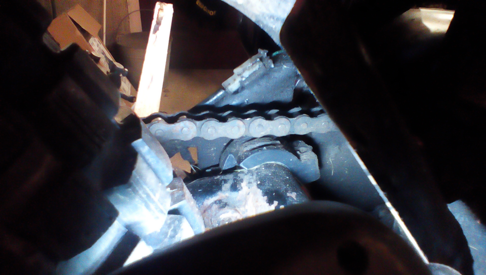

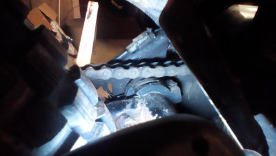

By philipw
#87344
Sorry for the late reply. I 3D printed the rubbing block from a plastic called ABS. It has got two grooves worn in it now from the chain. Nylon or Acetal would have been better materials. I will try to upload a picture. Hope this helps.
Philip.
By Daiwiskers
#87346
It will wear two grooves quite quickly until the chain has worn it down to the rollers, then the wear will slow down
Just like primary chain tensioner's
Hope this helps Dai
By McMurdo
#87347
philipw wrote:
Wed Jan 22, 2020 7:53 pm
A high-tec solution that I don't have, sadly.
How did you fix it?
Stuart
By philipw
#87362
Dai I think you are right the wear seems to have slowed down. To answer your question Stuart well I'm just keeping an eye on it.
