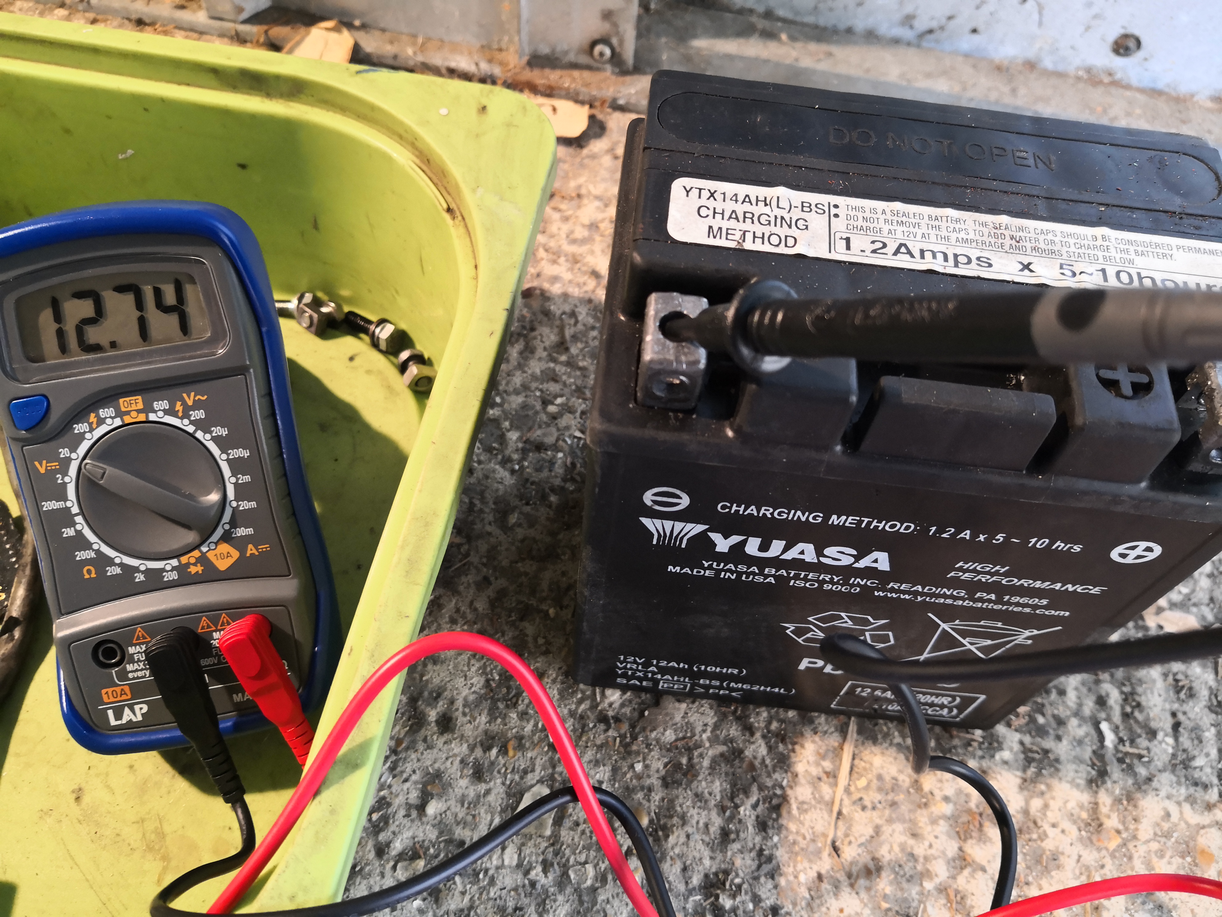

Went back to my bike where I had to leave it yesterday to collect the battery as not convinced yet that it is non functioning and wanted to test it and potentially charge it.
Voltage test from picking up today is showing 12.74 so getting the impression that isn't to shabby and shouldn't have brought every thing to a stand still yesterday.

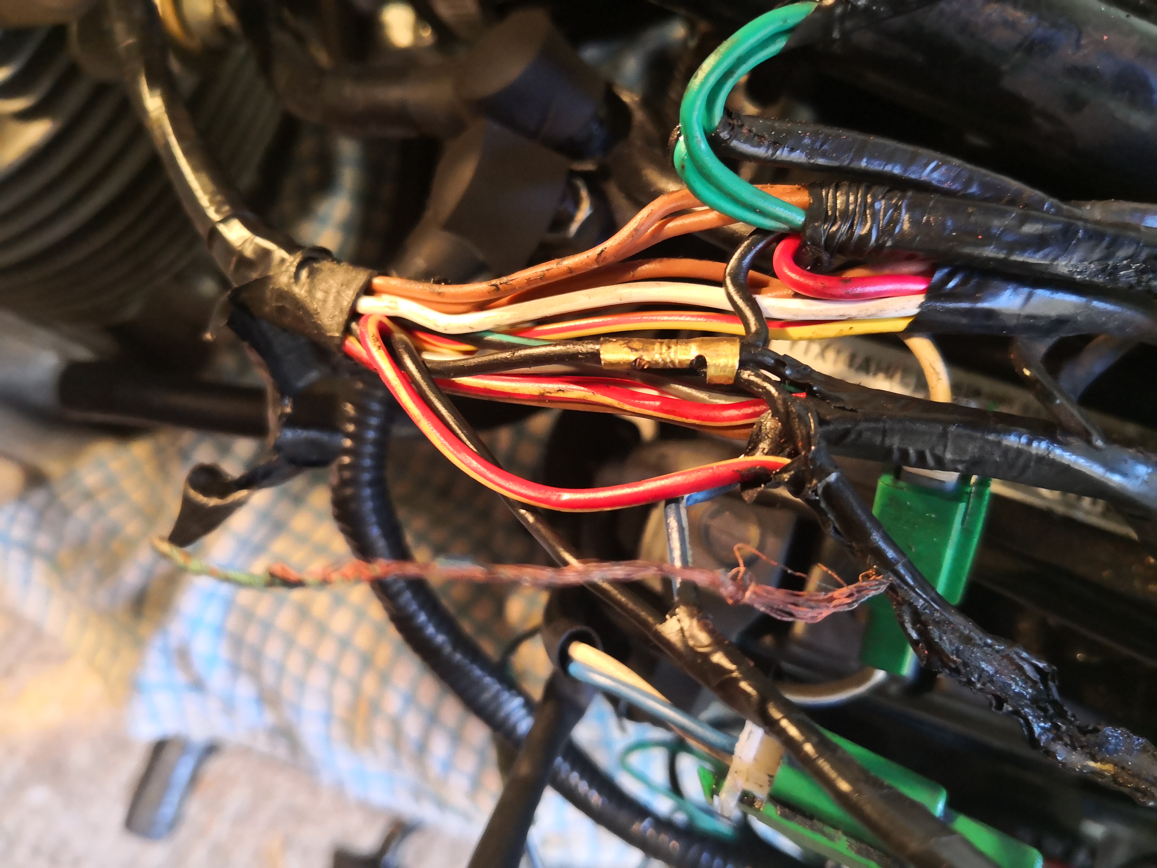

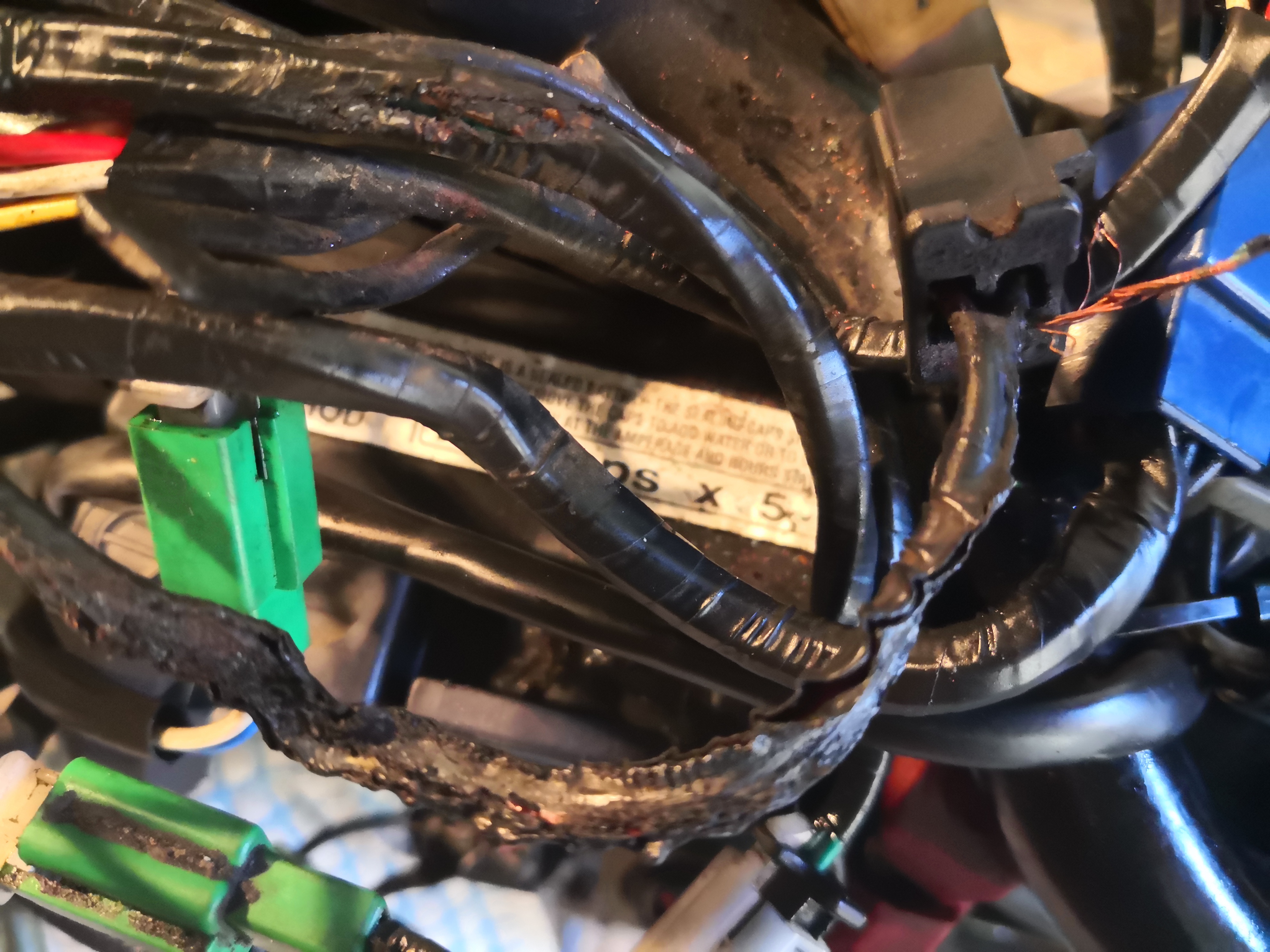

But I had some break through findings after a heads up about the regulator rectifier from Adrian and came across some severe melted exposed wire damage on the exit side wiring that would head to the battery not wiring from the stator to the regulator, looked a right mess, how I missed this awhile back is abit concerning, just good I don't look after airliners. It didn't look freshly exposed or burnt and the copper was oxidised, just was well hidden and camouflaged against the frame

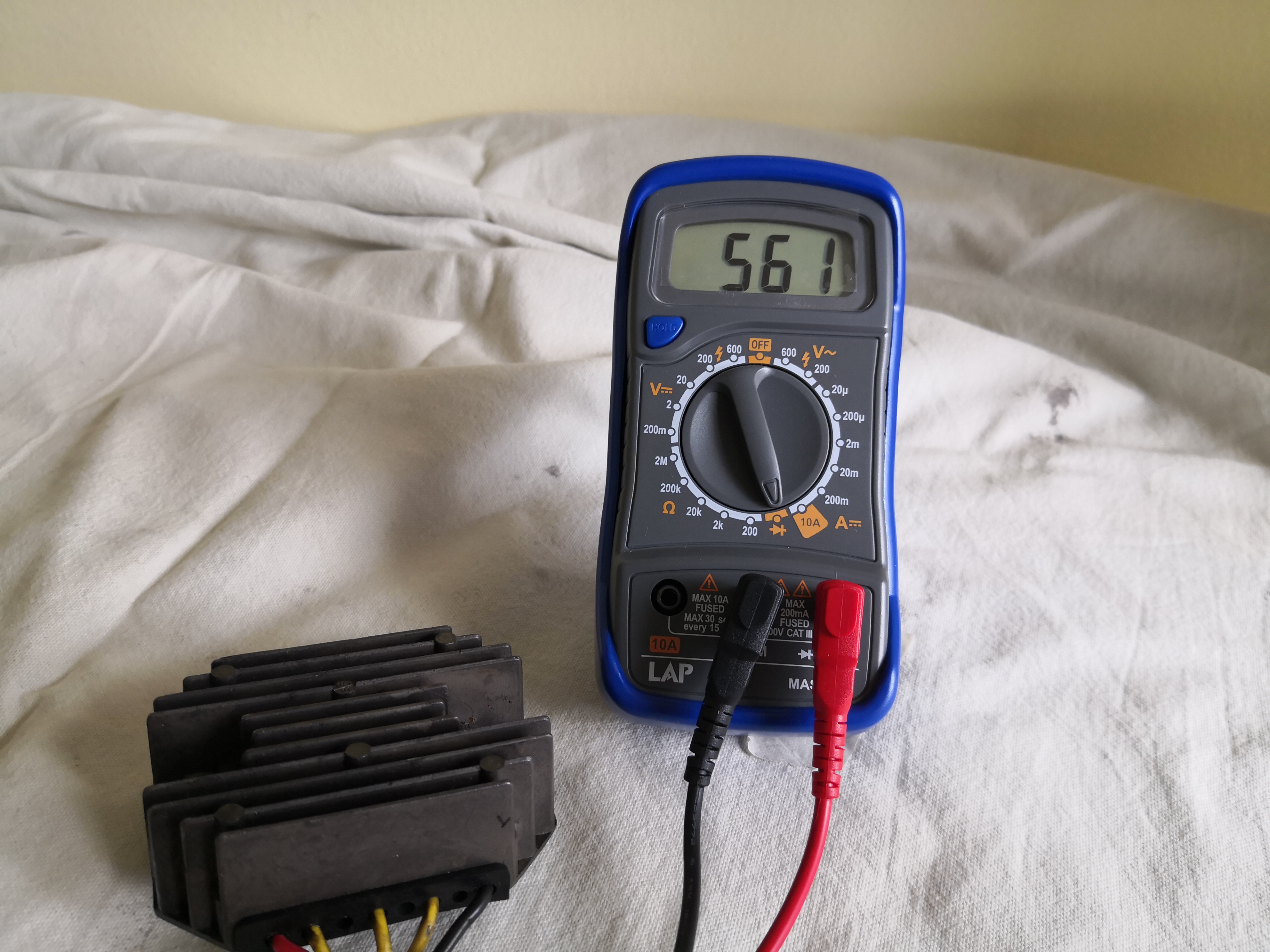

So I whipped the regulator off to to bring back home and test, took some guidance from Youtube on how to do this forward and back bias test, got these readings:
https://www.youtube.com/watch?v=-2jWIkhy1fo
Forward bias flow 561 for each connection (3 of them) is that a normal reading for a functioning enfield regulator.
Backward bias (3 of them) no reading

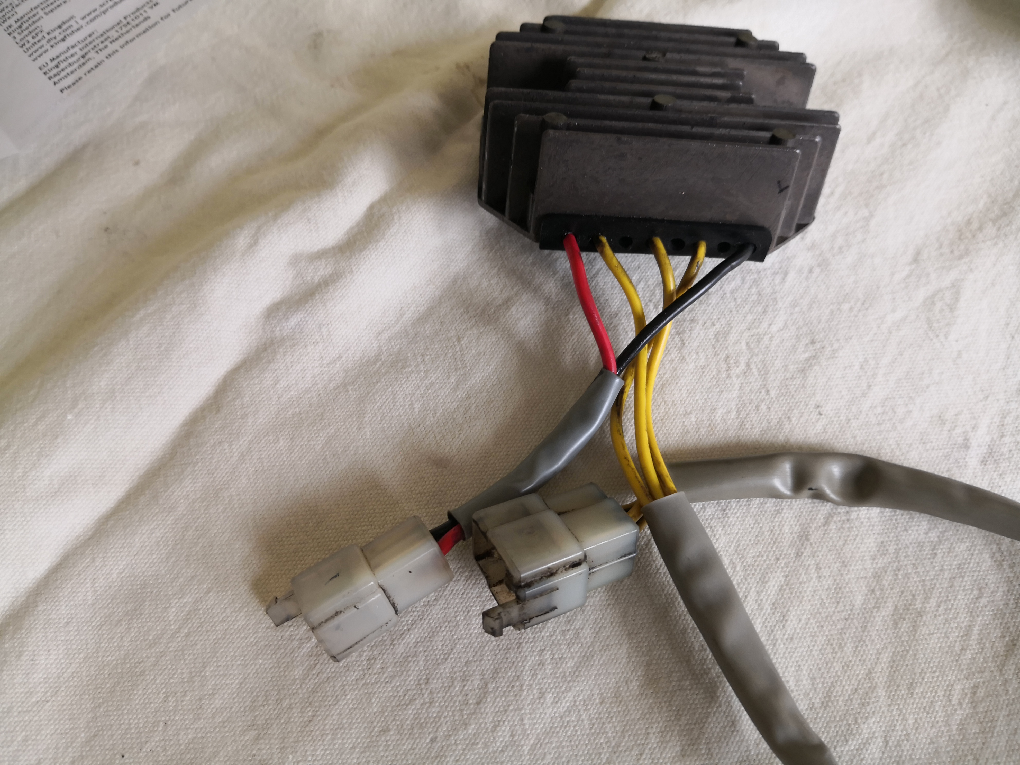

Not sure what's going on with all this, but may need to hard wire the regulator exit wiring if the regulator its self is still fine going by those readings as the wiring for a few inches ruined right into the male connector.
Regulator is still nicely intact.
In the pics black male connector with exposed copper went into the white positive / negative regulator connector. The copper wire was just still intact but looking a mess so have since pulled that apart and will hardwire.

That definitely (spelin) looks like a problem area
I'm not up on the standard wiring colours or the Reading's you should get when testing the reg/rec but someone here will know
Looking at that mess I would buy a new MOSFET reg/rec and do some rewiring

The fact that the bike didn't incinerate itself by starting an electrical fire near the tank is a bonus. My guess is that chafed/cracked insulation will have caused that little fry-up, but in such a way as not to blow the fuses, which is odd. If the reg-rectifier itself shows no signs of having cooked you might have got off this one fairly lightly, and a pleasant evening's re-wiring of the affected area should sort this out. I'd STILL be tempted to fit a new reg/rectifier, though.
Make sure you use some decent gauge multi-strand wire with a good amp rating, it shouldn't be too hard to improve on the stuff the factory used! I'm just to the west of Southampton if you want to bring it round.

Those numbers that I have in the multimeter for the regulator unfortunately don't mean much to me, not sure if that's good bad. Reckon the Battery voltage numbers look quite healthy, been off charge majority of the day and it hasn't dipped.
