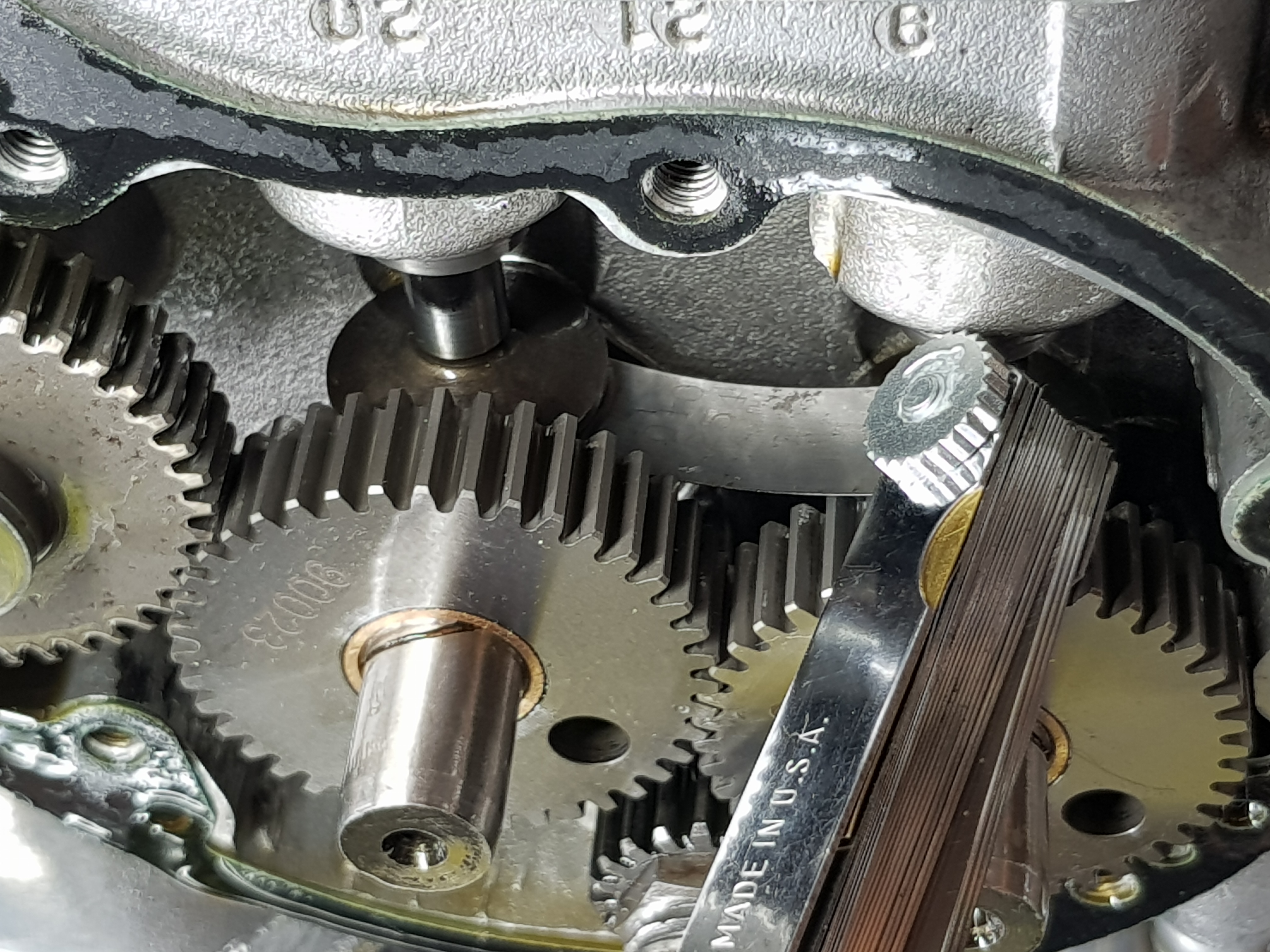

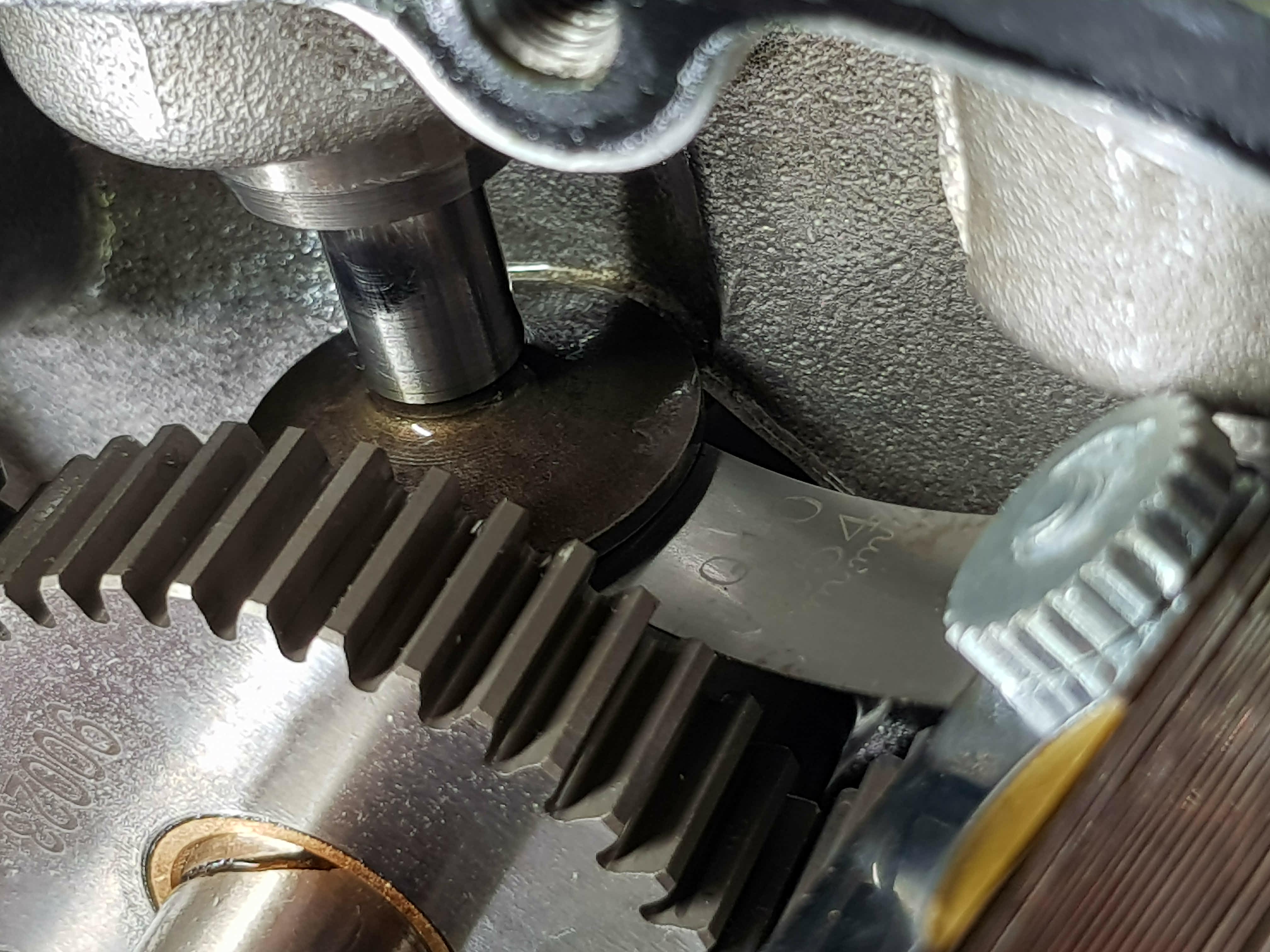

Gday SW
This post may be a little late, but if its any consolation, I had to clearance the case step for the 90023 cams, whereas the 200180s fit without issue.
Feeler gauge showed 10th interference.

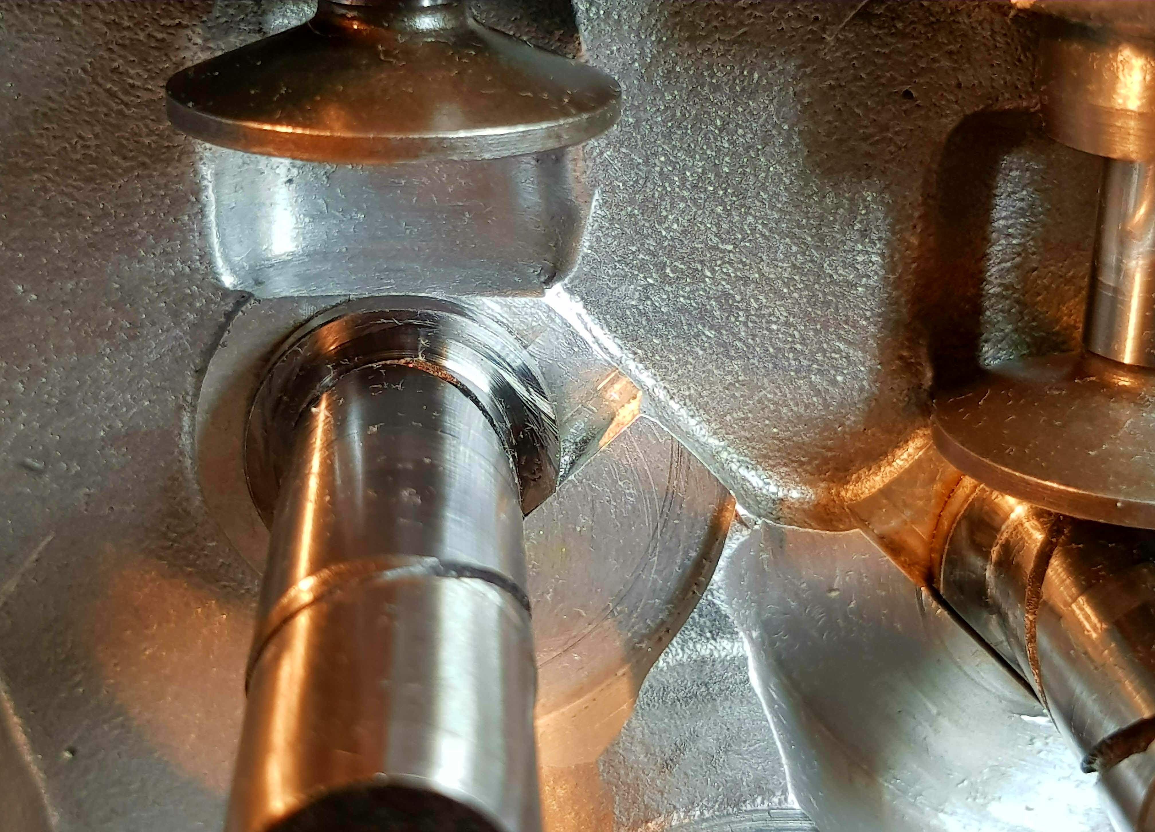

I dont have a "before" photo, but the top pic shows the hand clearanced step.
Regards
Paulie

Thanks for that. Yes, it's the 90023 I have. I've fitted a new pair of standard spindles, the ones that were in it seem to have been under diameter, the new ones were to drive in with heat.
It must have been *just* touching the cam and no more when I built the motor and a slight movement on the spindle took it to not having enough clearance.
So new spindles, new rods, carankcases relieved. Fingers crossed for road test tomorrow.
#99768
