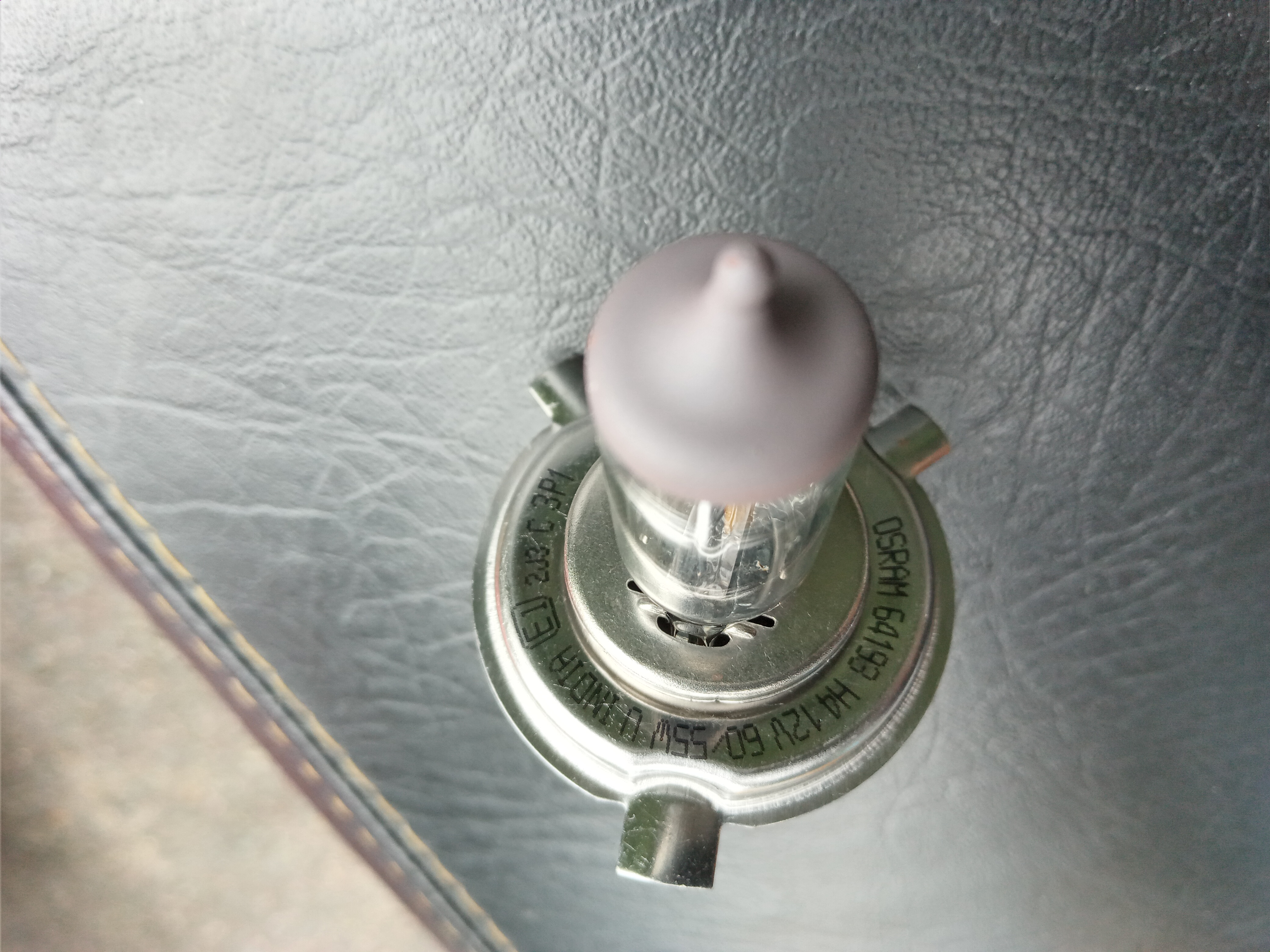

#98726
OK, so after scratching my head over this more times than it's worth and a final test, isolating the earth (original loom) at the bulb and run a direct earth (brand new wire double isolated) from the battery to the bulb earth terminal I get exactly the same voltage drop down to 12.35v headlight on. So this must mean that the original loom does not have a bad earth, my conclusion is that there is nothing wrong with the bike, only that RE have used an alternator not powerful enough to charge efficiently at low revs, rev above 1500rpm and the thing starts to charge. I'm going to try a led bulb, hopefully the voltage drop won't be as dramatic and it runs more reliably. I appreciate all the advice, gonna have to live with it, no headlight, no problem.
