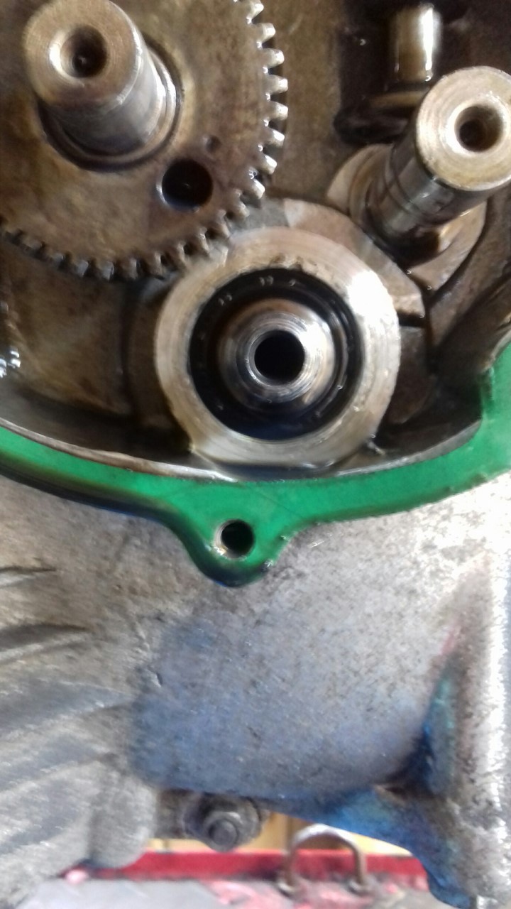

#96585
The timing chest should always have oil in it while the engine is in running condition, even when the engine is stopped, as the cams and the follower bases run in the oil that comes down from the rockers, that oil floods the timing chest, with the overflow returning to the oil tank, that's how it's meant to work.
You do NOT need to split the engine to replace the seal behind the crankshaft timing pinion, you just have to remove the timing cover (with something underneath to catch the oil, of course!), undo the worm nut (left-hand thread, remember) that drives the oil pump spindle and then remove the timing pinion itself, which might need one our hosts' extractors.
The seal needs to be fitted with the spring and the lip facing outwards, smooth side towards the bearing, it could possibly have been fitted incorrectly. It's not a large item. 30mm outside diameter, 20mm inside by 7mm thick, but the lip of the seal has to sit on the end of the crankshaft or it won't do any good. Another possibility is that the recess for the seal isn't machined deep enough, you can always try a thinner seal, i.e. 5mm thick instead of 7mm.

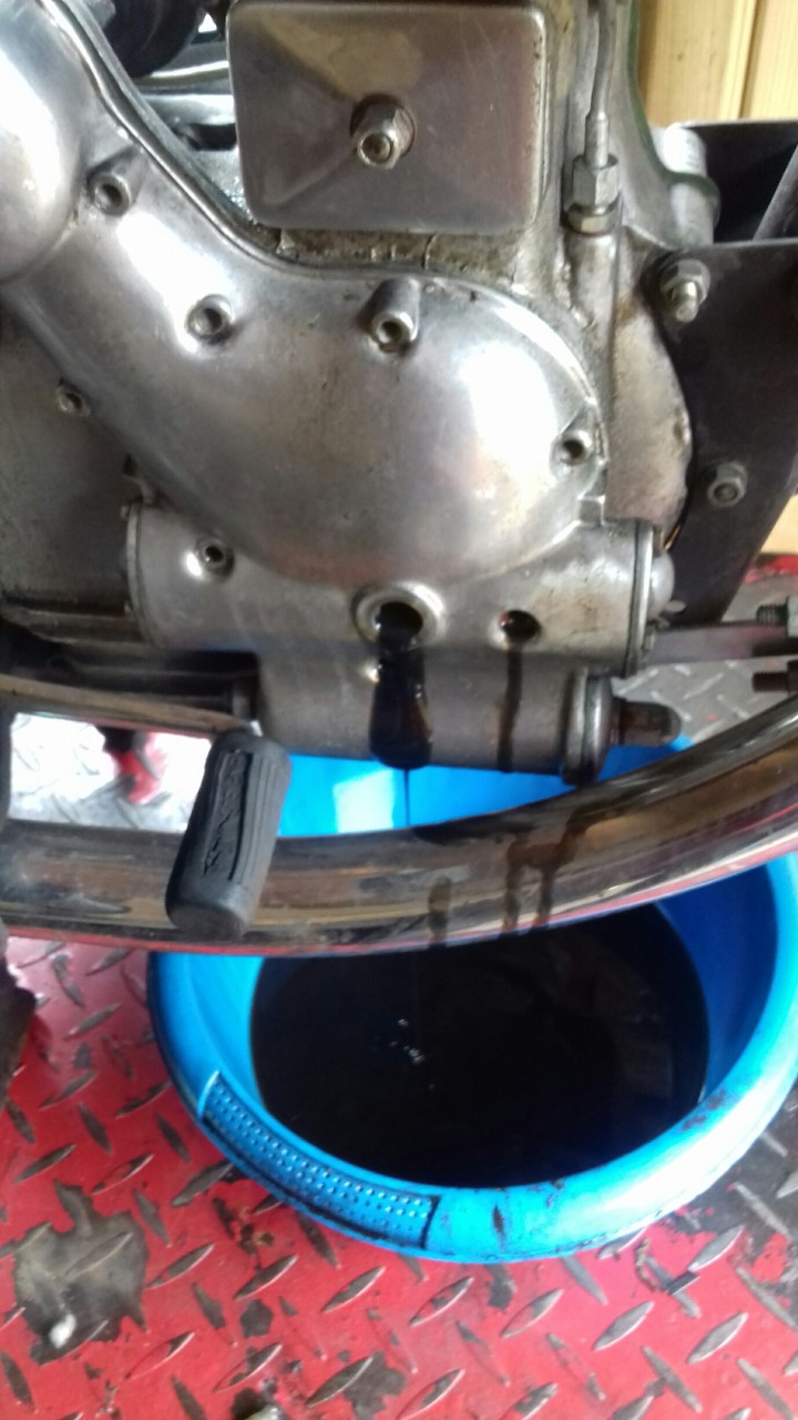

But before you try ANY of that, you can simply undo the scavenge strainer plug (the front one) under the engine before you start up and see if you get any noticeable amount of oil coming out after the bike has stood overnight. If it's all clear, then wet sumping is not the issue and you can leave the crankshaft pinion oil seal undisturbed.

#96745
Okay, inspection time. there was quite some oil flowing out of the quill bolt..
And indeed, i mounted the oil seal wrong way around..
@AdrianThanks for the tip!!
But.. how to extract it??
Edit/ I inserted a wood scew (such a point one) anw with a jerk with pliers it came out!
