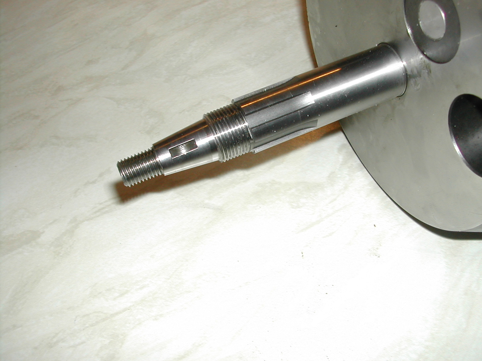

I don't know about the crankshaft but it is quite likely to be different;
It is. On the TCI bikes, mostly Electra-Xs in the UK, the drive side mainshaft has a thread for a nut to hold the engine sprocket on (rather like the pre-alternator Redditch Bullets), then a tapered end with a 12mm (I think) male thread for the alternator rotor and its securing nut.
The timing on these is fixed, though our hosts sell stepped alternator keys to give you a few degrees variance in either direction.

Yes, the crank in my engine looked like that ( I don't actually know what a points engine crank end look like because I've not had cause to dismantle one and possibly never will :( ).

Our hosts' stepped rotor keys were developed in response to concerns that some of the factory keyway machining in the drive shafts was off by a few degrees, with over-advanced ignition and pinking troubles as a result. A corrective rather than a tuning measure.
