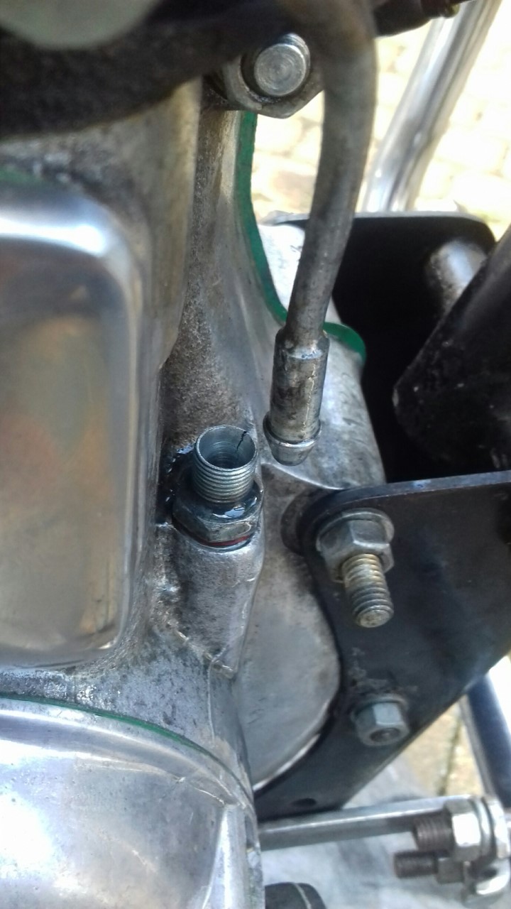

I'd be tempted to de-grease, apply some flux then heat and cool it with it loosely assembled on the bike. I have visions of it all falling apart if you try to re-solder it on the bench.jawa-enfield wrote: ↑Sun Mar 07, 2021 11:58 amyes of course... Thanks for the lapping tip!
Also the feed pipe seems to leak a bit at the junction.. Cannot really se a tear or something, If so i could try some soldering..
