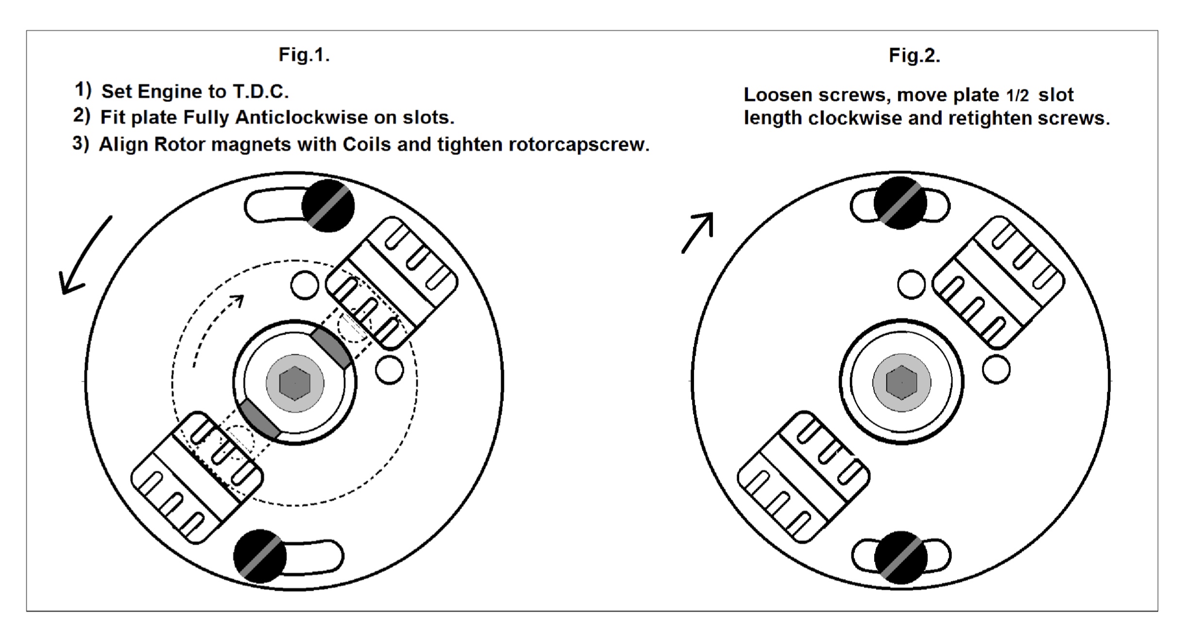

Which way to rotate the back plate on the Boyer plate, gives advanced?
By windmill john
#95490
Many thanks for that. I’ll mark where it is a try a little clockwise. I guess I’ll know if I go far by the knocking!
