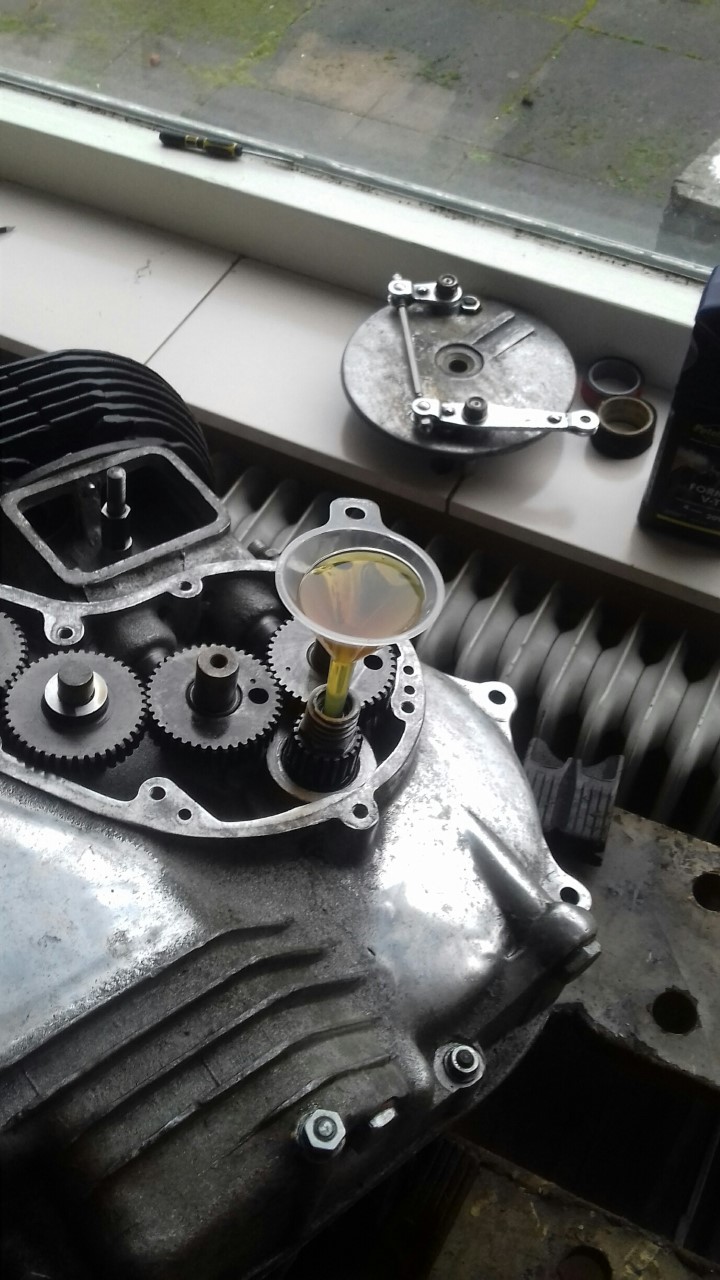

#94893
Priming the crankshaft and sump very slowly.. I worried a lot for a moment when the crank moved a little inwards when a layed the engine down, but then remembered this was also the case with my BSA, and the central generator nut will pull it to the right.
(besides, used all the spacers, bearings are in place, but.. argh insecure moment)
