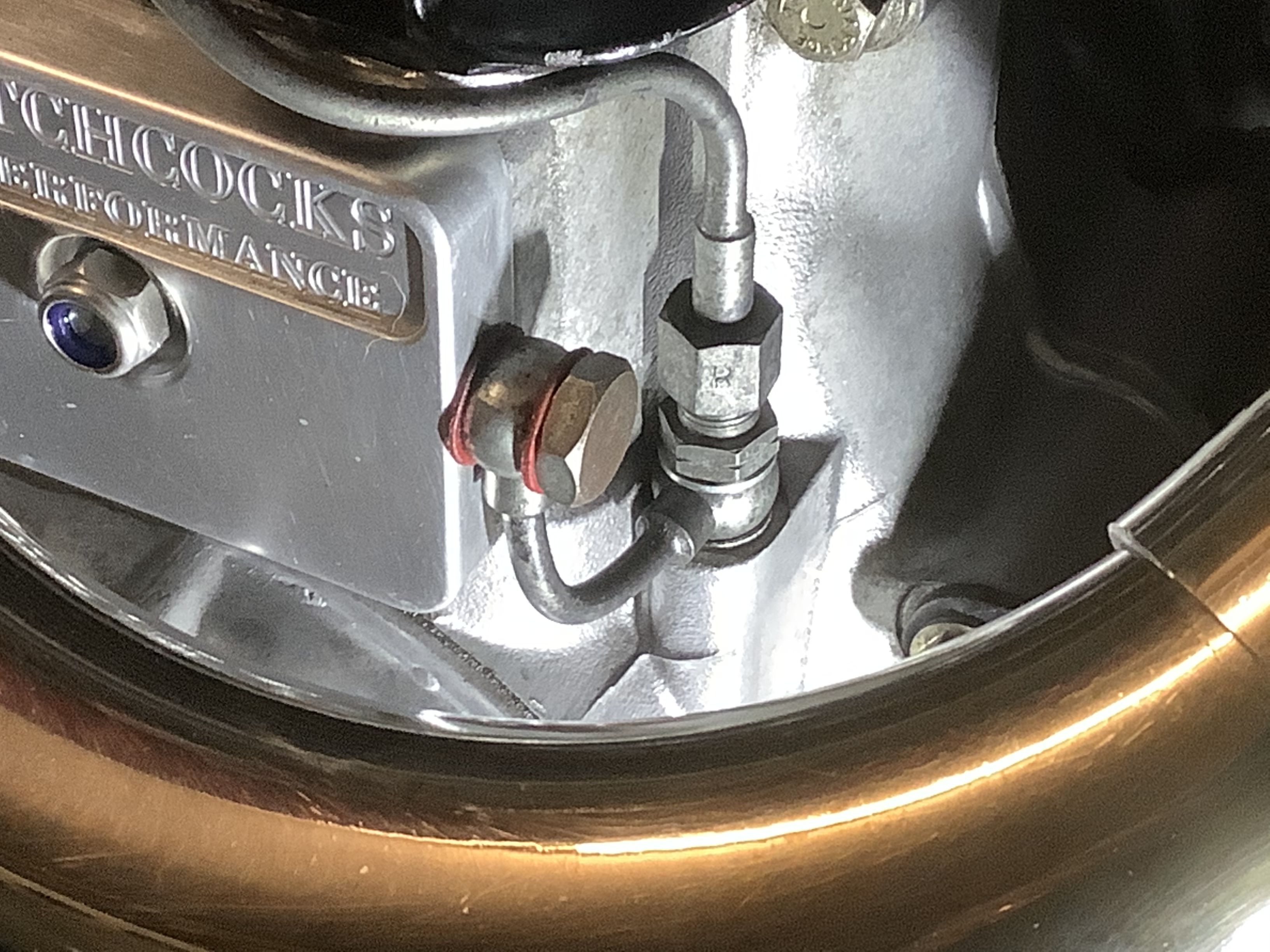

Hitchcock's do of course sell their after-market Pressure Relief Valve assembly.
I fitted one to my home market 350, which has the standard piston type oil pumps and the floating bush bottom end. I've found that the PRV does seem to pass a lot of oil, more than I'd imagined it might. These days the bike doesn't burn a lot of oil; maybe the PRV helps by limiting the amount oil in the cylinder head casting at higher revs but it will certainly off-load the pump and drive components.

The Hitchcocks' pressure release valve is for the SCAVENGE side. This won't have any effect on the FEED side as the PRV valve here (if there is one) is actually fitted in the timing side main shaft.
You'd have to check with our hosts or a Chennai Bullet expert about which years' Bullets would have had them fitted from the factory. Redditch Bullets have them.

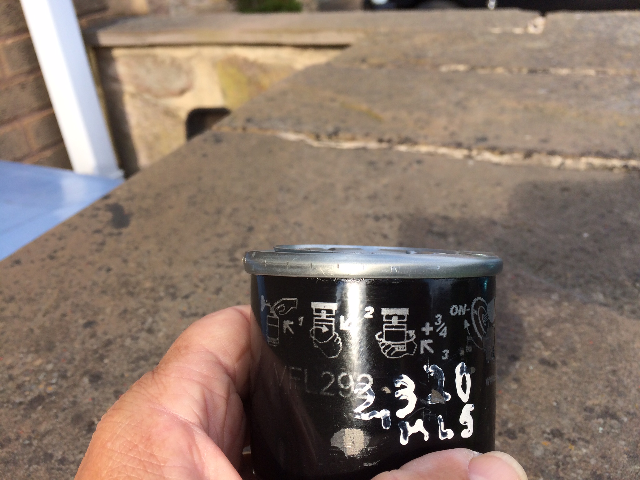

;) I’m very much aware of that - I fitted it myself and it’s very obviously fitted in the external scavenge pipe to the top of the engine. My point is that the rockers obviously don’t need as much oil as even the standard piston pumps can flow. The scavenge pump can only scavenge what the feed pump provides and with a floating bush the standard piston type of pump is obviously more than sufficient. Any more flow won’t achieve much but without a relief valve the scavenge pump will put unnecessary load on the drive quill because it is still actually a pressure pump, albeit to the rockers. I can’t actually think of another engine I’ve worked on that doesn’t have a PRV.
I saw first hand how much pressure an oil system can produce. The PRV on my little Suzuki 1.0 engine jammed shut and the pump produced enough pressure to blow the external oil filter canister up until a couple of spot welds on the base of the case popped and the O ring seal blew out in the car park of Cotswold Aerodrome. I had to pay for the clean up on the new tarmac.
