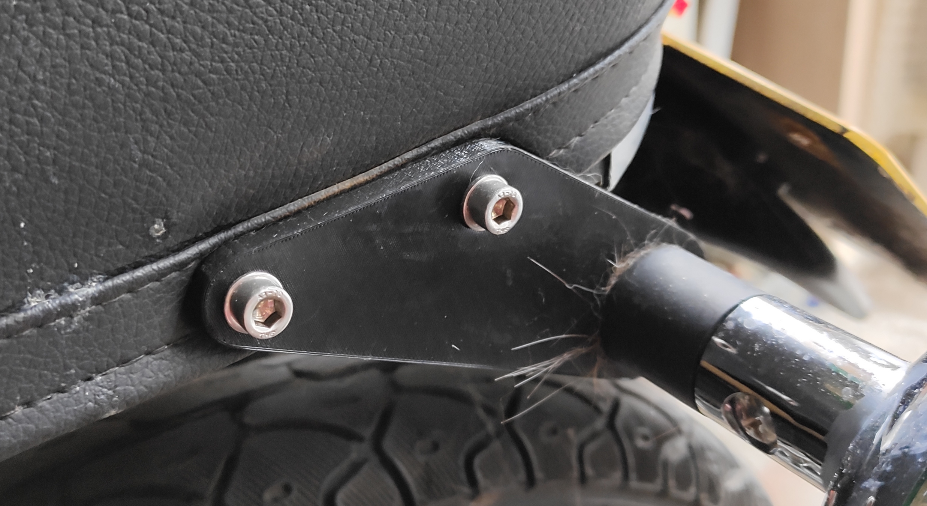

I've been 3D printing for 10 years now.
I've printed indicator brackets for the RE, fan reducers for my car, dash clips, switch blanks, badges...
I looked into using them to make blanks for casting but casting requires more gear than I'm interested in investing in :?
(Ignore the cat hair!)

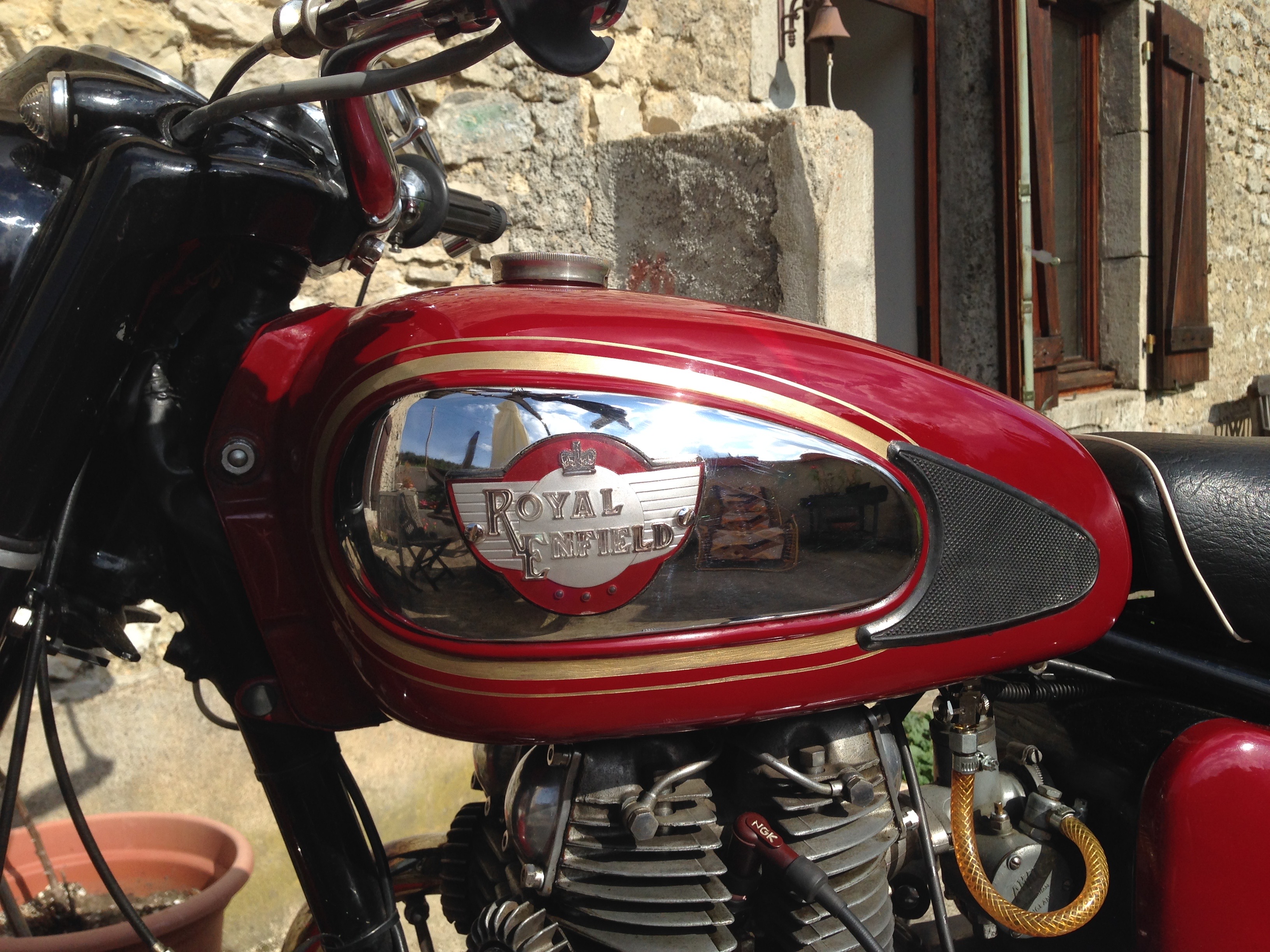

Those rarely seen Maroon 1950's plastic tank badges, that would be something to 3D print…

Scalyback wrote:Those rarely seen Maroon 1950's plastic tank badges, that would be something to 3D print…
Printing a badge is easy... drawing one is a wholly different ball game! I have a basic 3D scanner but I've never really played with it. :?
I'd have thought that taking a mould of the tank badge and casting new ones may be the way to go?
