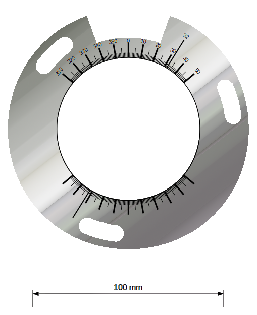

Considering doing a proper drawing for a degree wheel that can be laser cut/etched from stainless or aluminium and bolted to the stator mounting studs on a lucas style stator to make use of the markings on the rotor. Then the standard stator nuts could be replaced with sleeve nuts so the degree wheel can be bolted on. Way more accurate than messing with one of those measuring things that goes in the plug hole or trying to get a pointer in place and bolting a disc down to the rotor without it moving. My ersatz cardboard effort made the job really simple and gave good dynamic timing points. If I go down that route, I'll get them to do several. I'm surprised one doesn't already exist considering these alternators have been out for over 40 years.

As an aside, I'm now actively looking into getting something like this made up from stainless or alloy. It could probably be left permamantly attached once it's dialled in (pending prototyping to see if there's enough space under the primary cover) and would take all the guesswork and fiddling out of the job.
If I go ahead with it, I'll get a few made because once it's set up, making extra ones isn't all that expensive. All very much at the concept stage for now though. I'll need to learn how to make a proper CAD file among other things.
degree wheel.png (129.48 KiB) Viewed 7919 times
