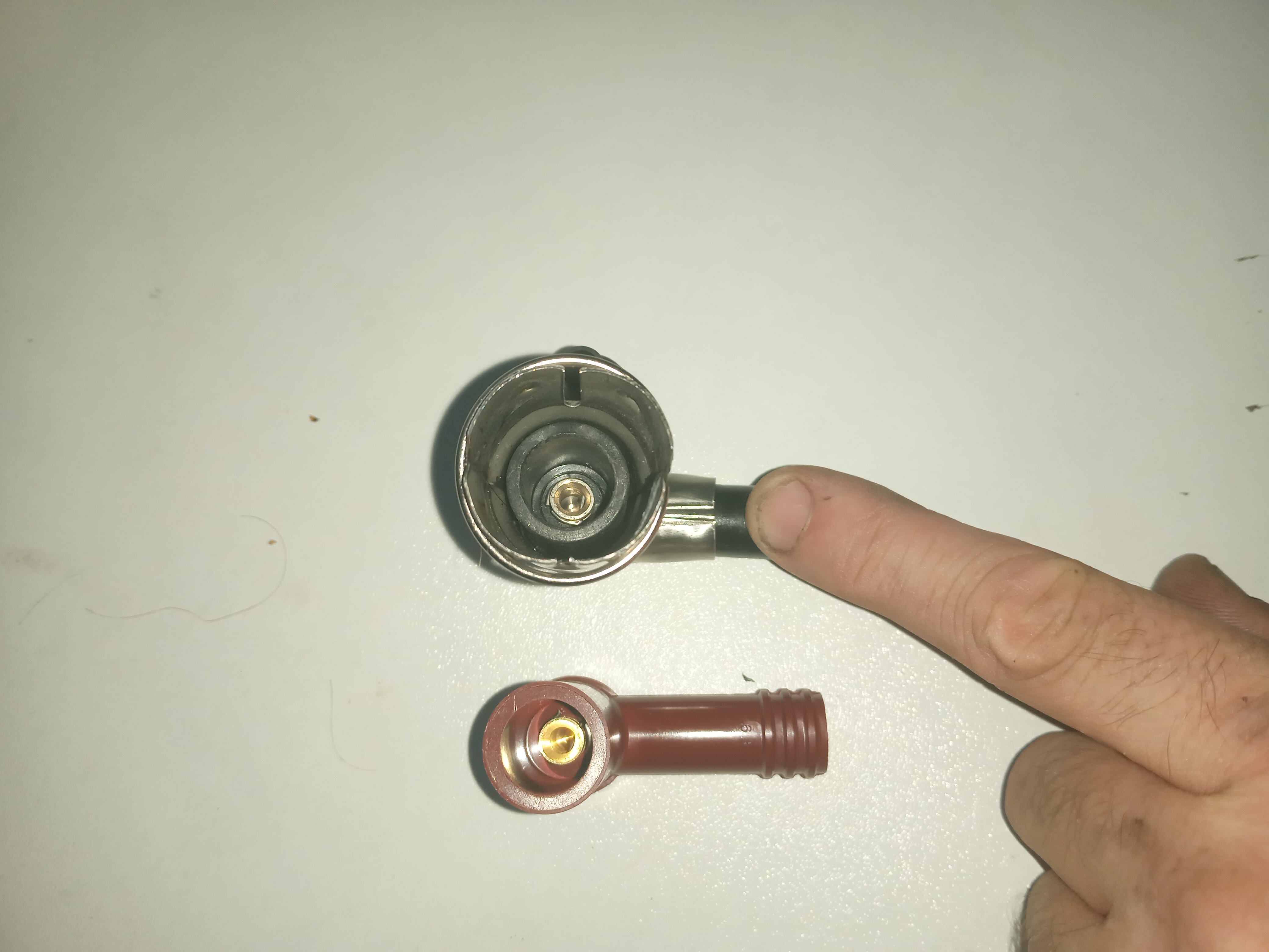

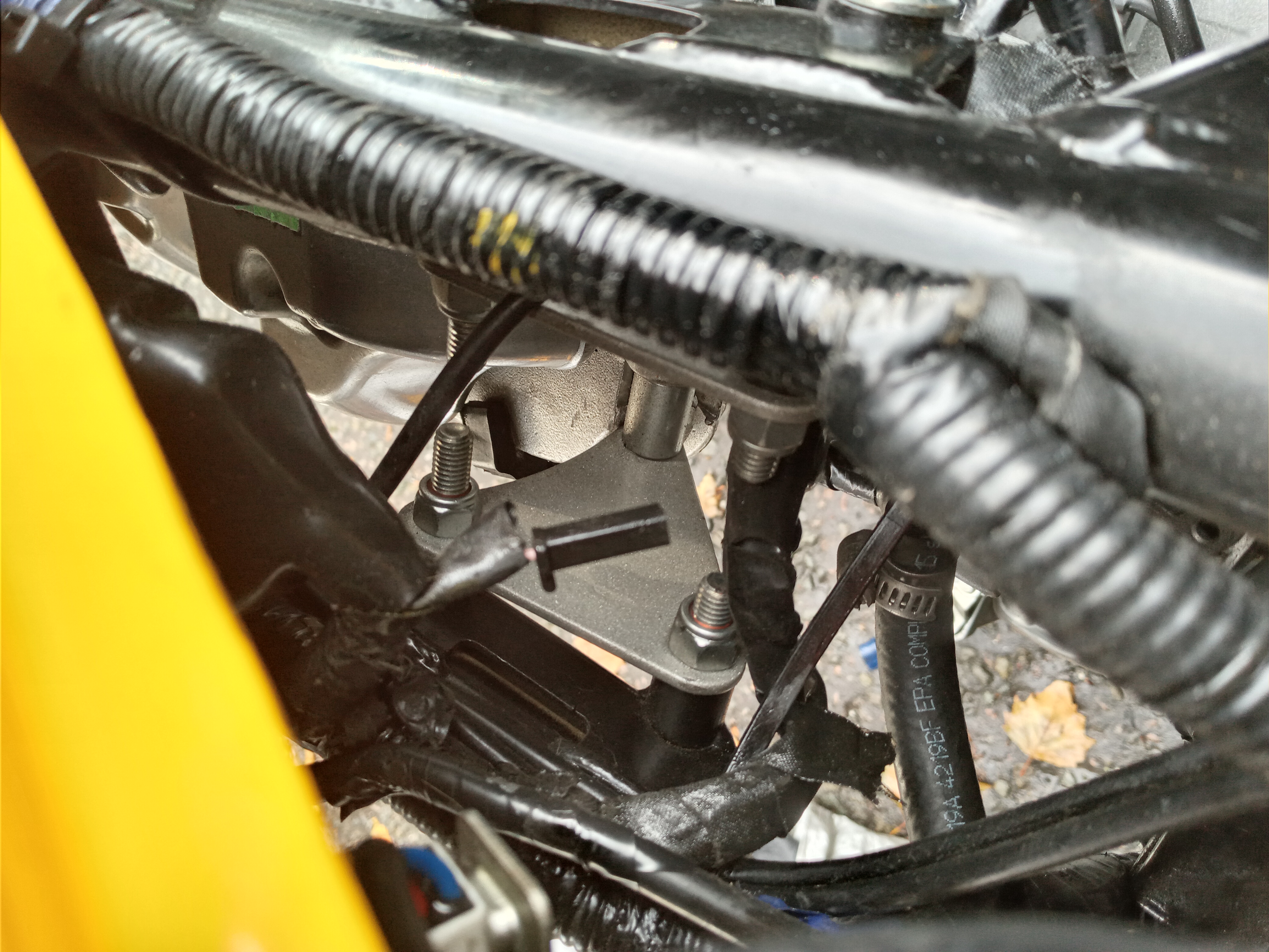

NGK plug cap fitted today, I also took the chance to look over the loom, particularly around the headstock, under the tank to the fuse box, nothing really of concern no kinks or chaffing however I found this terminal loose, I cannot see where it would connect to? Seems odd to me o be floating around doing nothing, I'm going to go through the wiring diagram to check things out.

Under the tank above the efi body, looks like single connection, not a port. Also axls a note, the NGK plug is far superior in quality thatn the oem RE cap, copper core and just better fell to it, £3.75, cheap as chips.

Yes, that connector is the ecu mil check wire. You earth it and then switch on the ignition, after the initial boot up, the mil will flash a series of long and short flashes to indicate any new or old fault codes.
As well as the crap oem plug cap the ht lead need put in the bin as well.
A nice bit of copper core lead is cheap enough and screws into the coil the same as the cap.
