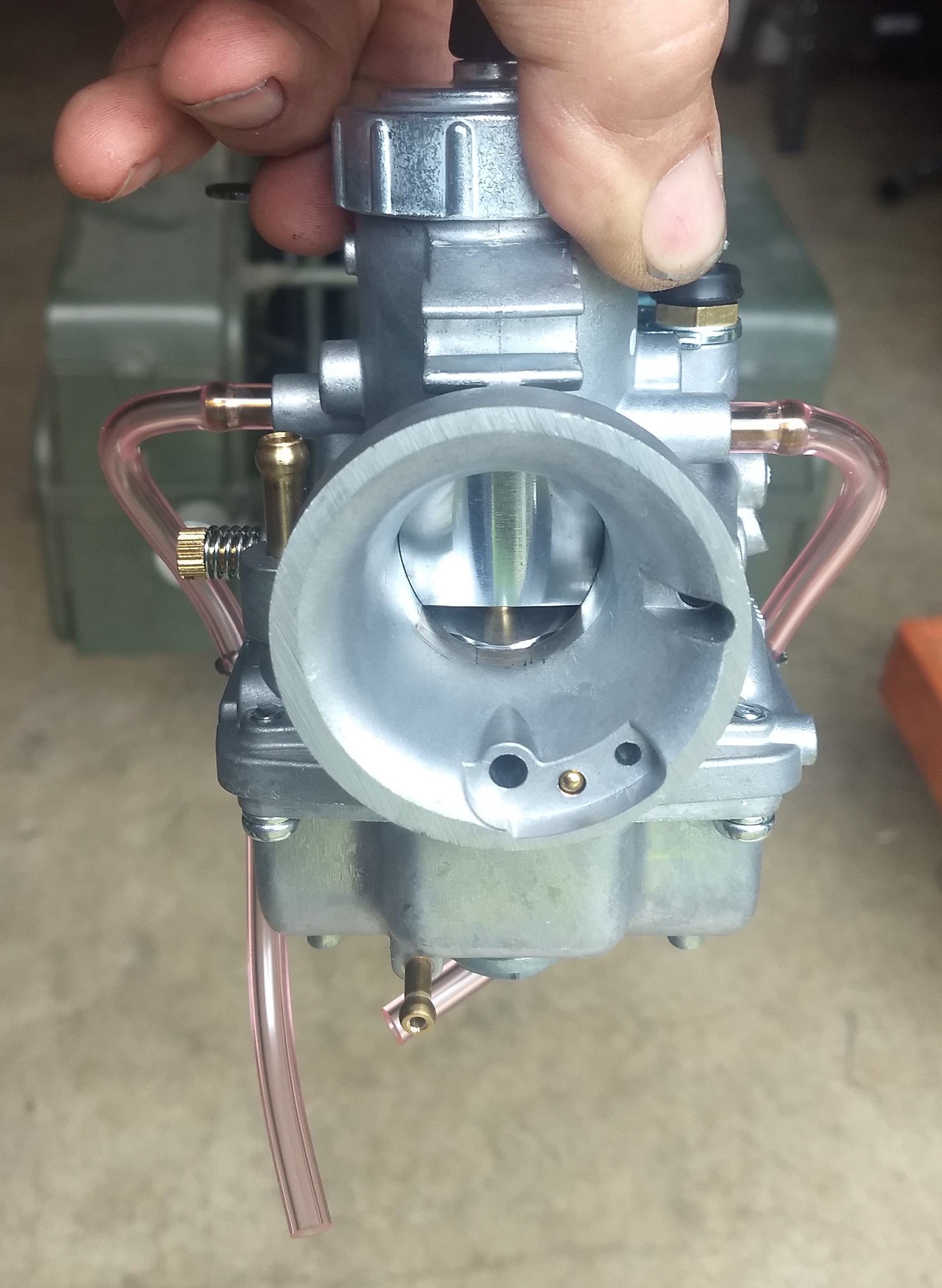

Sent them the question, but received no reply.
Upon disassembly to document jet, needle & slide numbers it was obvious both tubes are atmospheric vents for the float bowl and shall be extended and remain open .

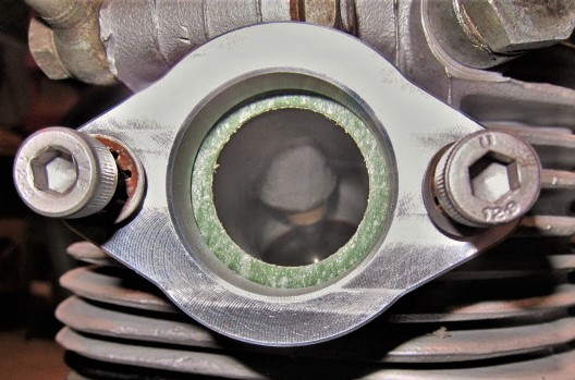

Installing the Niche 30mm Mikuni conversion kit on the 2000 Bullet 500.
Carb ID: 1.028
Rubber Boot ID: 1.449
Aluminum adapter ID: 1.458
Head & gasket ID: 1.298

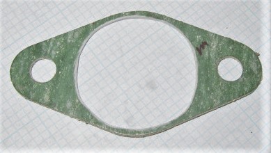

Leave the gasket at original ID (same as head port) & risk erosion or increase the gasket ID & have possibility of loosing the thin edges to backfire or normal use?
#98666
There’s absolutely no point fitting a larger diameter carb if you’re going to fit a restriction in the inlet port.
The cut down gasket looks a bit delicate; if that was my bike I’d make a gasket from some gasket paper with a larger external diameter so it has more strength.

By Rex Piekarczyk
#98668
Wheaters wrote:
Thu Oct 21, 2021 5:55 pm
See the listed dimensions. The head port is already larger than the carb throat, and there's no room at the top for more gasket, it's right up against the motor mount casting. Military steel air box and stock exhaust retained as owner's preference. I'm not in the position of determining the extent of modifications, just trying to get help owner get through this detail. I have a fab shop and would prefer to mill a new adapter with the same ID as the head port. Going to propose that at the next opportunity.
By Daiwiskers
#98669
New adaptor seems like a good idea maybe even taper it so it matches head and carb? Nothing beats a smooth airflow
