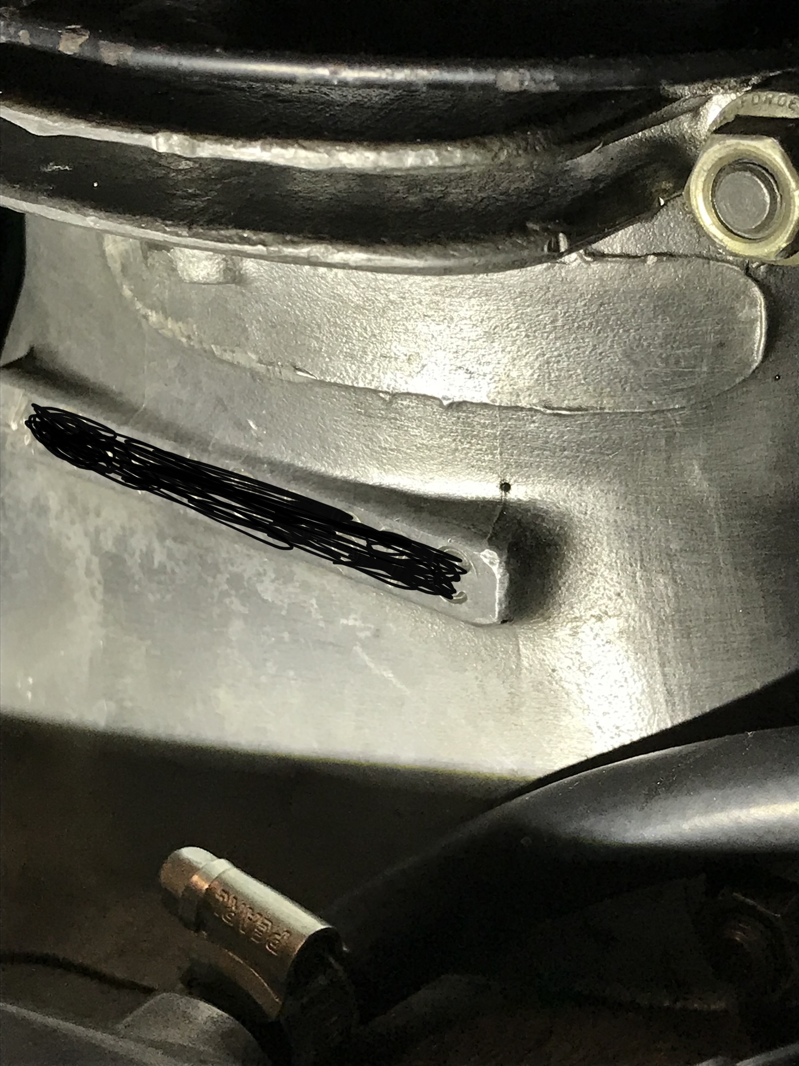

#96279
The small bulge is there but I see no point in putting a file to it!
The outline can be seen here:

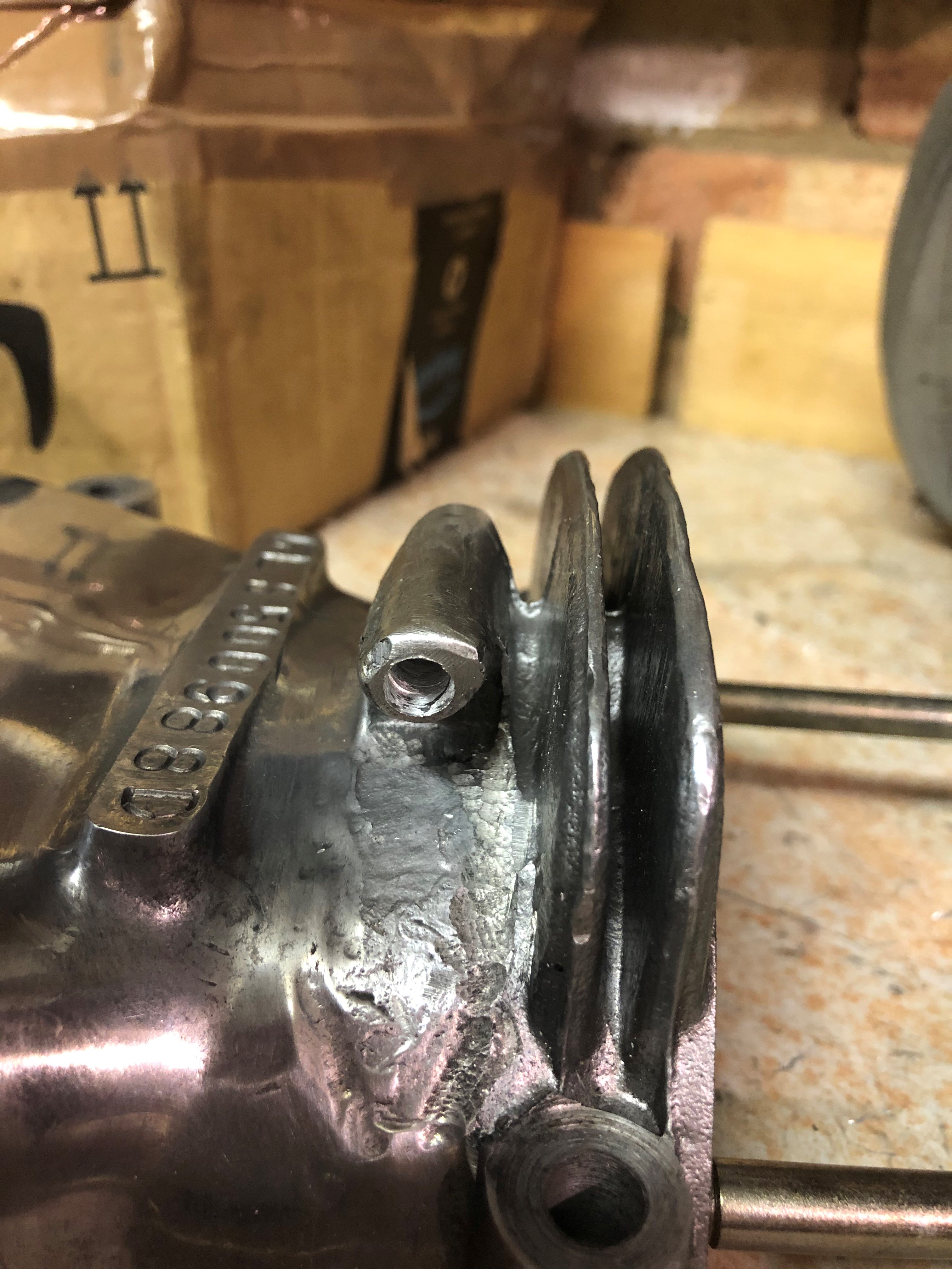

By Allanfox
#96289
and here is a drilled one!
