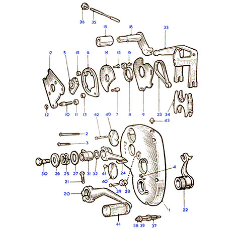

Report; Rotated the lid on the mainhaft 180 degrees so that the recess is on the left side (Tip form German bloke) but.. this only gives room for UPshifting? And not for downshifting?
However, twisted the 'repaired' detend plunger thighter (ordered a new one, it is not secure anymore) and for 4 to 3 goes!!
But, from 3 to 2 is still impossible..
It does not get enough movement.
So..
Maybe rework nr17 so that more movement is possible? (But what is then the effect on the other gears?)
Also, when removed the detent plunger, i can move part nr 33 a little to the left/right with a screwdriver.. something has some play.. Could that be a/the problem?

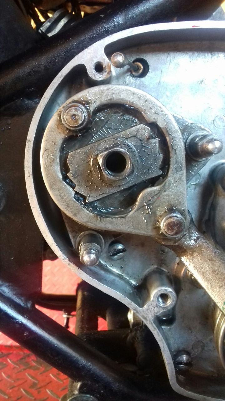

Some additioonal info; The ratched has a little play on the square spindle (actuator shaft?)
Further; with the detent plunger removed you can see that the shifting bell does not move enough down.
Despite all manuals, rotating the adjustor plate has not a single effect.
As if the ratched is 1 tooth too late? Despite the mechanismn is pushed against thge stops...

It has just struck me, looking at your pictures, that you may have the alloy cap over the mainshaft bearing the wrong way around - they usually have a bit by one of the bolts ground away a bit, to allow the required movement of the gear change mechanism for down shifting. It may just be a matter of slewing the cap around by half a turn, to allow a bit more movement.
#95549
Dear Folks
The alloy cap was indeed 180 degrees wrong, which can possibly give trouble in upshifting. This was not the case but mounted it the correct way anyway. (because of previous problems with the gearbox, such as hole for the bronze bush was not in line) an expert in these gearboxes offered to mount it together and adjust it. . i assumed/didn't notice the alloy cap)

I can only think of one object that in any way resembles a plunger in an albion gearbox. There is an eccentric ratchet mechanism for rotating the gears into position and there is a plunger detent that locates into notches in a very roughly made gear position arc to hold them there. A lack of pressure on that detent plunger might stop a gear holding in the correct position but it shouldn't prevent it shifting.
The picture 6 posts up from this one shows the selector ratchet mechanism.
