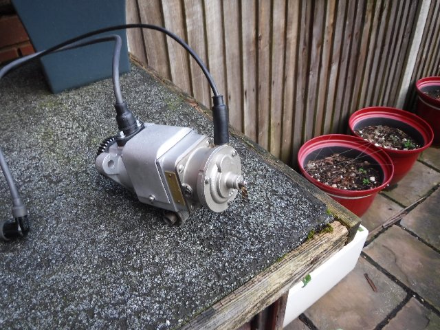

Cranky,
I've never worked out HOW the electronics in a suitably equipped TCI (Or CDI) box manage to vary the timing with nothing more than a button or strip of something whizzing round on the outer edge of an alternator rotor to tell them what's going on (ignore ECUs and TPS for now), I'm just grateful that they DO, even if it's all techno-voodoo to me.
For my (sort of) Electra-X based project I've decided to adopt a slightly different approach, not sure how you could fit one on the UCE engine.
