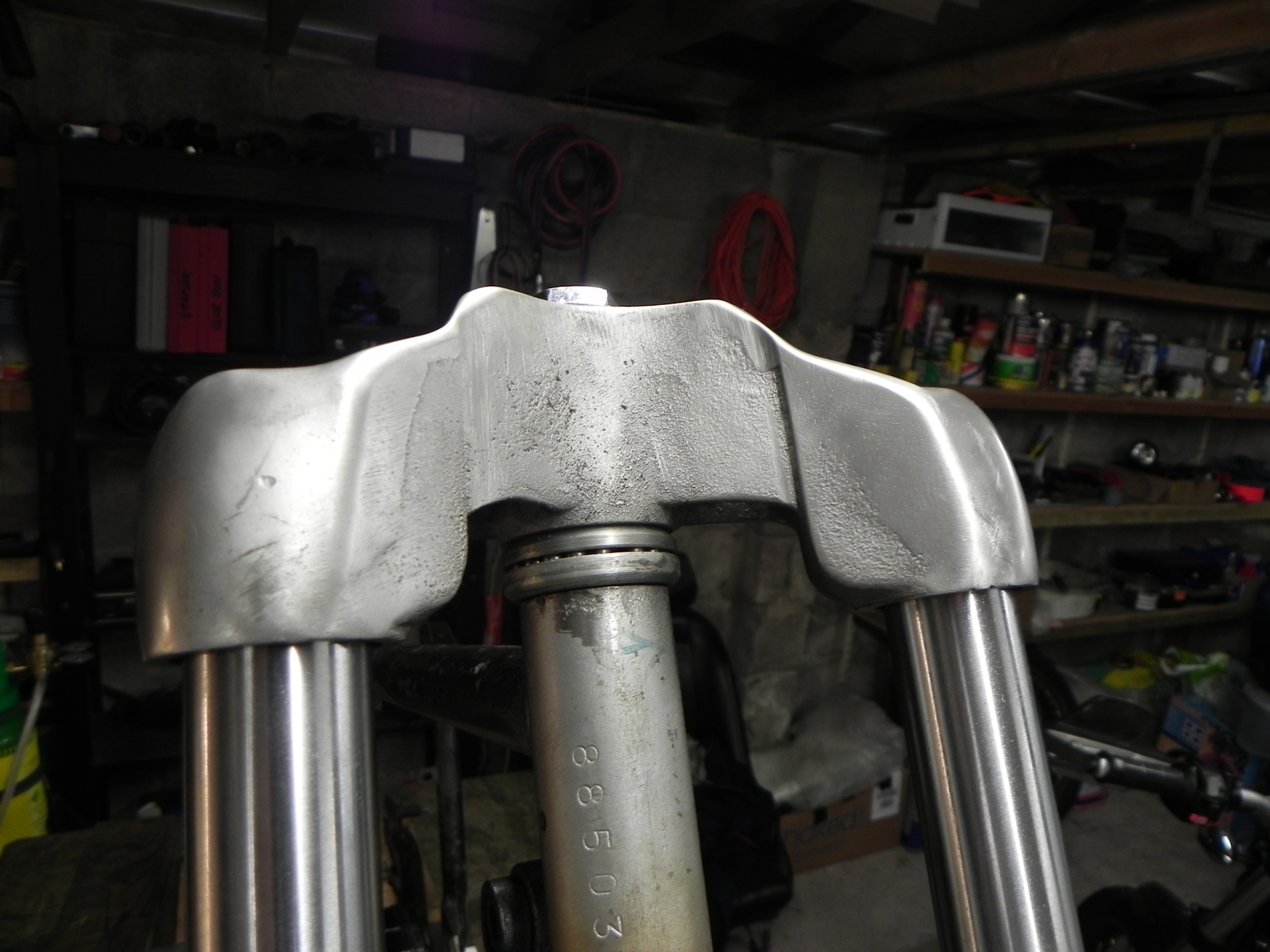

Top yoke PART No. SPECIAL35878 is cheaper and you can cut off the speedo hoop, ali rims ( 21 inch front) ali tank, ali or plastic mudguards, small non sprung trials seat, drill all the bolts, ali bodied shocks, ali engine plates, loose that rear frame, 1/2 width ali rear hub with ali sprocket, Continental GT swingarm, 520 chain and sprockets, smaller battery?? the smallest LED rear light you can find with a plastic mumber plate bolted direct to the mudguard, fit the smallest headlight you can find, ali levers and a Crusader frame. Every little helps as they say at Tesco! Oh and drill holes in everything.

Hi, Alloy rims, hollow out all bolts, alloy engine plates. Look at each item and ask yourself how can I lighten this. Just by removing unnecessary items can save a lot in weight. . A redditch sold trial bike was about 309lb try getting to that as a target. Vince

I'm going down a similar route with my 2005 Electra X, so I'm interested in what you can find.
I swapped to alloy bars - 450g saving
Engine plates - 580g saving
Kickstart lever - 650g saving
I'm looking for a plastic or alloy chainguard
I'll change most of the bolts for alloy and titanium
Our host's fork brace is far too bulky but a lighter one with glass/carbon mudguard would be great.
