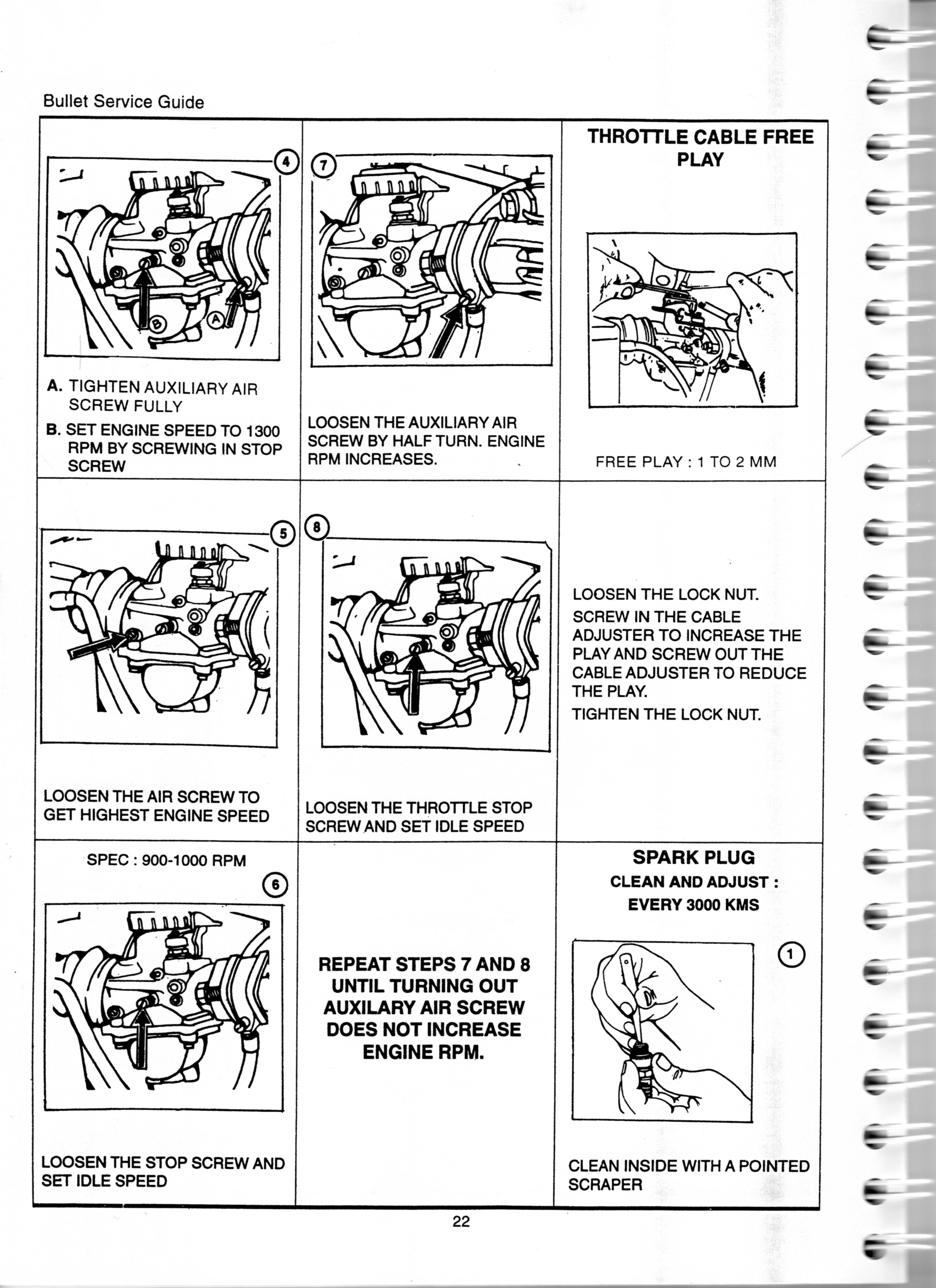

My 350 Bullet Electra has all the spacers but no PAV and from photos of other similar bikes this was how it left the factory. On the thick ally block spacer is (or rather, was) an auxiliary air screw controlling flow via a pipe from the air cleaner housing. It bypasses the carb altogether. I understand this was to allow the idle to be set at high altitude.

Maybe you're thinking of a different setup? The aluminium spacer on my bike has an inlet stub controlled by a needle valve type screw.
As I've said before, there was no PAV on this bike, which is an Indian home market 350 Bullet Electra. Photos of other examples of this particular model show it to be plumbed the same as them.
The clear plastic tube on the inlet stub on the inlet spacer block connector comes directly from the airbox, i.e filtered air. My "Watsonian Squire" workshop manual (issue 3/04, which is the same date as the bike) explains how to set up the idle using what is described as the "auxiliary air valve screw". The text doesn't mention anything about a PAV valve. The diagrams show only the clear plastic tube running directly from the airbox, as per my bike and similarly doesn't show any sort of a valve. The technique to set the idle mixture is to adjust it so that opening the auxiliary air valve screw (which bypasses the carb) doesn't alter the idle speed. Once the auxiliary air "needle" valve is fully closed, it does nothing.
Removal of the spacer tube/block would require shorter fixing studs for the carb, and I see no need to bother because the bike runs very well as it is. :)
