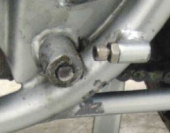

Also, I've found out what should bolt into that hole, yey! If I'm right, a bit of that threaded portion is what I'm working on... -> Image
By Dave the Bass
#88778
stinkwheel wrote:
Mon Mar 30, 2020 8:30 pm
Maybe worth ordering some cycle-thread taps and dies now? I 100% garauntee they will come in handy.
If I succeed I will matey, I shall, I'd have a cause to celebrate and a good reason to buy some :) The nut is 7/16'' X 26TPI says the online parts book.

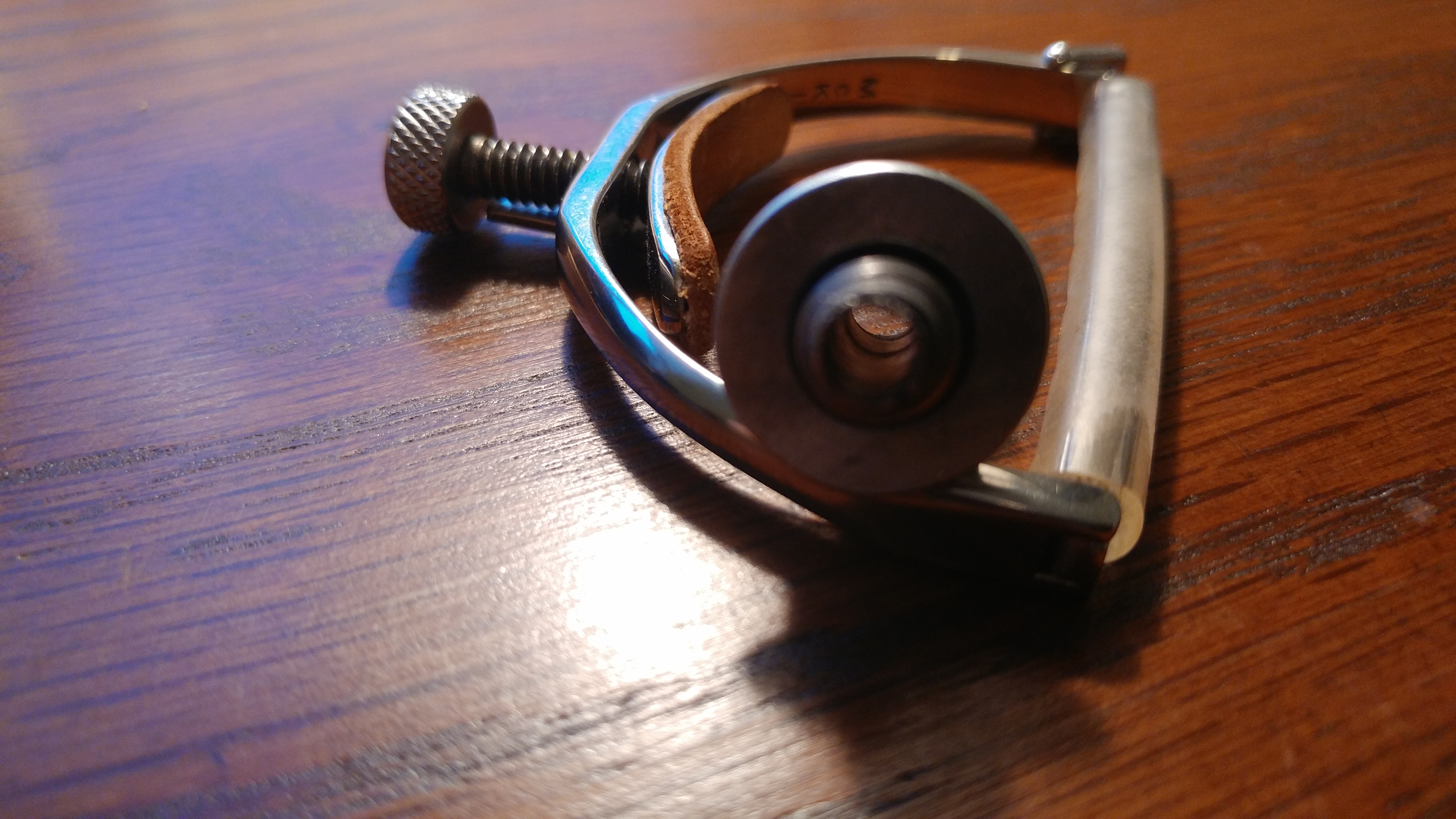

Pic is my first drill guide attempt. As per the above video. M8 Allen bolt, 1.25 thread pitch. Plan on making a few more to have when I eventually break a bolt off and need to use an extractor.

You have my sympathy. The same footrest on my GT was broken in exactly the same way when it was hit by a car whilst parked a while back.
Luckily there was sufficient thread exposed on the nut side to enable the stud to be wound out from that side. It was a pig of a job because the footrest stud had been distorted in the accident – application of a lot of heat was my friend.
I may be misremembering but I think the frame was threaded to accept the footrest? The nut on the other side (along with the star washer) locked it in place. If I’m correct it looks from the images that you may have destroyed the thread in the frame? Not the end of the world and it should not be an insurmountable problem.
I also see you have the typical bend in the upper frame tube!
