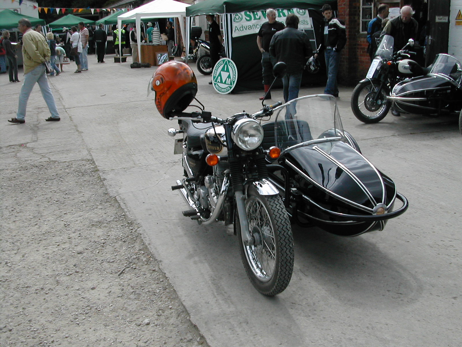

Glad you've got it sorted, David, Bullet Whisperer has posted all sorts of helpful stuff on Youtube.
For hauling a sidecar you will probably need to swap the standard 18T gearbox sprocket for a 16T, or it will struggle. Setting up a sidecar alignment properly is another black art I have studiously avoided.
When Watsonian-Squire were also the official Royal Enfield importers they used to have an Electra-X powered demonstration outfit, one of their staff would take unsuspecting passengers out for a spin on their annual open days. :mrgreen:

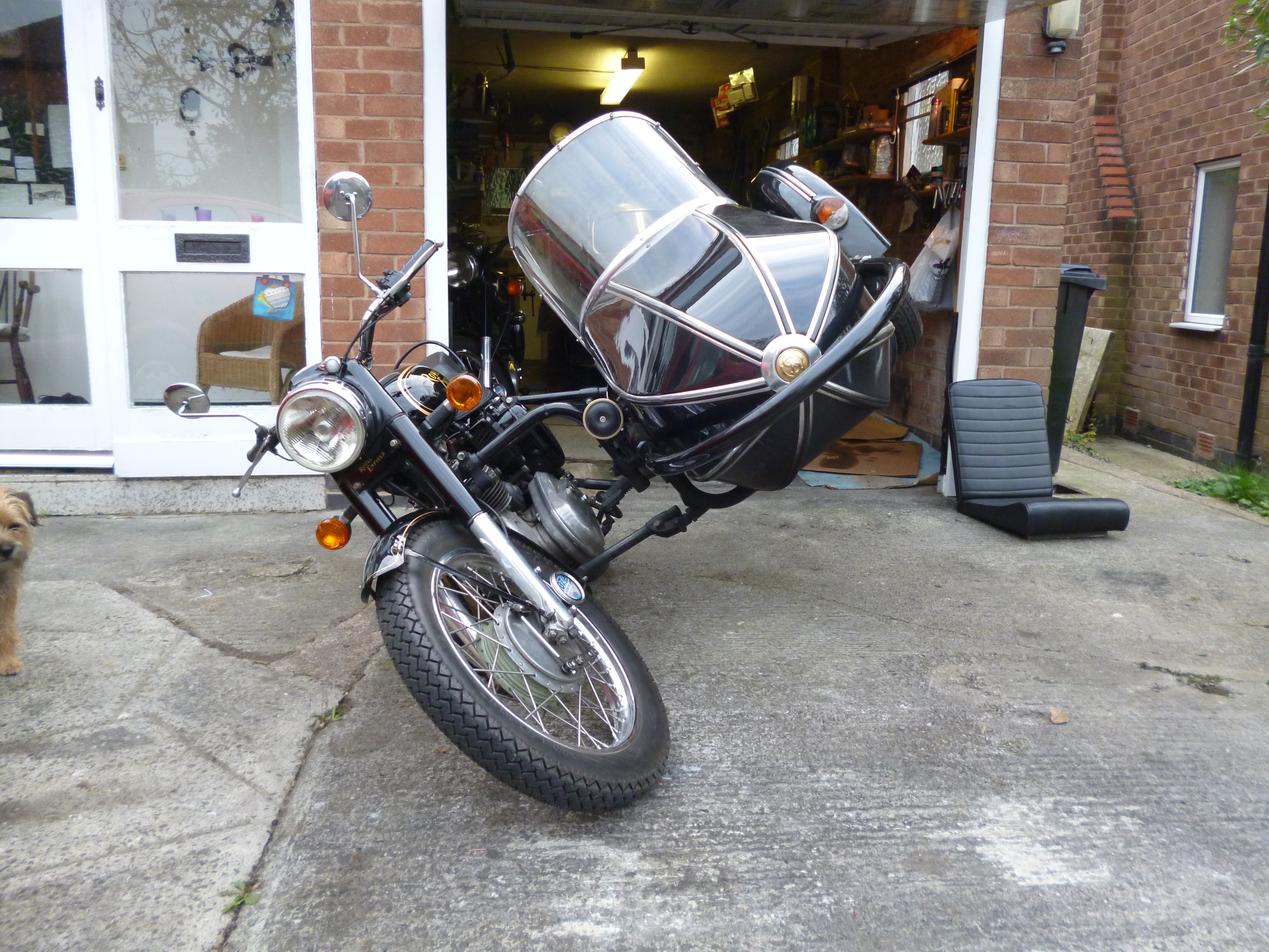

Sheila says I am an old fart too.
(I've had mine since 2007 -new- and it still goes great. The dog jumps straight in, though restrained with a bit of plastic rope just in case he spots a cat, and I can't keep my daughter's kids out of it.)
But I certainly can't add any more to the previous message except to say Enjoy It.
All the best,
Chris
PS You never get there on time; people want to ask about it, so you can never set off....
