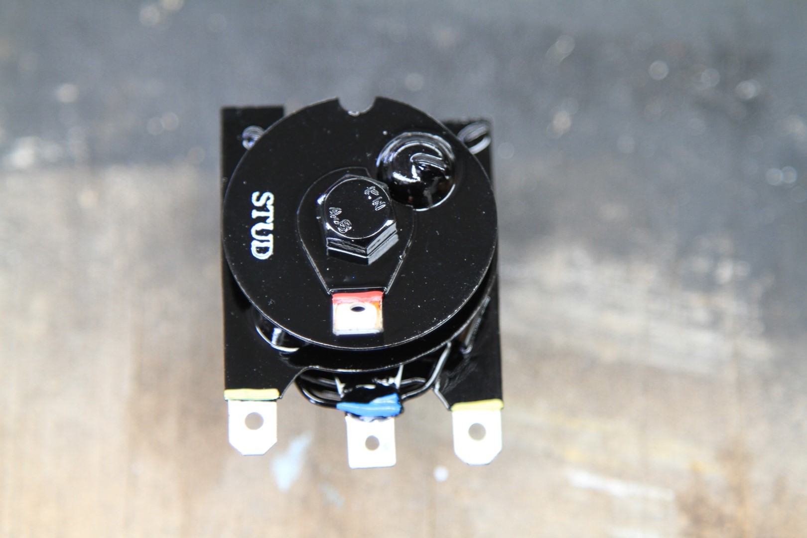

#88786
Hello All, I trust that every body is keeping safe and well.
I am starting to install the loom. Most of it is pretty straight forward, but I do have some questions.
The rectifier recently purchased from our host has 4 connecting points 2 yellow on each side, 1 blue and 1 red.
I have the wiring diagram coloured by "Scalyback" which seems to be the most common on the internet, and an info sheet from Hitchcocks whic show wire sheath colours, type of connector and position on the bike.
The wiring diagram shows 3 positions on the rectifier.
The info sheet shows 4 connections on the rectifier. The wiring loom from our host has 4 wires, one of which is red with a loop connection, saying rectifier positive.
There are no markings on the rectifier to show positive or negative.
Help please.
