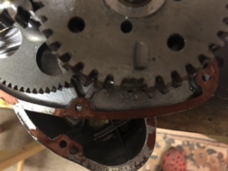

Looks like it has been to the dentist!!!!
#87308
Yes, I also have one like that from my old Electra-X. Whirr-bang-crunch.
