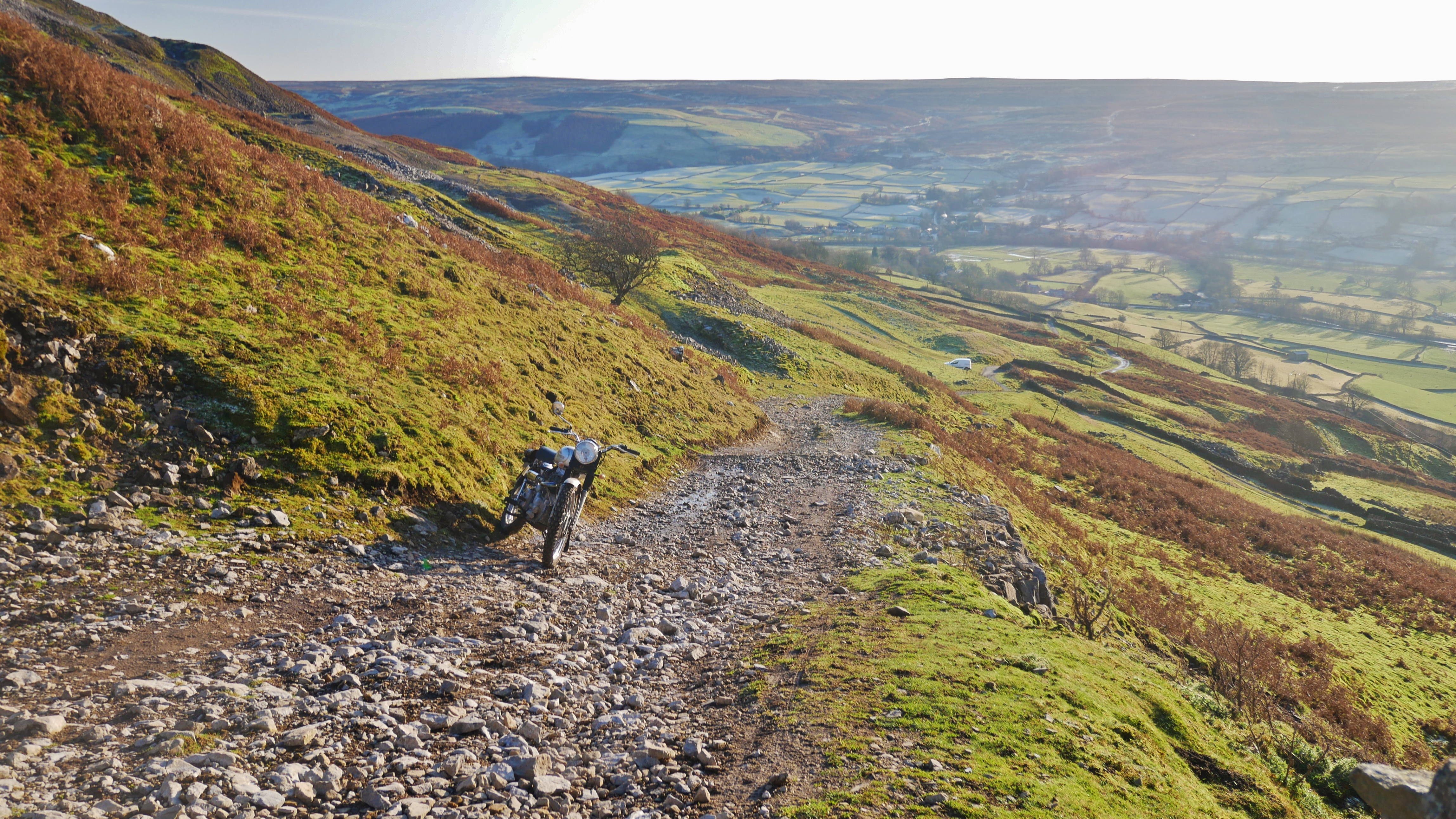

By McMurdo
#86928

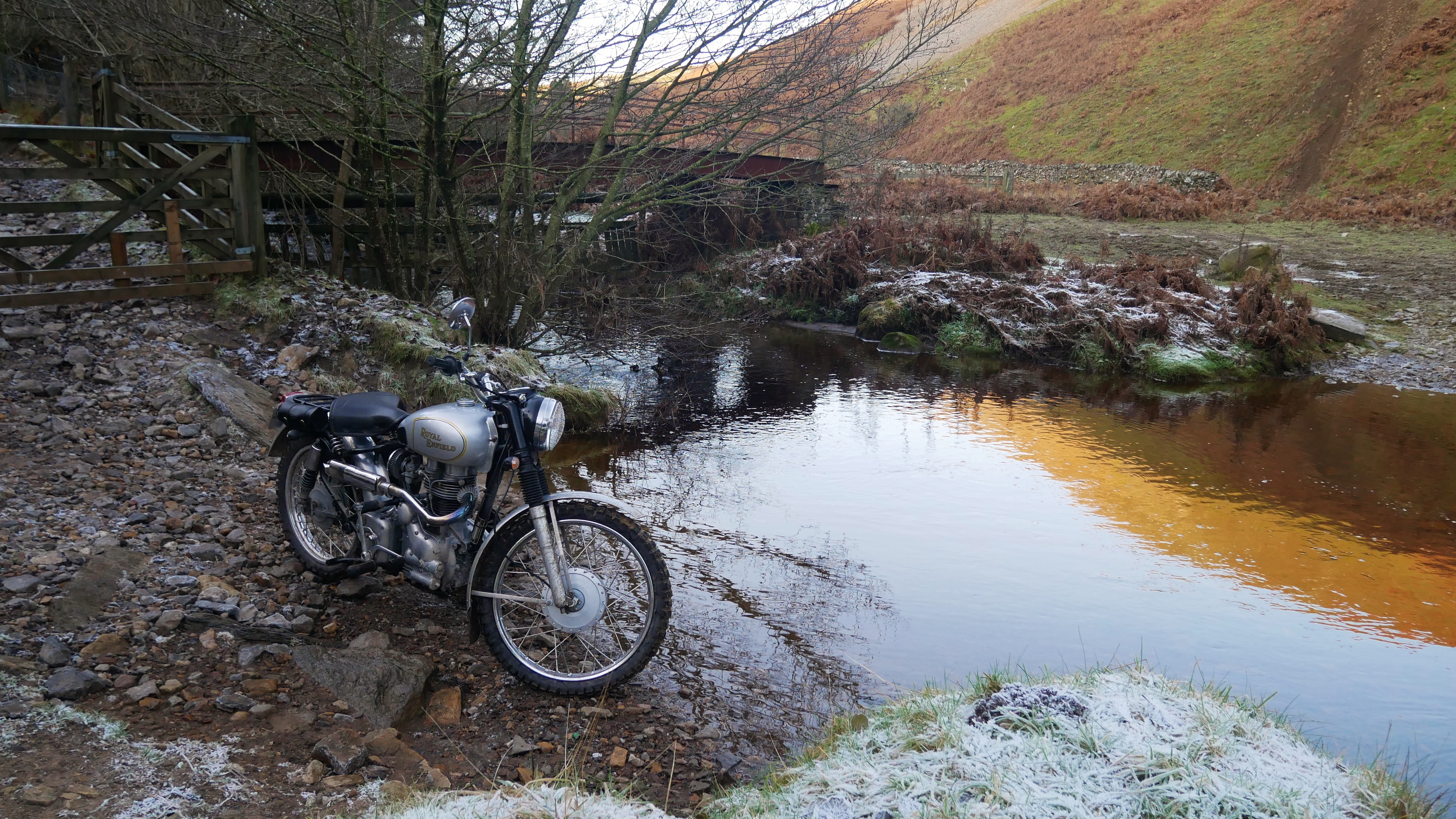

For your further amusement - this is not "off-road" where I live. These are both "unclassified roads"

#86940
Slightly off topic, I saw this picture on the Rock Shocks site, what price a Metisse JAP street scrambler, I wonder?
