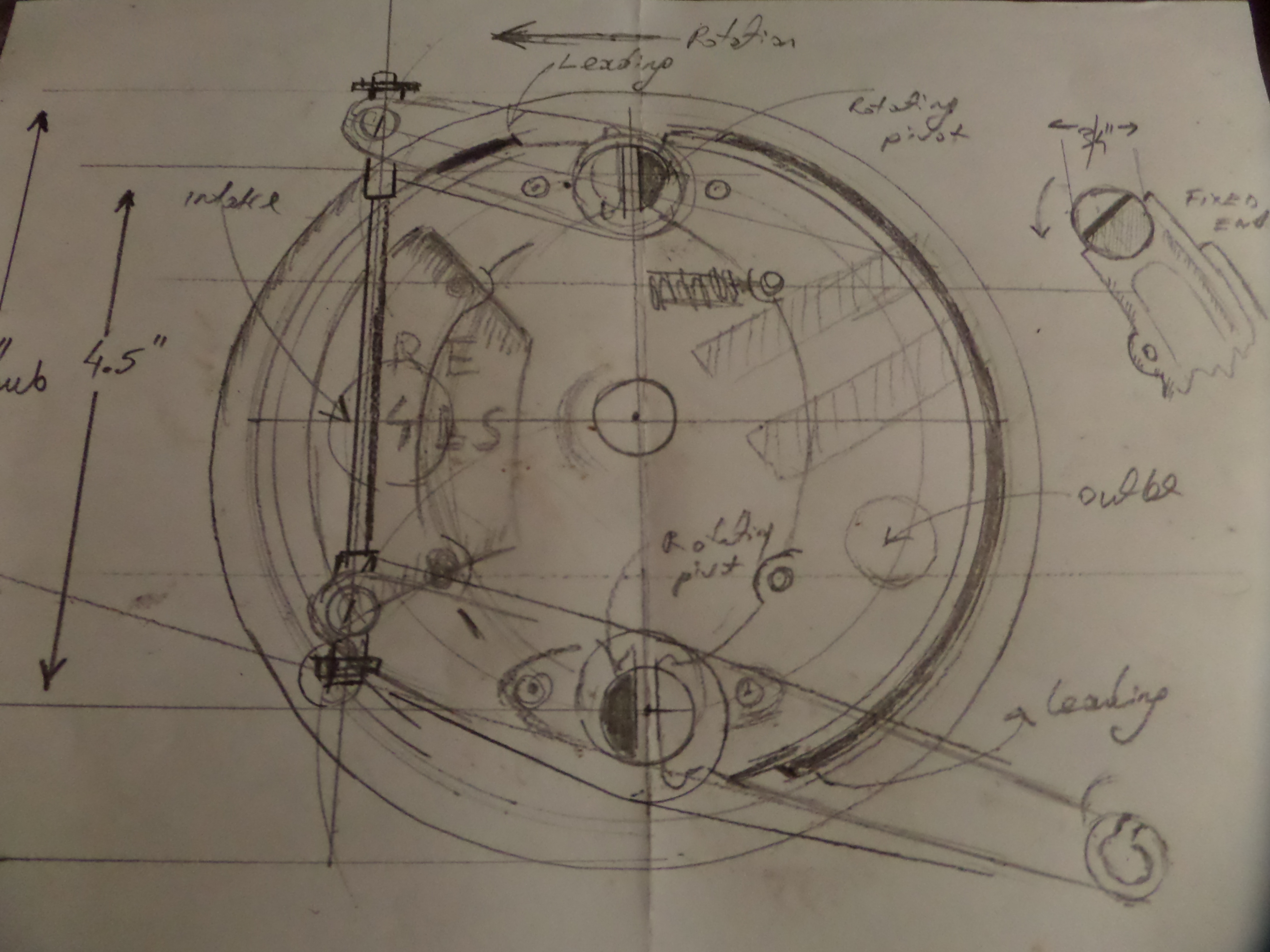

I’d had an idea floating around for quite a while regarding the 6” sls brakes fitted to various Redditch made bikes in the mid 50s to early 60s & how to improve them. The standard brake, the one fitted with the floating brake cam bush, isn’t too bad when correctly set up per the book but I kept thinking there was still room for improvement & I started thinking along the lines of TLS brakes. One thing I wanted to do was to only use RE parts that were available in the 50’s & 60’s. I did a series of drawings & finally ended up with a design using modified RE brake cams where one side of the cam would be filled in (creating a half moon shape) that would act as the new anchor for a brake shoe, the brake anchor itself being replaced with another modified brake cam.

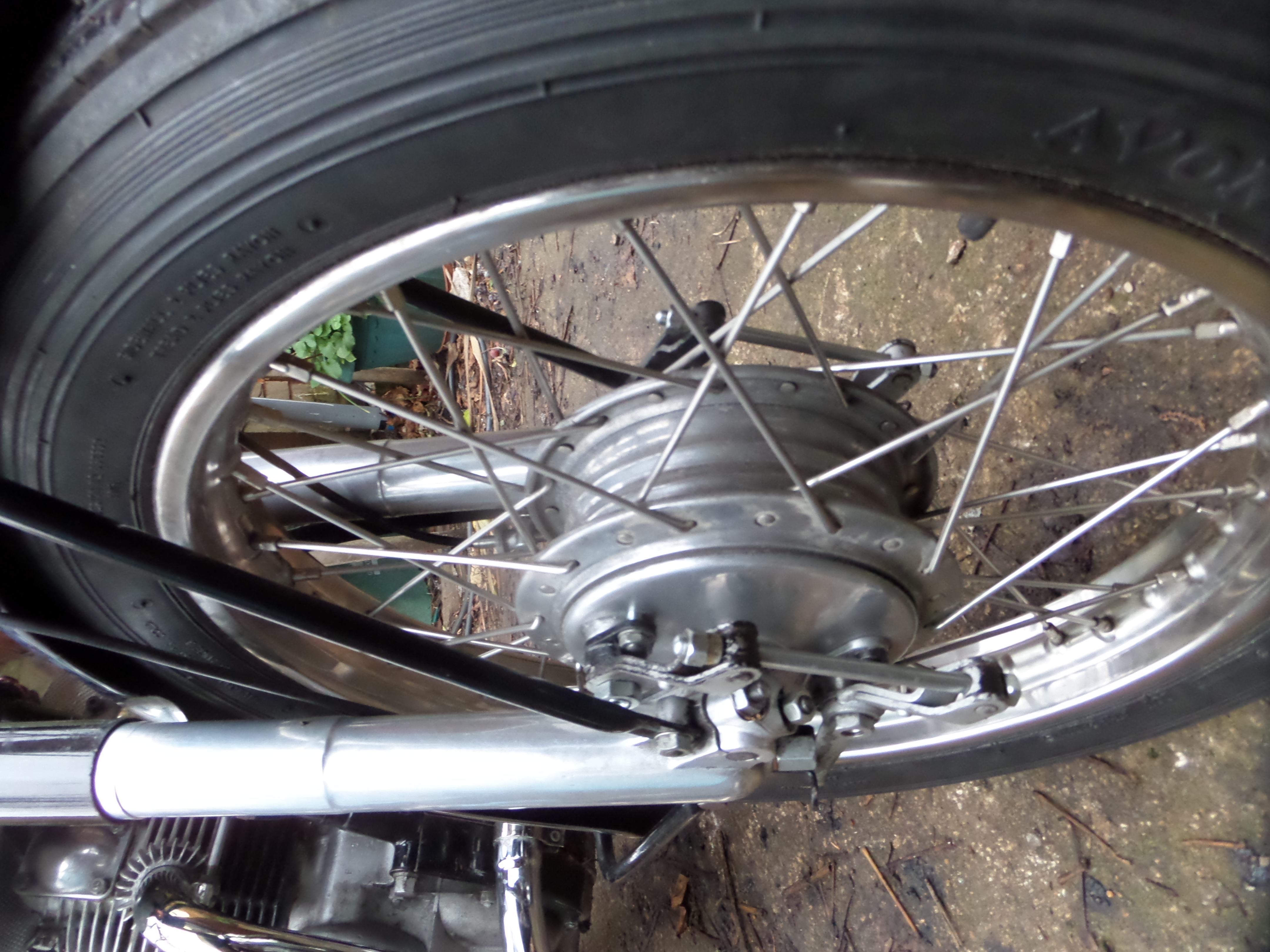

I built the brake (double sided as its on my Constellation) last year & its been on the road now for a few months with excellent results. I shared my information with Allan Hitchcock who replied: “It is great to see projects that work well as so many do not get past the idea stage. Sounds like you have a winner here. May I suggest you write something about it for the Royal Enfield Owners Club maybe even a guide how to do it. There are many owners with the twin brake who need better stopping power.”

I’ve lost the latest correct drawing, the one here is an earlier one & some of the stuff on it is wrong as it was based on a brake cam with a ¾” radius.
Do a good drawing, check things on paper 1st. I made some templates of the parts using card & experimented with these before I cut any metal.

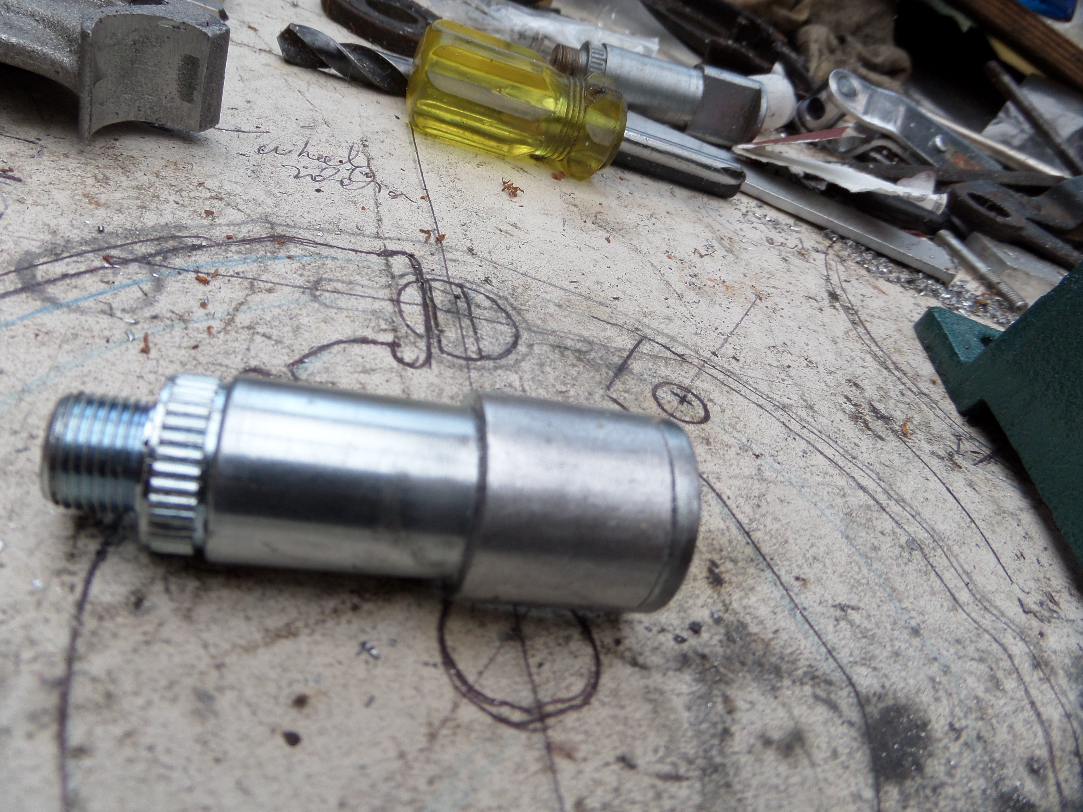

The brake cams
The standard brake cams (part 27067), you’ll need an extra one if converting a brake on a single or 2 for a twin, need to be modified to a “half moon” shape. I used a piece of “dural” cut to fit on one side of the brake cam. The brake cam itself was drilled & countersunk, the piece of dural was then drilled & tapped (m5), loctite was applied to the mating surfaces & then the assembly screwed together using a countersunk screw. I used a file to create the 7/8” radius needed. If you’re doing the job by hand like I did then a set of radius gauges would be handy. If you have a lathe the job can be done in a minute or two.

The hole of the old brake cam housing (part no 26836 Hitchcocks have good 2nd hand ones) should be ok, I removed metal from one side of the part of the bush that goes into the brake plate, I also elongated the holes (for the mounting bolts) either side of the bush. With this mod done the floating cam bush can be moved the required 2mm .
The location for the new floating cam bush needs to be drilled in place of the old anchor location. The hole itself needs to be around 15/16” diam to accept the bush. Don’t forget the centre of the new hole needs to be 2mm away from that of the existing hole! Don’t worry too much about the amount of metal left of the area surrounding the hole for the new bush, if necessary this can be built up using devcon or similar (ally welding if you have it?). As long as the surface is nice & flat for the new bush to be bolted to & that the bush has something to sit on.

When setting the brake up on the bike: its like doing any other TLS brake, only that if you have done a double sided conversion its twice as much work. I found that by doing the bottom brake cam 1st, i.e brake arm applied hard by hand & tons of slack on the slave cam, a helper is great, get rid of the slack in the cable. Then get your helper to push down hard on the slave cams arm, take the slack out off the connecting rod. Both cams (or all 4 cams) should be working in synch now. Some adjustment of the cable adjuster (adjusters) might be needed.
Performance
The double sided brakes on my Constellation since being modified to TLS condition (in effect a 4LS system) are well up to the job & as good as anything ever fitted to a Meriden made Triumph T140. I no longer have to anticipate having to brake. Its possible to come to a nice controlled stop using light hand pressure on the brake lever. Using the brake as before, i.e. gorilla type clenching of the brake lever will produce a squeal from the front tyre & chances are you have just locked or about to lockup the front wheel – be careful. It takes some getting used to, a few days.
Please remember that the drawing i uploaded is an early version & therefore wrong, but youll get an idea from it how the brake works.
