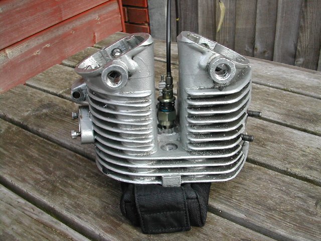

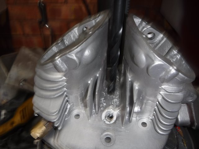

The valve assembly just screws into the head, it has a 14x1.25mm thread - same as a 14mm spark plug (this is why twin-plugging a traditional Bullet head is a fairly easy option). The valve itself just sits in the valve body.
Fitting one to an Electra-X head is a bit of work, you have to remove at least part of the fins between the rocker box parts of the head casting. I use a hacksaw fitted with a tungsten carbide rod-saw blade which let me cut at 90° in a confined space, and tidied up with the carbide burr and a finger sander. I find it easier to remove them completely, but someone with a decent milling machine can just remove only what's needed. After that, drill through the combustion chamber up to the tapping size for the 14mm thread (12.5mm or 1/2"). I also counter-bore the hole from the top to get the valve head sitting more flush with the surface of the combustion chamber, not completely possible with the chamber shape as the hole is drilled vertical. You probably could have it drilled on an angle to sort this, but then you might not have clearance to get a box spanner on the valve
Getting the pilot hole in the right place is important, centre 7mm from the flat edge of the combustion chamber, you don't want the finished hole too close to the valve seats. I also try and tidy up the tapped hole where it has some exposed threads on one side.
The only real machine-shoppy bit of kit I have is the pillar drill. Good hunting!
This was my first attempt, which works very well.

#98499
Adrian wrote:
Wed Oct 06, 2021 11:40 am
All modifications are at you own risk, of course.
Haha, of course!!
Many thanks for the step by step phots, very helpful, job added to list while engine is down again! :lol:
#98507
If you or whoever you get to do the job has put the hole in the right place, you should be able to use a 1/2" x7/16" Whitworth tubular box spanner to fit the valve, you can use this to screw-in the valve with the cable fitted, just slide the cable through the tube of the spanner. Replacing the lower washer on the valve with a plain copper M14 crush washer is a good idea.
You can either use a classic British bike valve lefter lever on the handlebars to operate it, however the original valve lifter plastic lever in the Electra-X left hand switch cluster should do the job, rather more easily than with the original thingy in the tappet cover. Or fit something like this.

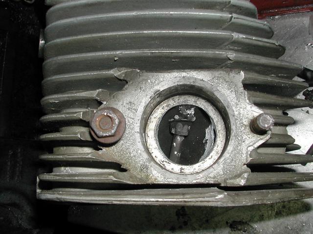

#99004

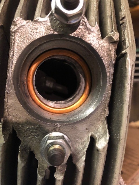

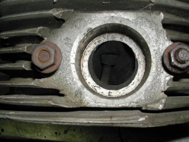

Starting to work on my head (found a box of carbide burs I had forgotten about, reckon from at least 30 years ago!) Looking at the exhaust port it is very off centre (discussed on another post i think) so first job will be cleaning this out and making concentric, meaning it will be no wider than it's narrowest point, this looks ok using the copper ring in the picture.
Just as a sense check the copper ring (looks to be a crush type) is part number 582638/A that according to our hosts website can be used in place of the flat grey washer type of gasket 510804, I have a couple of them in original packaging, are they an improvement over the flat type or would I be better with the flat type?
This will be fitted with one of our hosts open downpipes.
