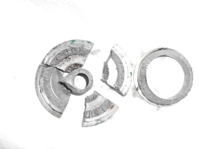

After an oil change on my 2005 Bullet, I noticed oil leaking from the filter housing end cap. I tightened it a bit more, and the result can be seen in the picture, a typical brittle fracture. I didn't think I had overtightened it, but these end caps are obviously a bit fragile.

I've got one just the same.
The o-ring type seem best, new o-ring each time and I swapped out the outer copper washer in favour of a dowty. Then they just need to be nipped up, further tightening wouldn't fix a leak anyway.
#98884
Stainless into alloy is not a good combination, it would gall the edge of the filter housing. Making one out of actual aluminium instead of melted down coke cans and rupees mixed with elephant dung would probably be enough.
#98893
Point taken. Machined from aircraft-spec alloy will do nicely. I'm sure there are suppliers in India who have them in brass if you like that sort of thing.
#98894
Actually, when you look at the grain structure of the fractures there. Re-annealing then heat treating/ageing the metal of a new one would probably work wonders. A couple of cycles of a few hours in a hot over then being allowed to air cool would probably give it a lot more strength and flexability (depending on the zinc content).

Our hosts provided a replacement end cap promptly. I tightened it very carefully, just till the domed nut was nipped up. I was wary of that nut vibrating loose, :shock: however an 80 mile trip yesterday proved to be no problem. I did keep a close eye on it every time I got a chance ! A bit like a car oil filter, just needs to be moderately tight, I think 10 ft/lbs is the figure in the manual.
