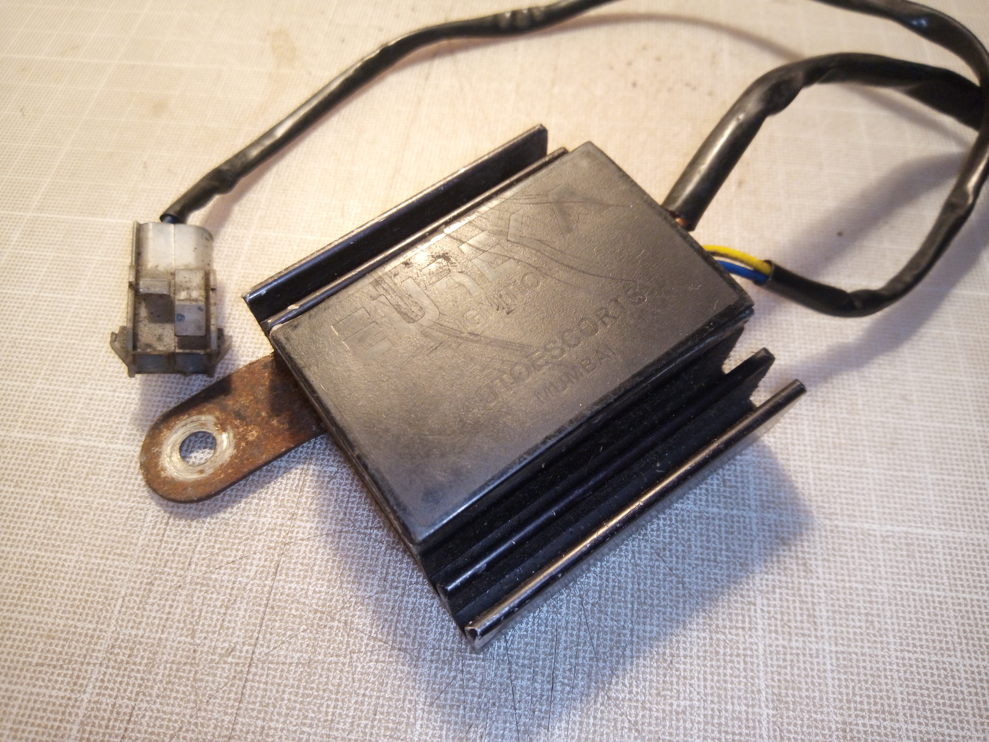

Hi
I have found one of these in a box of bits.
Does it replace the existing Reg/rectifier?
are they reliable?
and can I run the bike without a battery, as with Mr H's Powerbox?
1979 350 Bullet with 2 wire alternator. Its for a Greenlaner with LED head light and tail/stop light- no other lighting
many thanks Mart
By Spudgun
#98787
That's the box of gubbins for the Eureka electronic ignition. I tried that system on my Lightning. Never got the bike to run, so I put the points back.
#98791
They are a basic TCI unit, they do not have an electronic advance curve built in, they're intended to be used with the Bullet's mechanical advance and retard.
